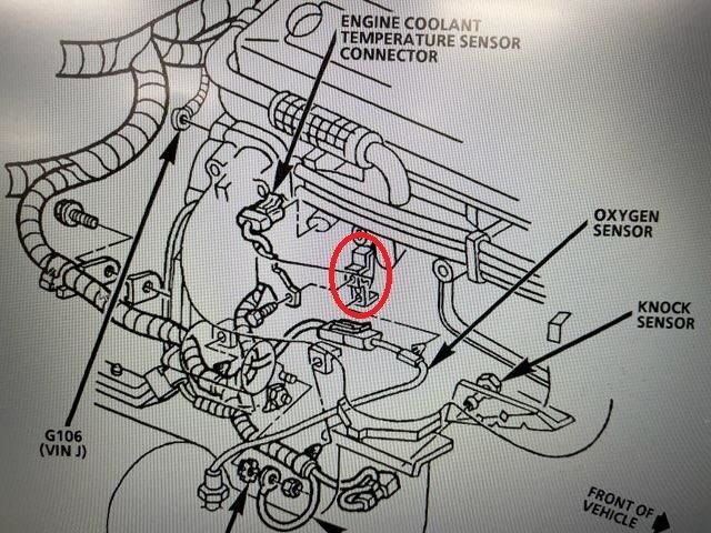

Can anyone tell me where this bracket (red circle in diagram) goes on a '95 (LT-1)? It seems to hold the wiring to the coolant sensor and front O2 sensor on the RH. Despite all the picture I took of this engine before its rebuild, I can't find or figure out where it goes.

On my '96 Firebird Formula, I believe it bolts to a plate that's part of the motor mount on that side, towards the top of the plate at rear....would be about where the front of the starter ends. Not sure if yours is the same👍

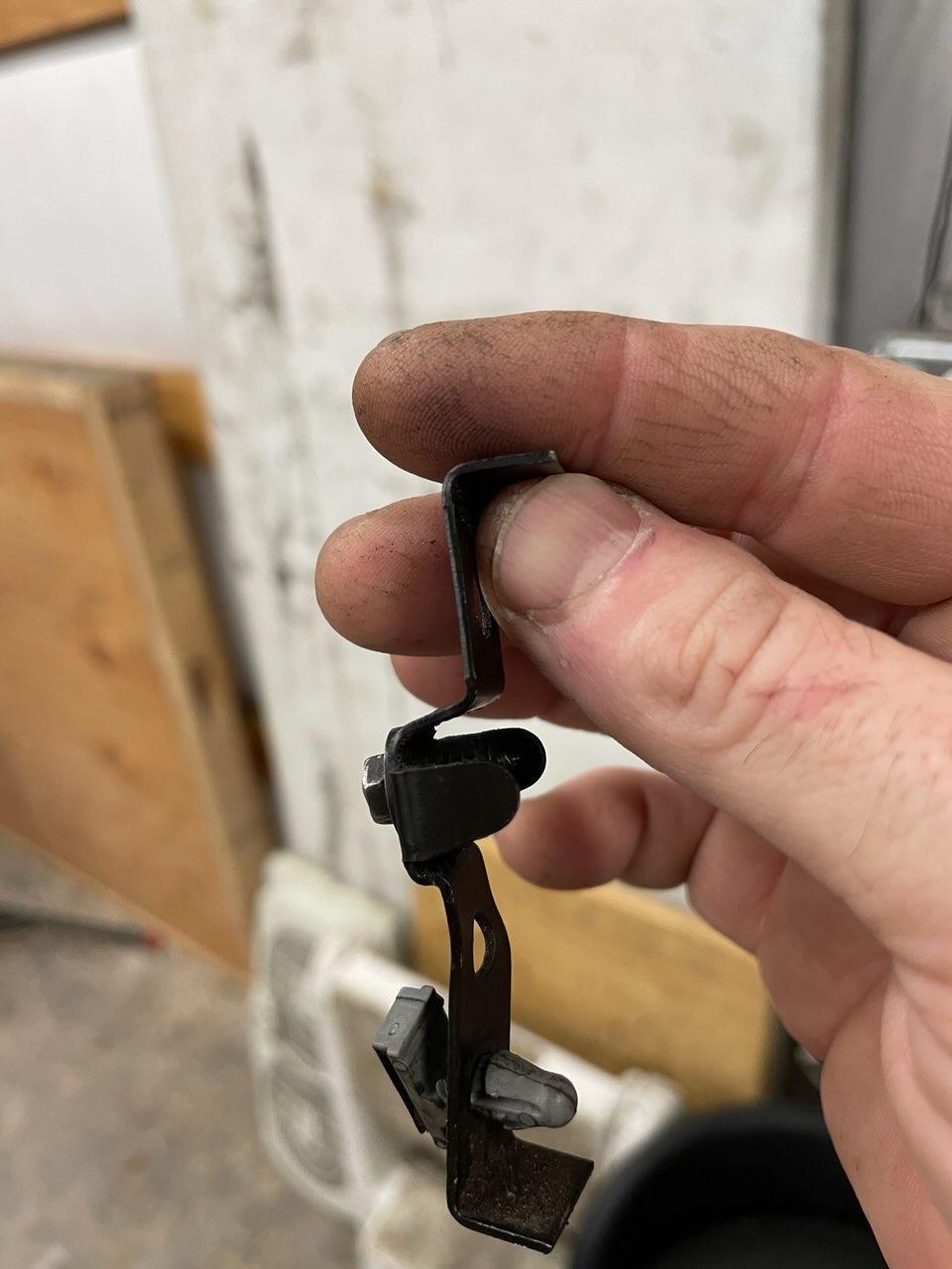

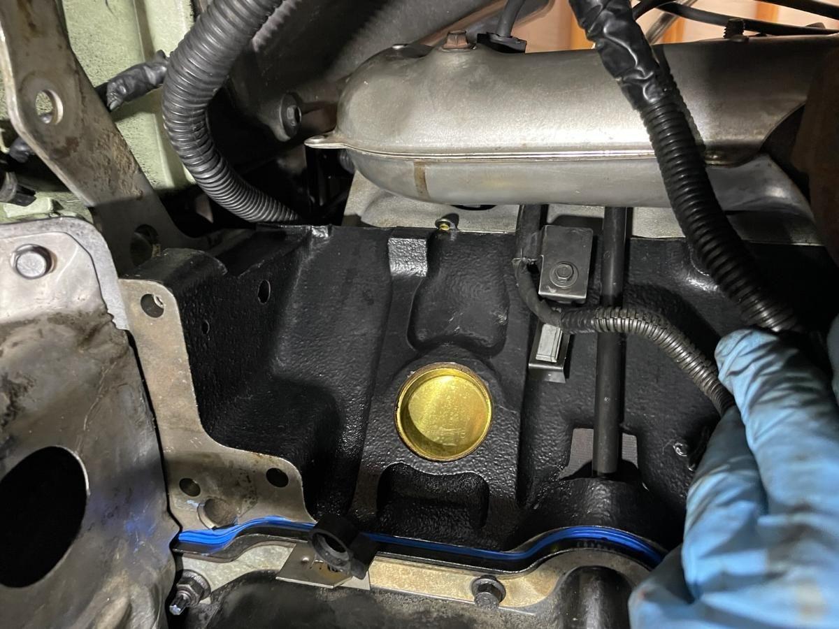

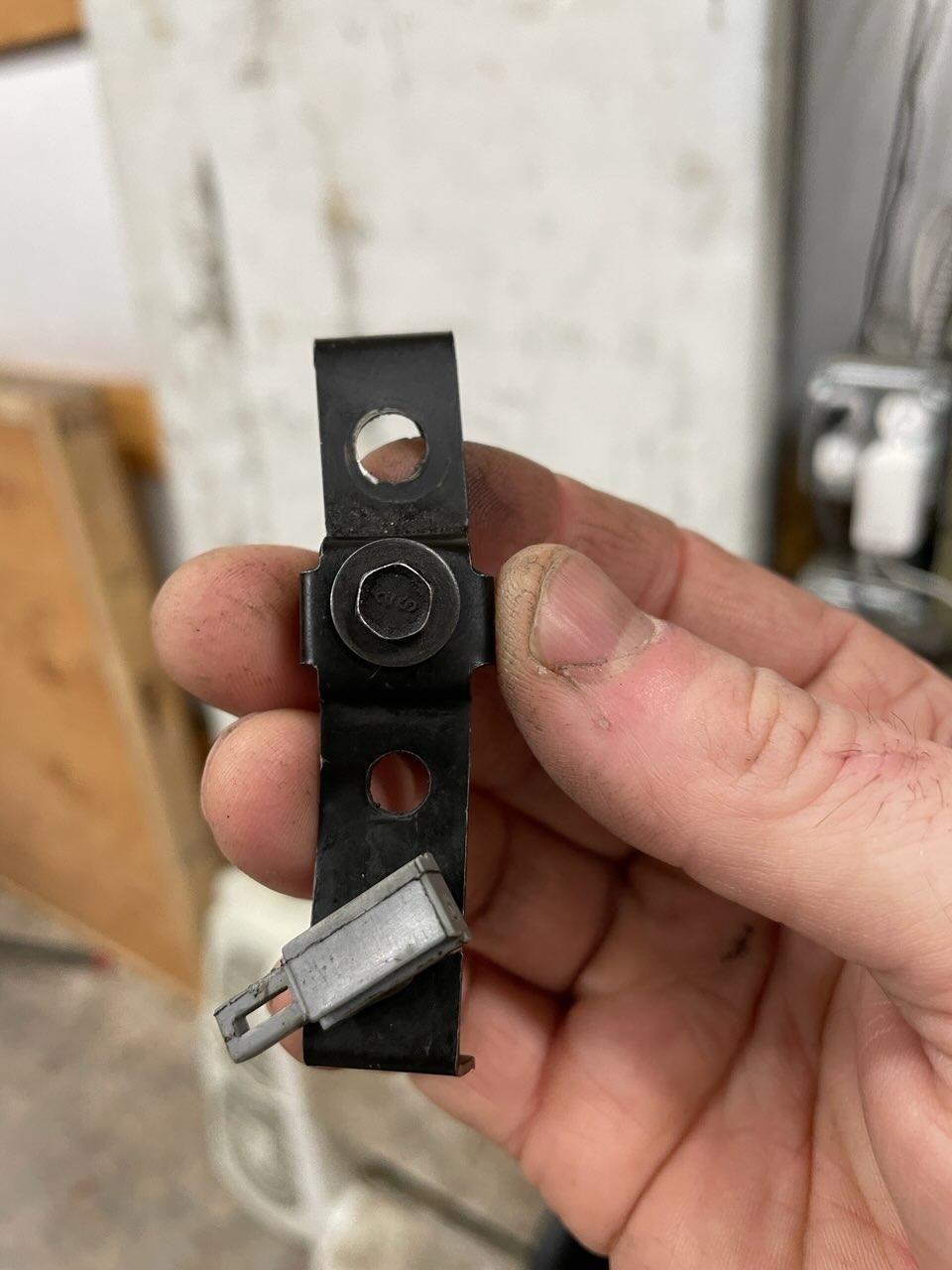

Figured it out. I was tripped up by thinking that the screw that holds the coolant temperature sensor wire should attach the bracket itself. The bracket bolts to the block, coolant wire to raised area on bracket, and the front O2 sensor to the bottom.
