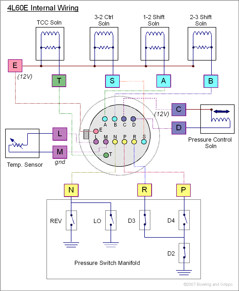

I agree brother. After watching a grueling two hour video on the hydraulics and electrical of a 4L60e. My next plan of attack is the Automatic Transmission Fluid Pressure switch (TPF). Reason being that's where the transmission fails to communicate with the ECM/PCM. Both manually, and while on OD. Any thoughts???

While connected to the computer, the ECM would shift through all the gears on OD, and shift through the gears manually, showing what gear it was on the whole time. But the tranny wasn't physically shifting. For example: You would shift to second, the computer saw second, sent the command to shift to second, and you can feel where it wants to shift into second, but it doesn't shift to second. Even when you tried using the computer to override the ECM's commands to shift. It's as if the valve was opening up just a little. As for codes, there was none present. The tranny shifts into first and reverse just fine, in fact you wouldn't think there was a problem.

Without power from the fuse, or if the large connector on the transmission is disconnected, the transmission vill be in "limp mode". ( No 12V supply to the solenoids.)
From what I read:
* You should get second gear if the stick is in 1 or 2.
* You should get third gear if the stick is in 3 or D.
* You should also have no TCC lock.

All the solenoids click when we over-rided the ecm, and sent the commands via computer. So they’re getting power. You can also have the selector lever on 2, D, OD, and it will still stay on first, no matter what. All connections are good. Power going through it all. But no shifting. But I did however, drive around the block without the fuse. And it did the same thing, but this time with three codes (P0753, P1860, and P1864. When I got home, I cleared the codes, and went around the block to no avail. But at least we tried, right?!
