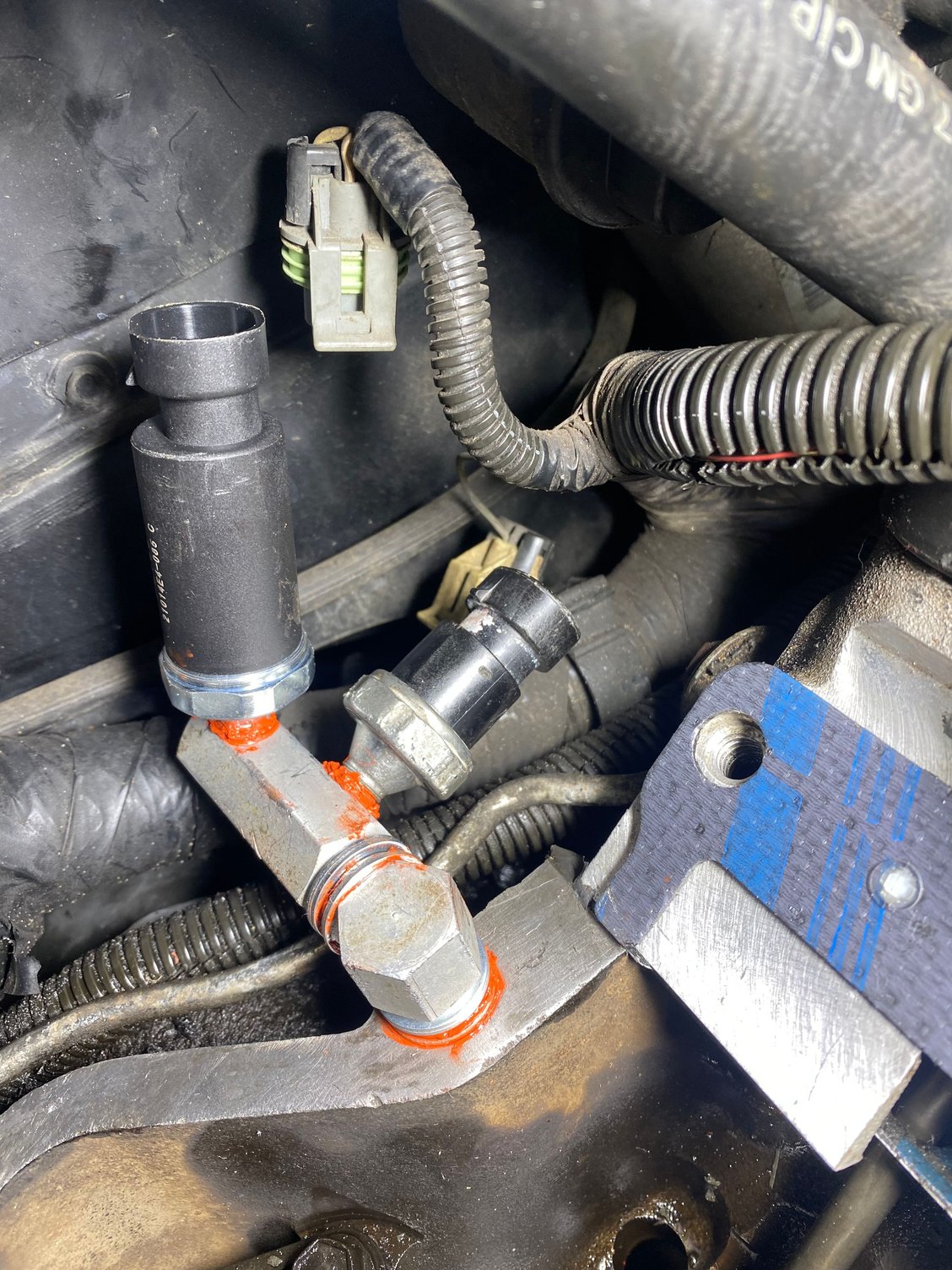

Originally Posted by 85 Z51
Have you checked the oil pressure sending unit? Mine was leaking there.
Curious what you did to correct this. While replacing intake gaskets, I was able to see how loose that whole ridiculous sending unit “tree” of switches had become, and that tightening down was going to point the assembly toward the intake, so it had to remain backed off.
I was hoping to use a low profile nut to lock it down on the block, but realized it was a tapered pipe thread, so it was either stack it with washers to cinch up the threads at the desired orientation, or tap the hole further. I opted for washers and lock washers, and tons of high temp sealant. Same issue with the extension, was turning past its snug-point. More washers and sealant.
Both are now super-locked down, but can be removed if necessary. Of course, the china wall got its share of Right Stuff in that area, since that’s where the sealant looked the most deteriorated.
