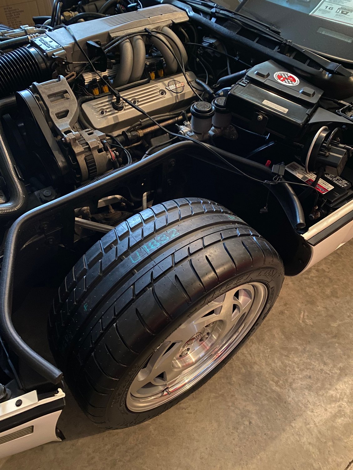

I recently put the Mickey Thompson Street Comps on my 92. I am very happy with them. I'm in Southern California and haven't driven them in the rain, so I can't comment on that. For cold 60 degree days to hot 100s they have been great. Plus I like having an old traditional hot rod brand tire. From what I read Cooper tire bought MT and then Goodyear bought Cooper but both left the design and formula alone.
