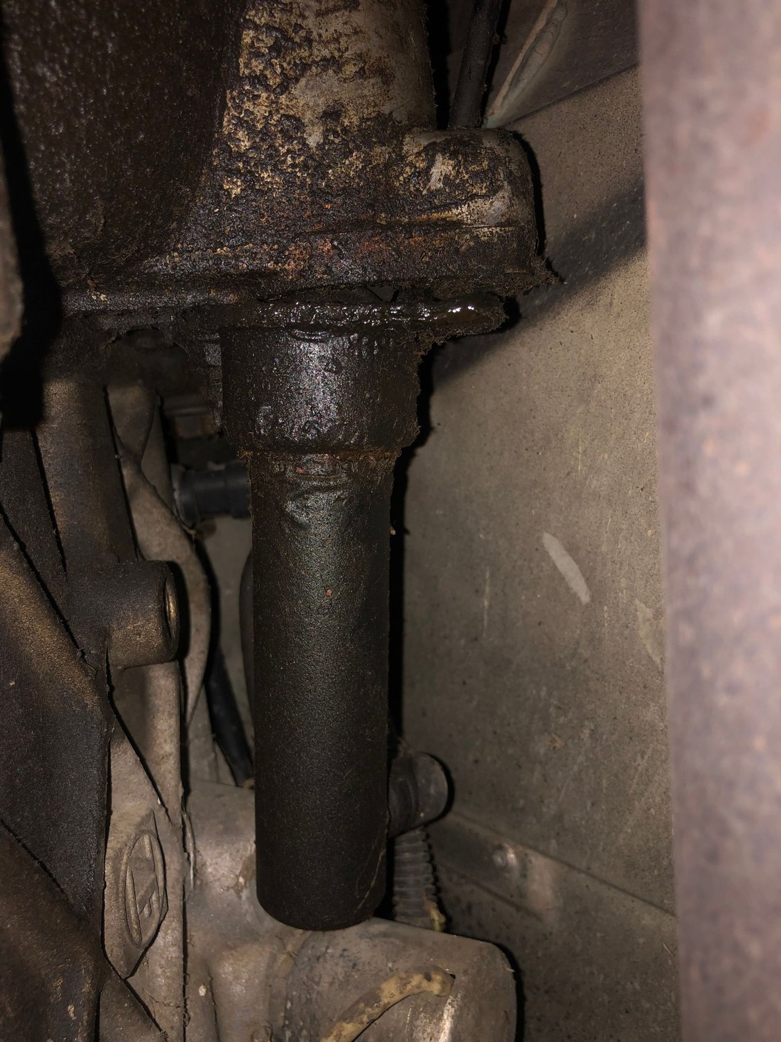

It appears that my slave cylinder & master cylinder are original to the 89 vette. I’ve read the FSM process but can anyone add to this since I’ve not done it before? Are there tips & tricks?

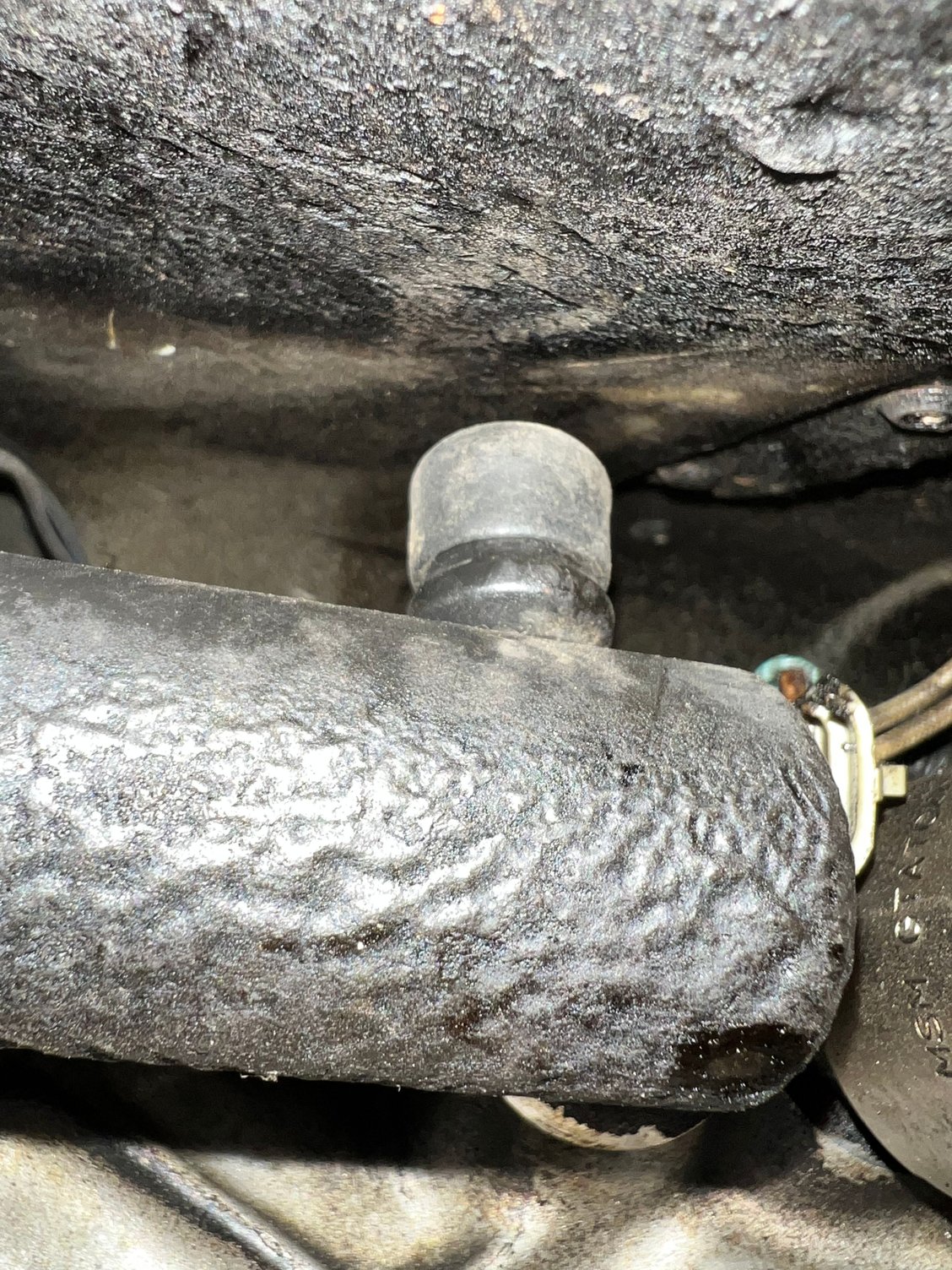

No nipple just the cap & when that’s off it’s a flat top. (Don’t ask me why but the original owner had it undercoated!)

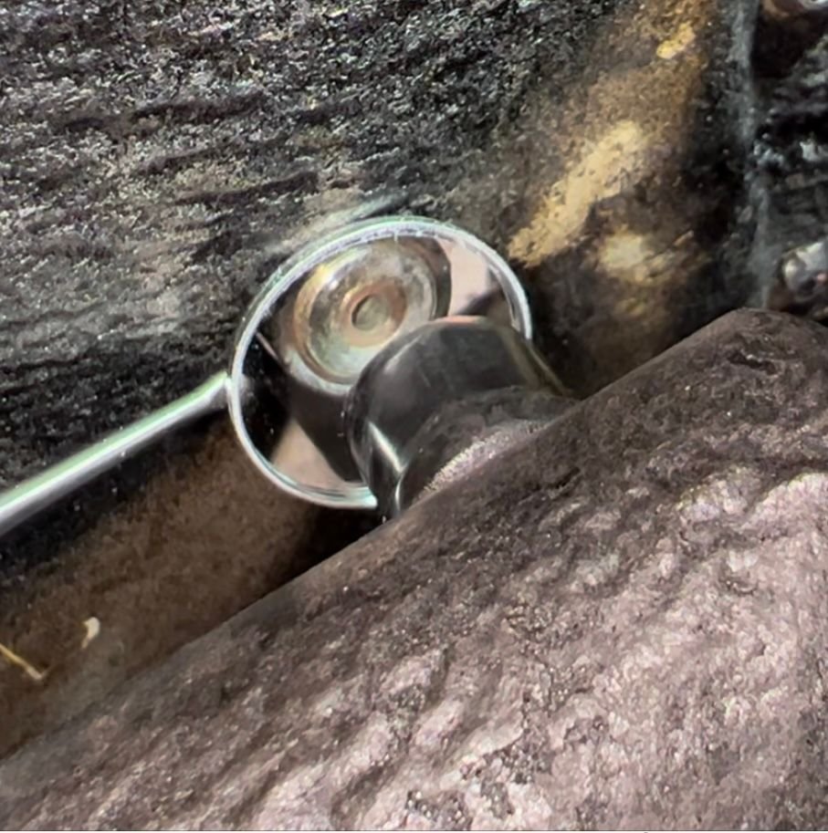

op u should have a bleeder like this :

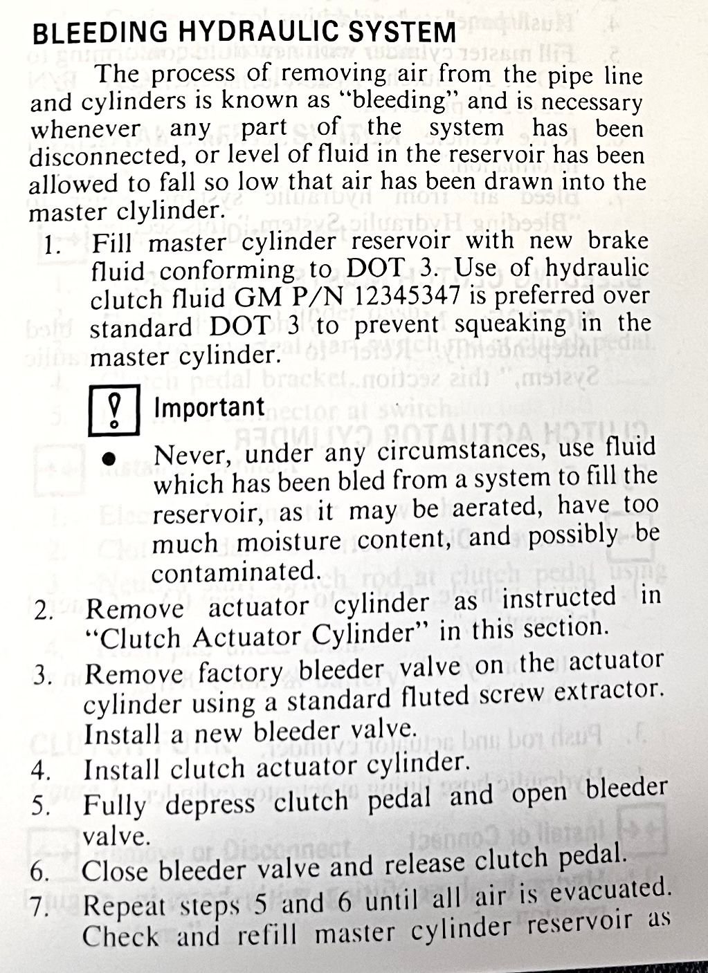

I’m pretty sure it doesn’t come with a bleeder screw attached. At least that’s my interpretation from the FSM where they talk about using a screw extractor;

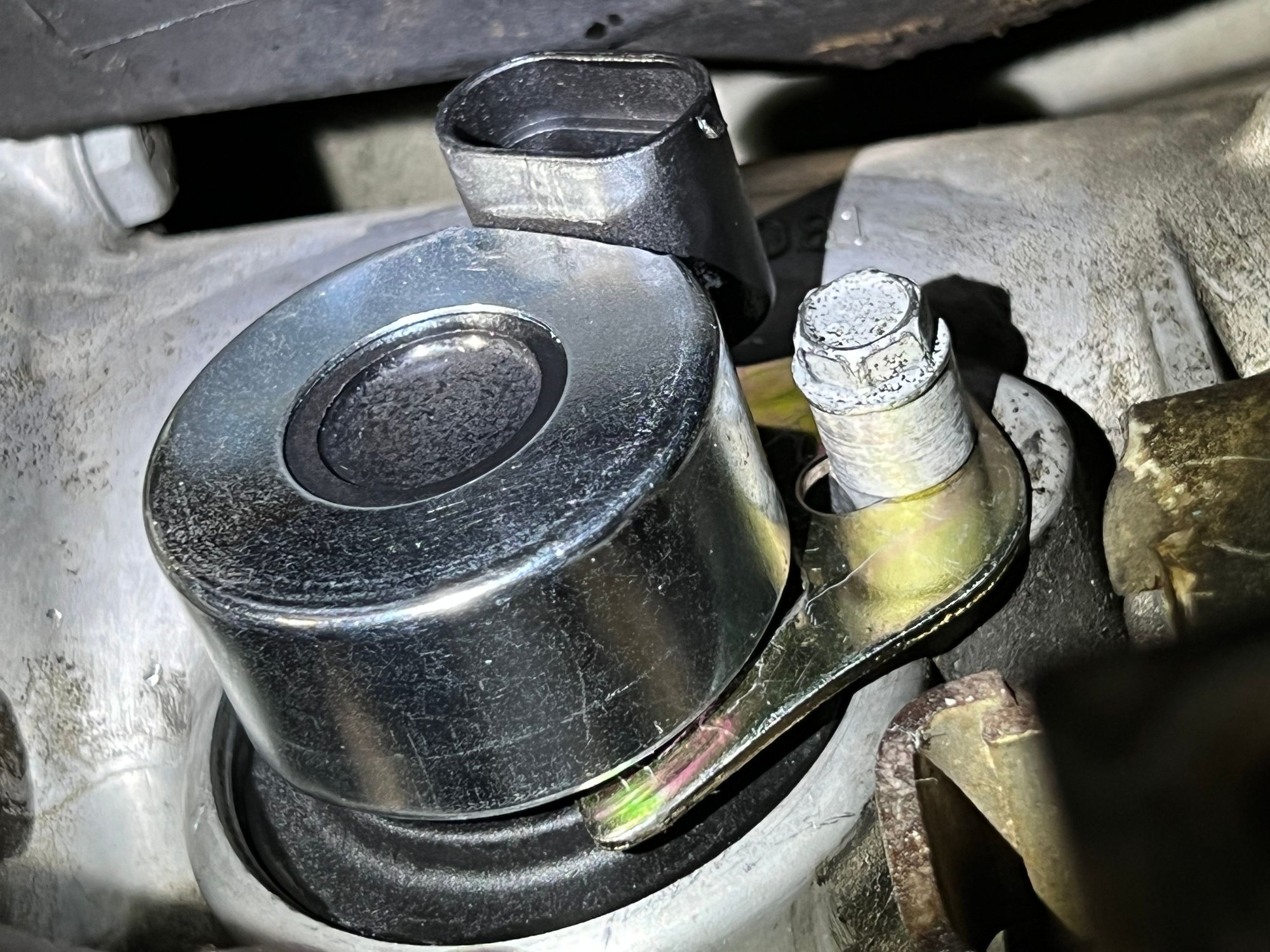

I’ve not seen the other end of the slave cylinder. What’s it look like? Is there any issues putting it back in place after removal? If not I’ll have to pull it & see if I can put some kinda of an extractor tool in to remove it then get a nipple that will fit or weld a nut on the end…. Something different than what’s there.
Old Jun 21, 2022 | 09:42 PM
VikingTrad3r's Avatar
VikingTrad3r
Oil Producer
Joined: Apr 2014
Posts: 9,371
Likes: 2,736
So I have an 89 project car on my Lyft right now. Went out to look at the slave cylinder. I knew it was missing a stud, but low and behold it looks like it’s the same as yours. So I guess I’m along for the ride to see what you do! My 1990 and my 1991 all have bleeder screws.

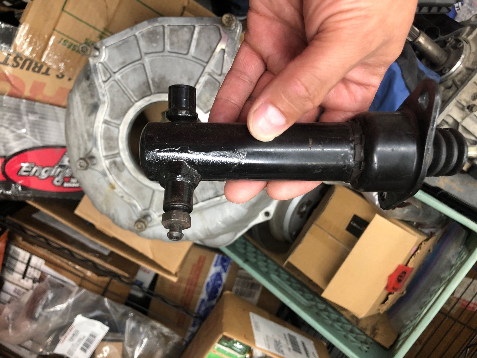

Tom, is yours the same as my original unit? If it is it makes me wonder why mine doesn’t work with the ranger method as I tried it twice? It definitely concerns me as well. I will have to get a set (master & slave) ordered up & just replace them both very soon. I definitely don’t want my old slave or master to be malfunctioning & causing problems.

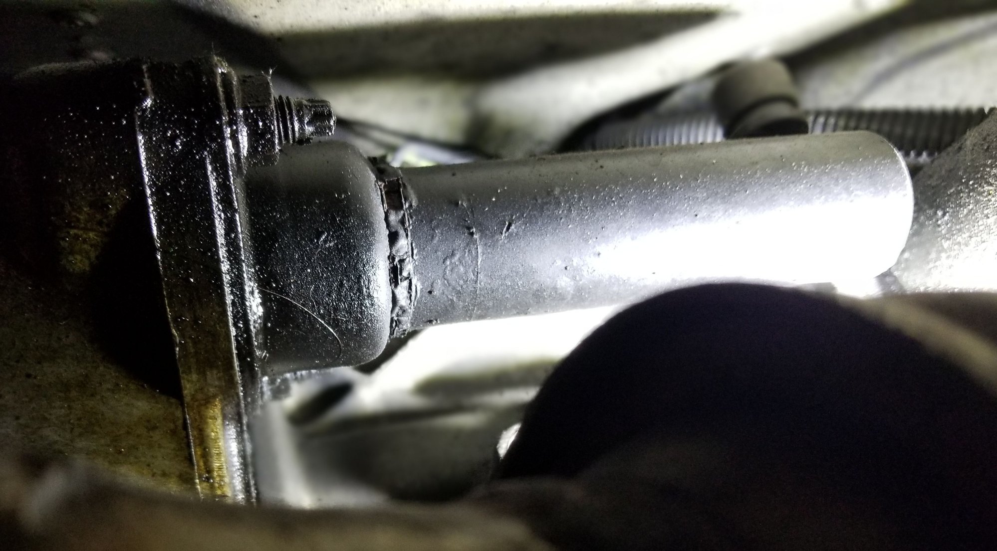

I can take a pic when I get home tonight and post it up.

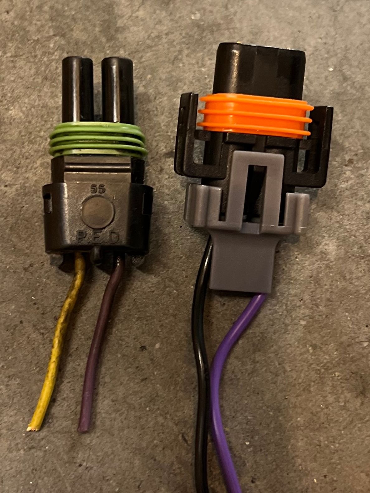

New 1992 Vehicle Speed Sensor,
Seems to fit properly.
Old pigtail on left, new on right. I cut off the old one & soldered the new one on; purple wires together then yellow & black together.

'89 slave...
