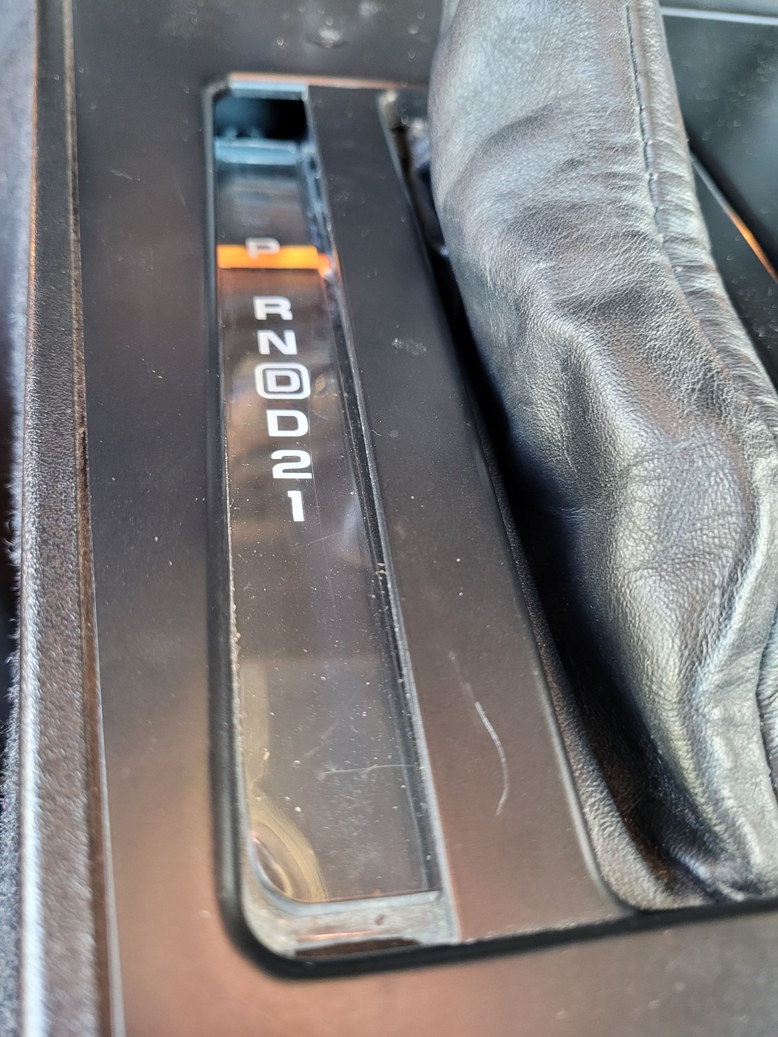

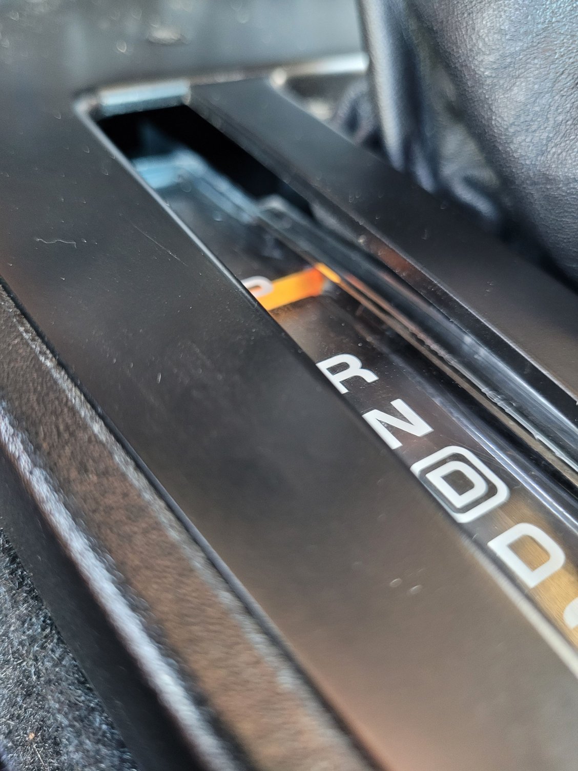

Gear shift indicator came loose, not sure what it's secured with or hiw to fix it... help?

you'll have to take console off and see what came loose. Secures from the back

Over the years I have seen a couple of things that cause that. one the screw loosened second the tab that holds said screw snaps off cover, either way its a tighten or a glue back
