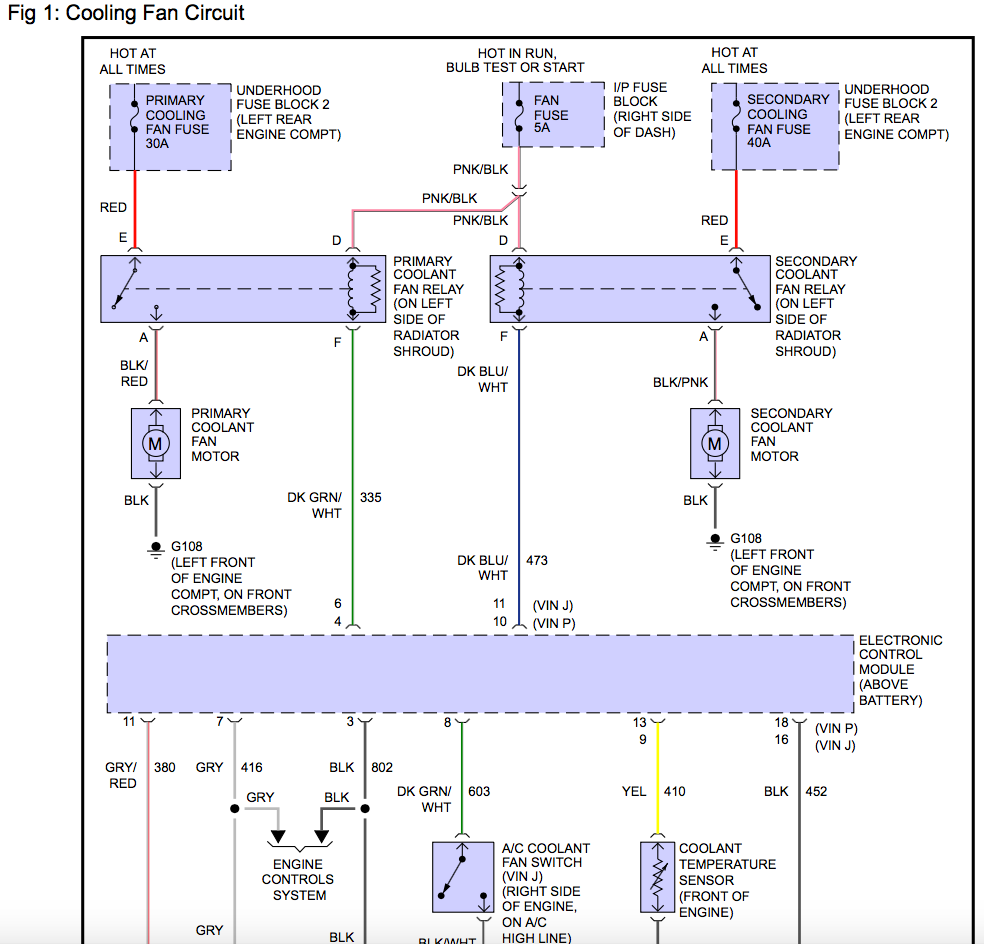

Last question , can anyone explain or post a schematic of the cooling fan circuit? It really kinda sucks having to turn on the AC while stuck in traffic in February.'

Here is the important part (what I could fit in my screen shot) of the wiring diagram....
