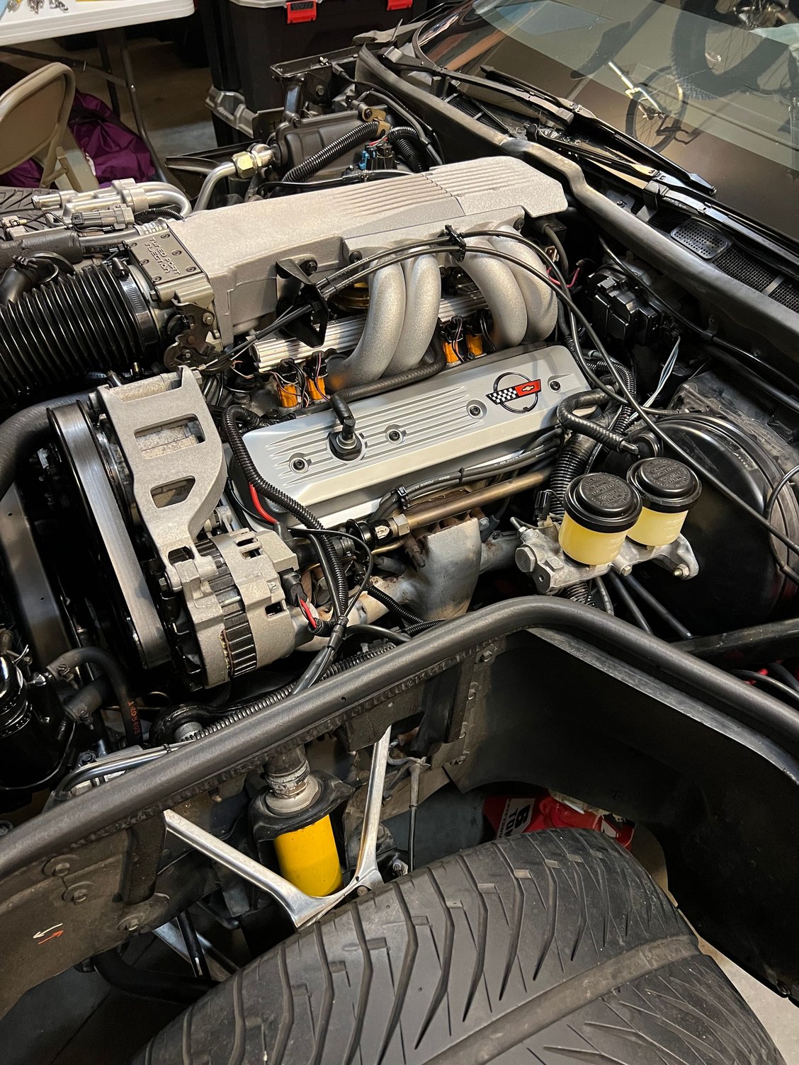

I’ve installed Bosch 3 fuel injectors, the TPIS Super L98 Camshaft with new springs, a set of 1.6 full roller rockers & new timing chain set. I’m using the stock TPI setup so I ported/polished & gasket matched everything from behind the throttle body into the heads an inch or 2. I spent a bunch of time on the base & in the end it all aligned beautifully.

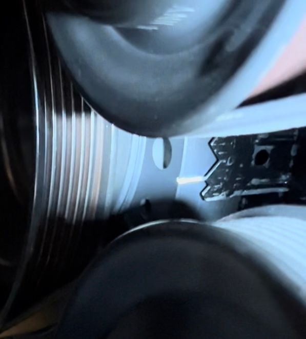

This is what my timing was before I set it to 7 advanced;
The change in performance was truly shocking with the change in timing. I could barely believe that just the change in timing made that much of a difference!

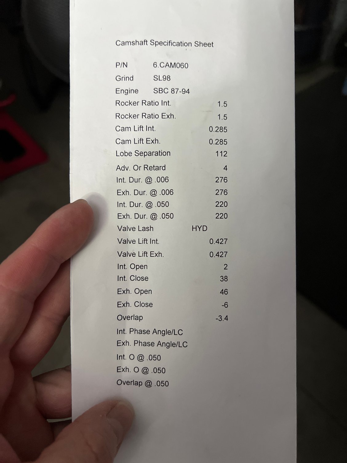

Below is the cam card that came with the cam. In case I misspoke earlier, I’m running the stock TPI intake setup nothing aftermarket.
