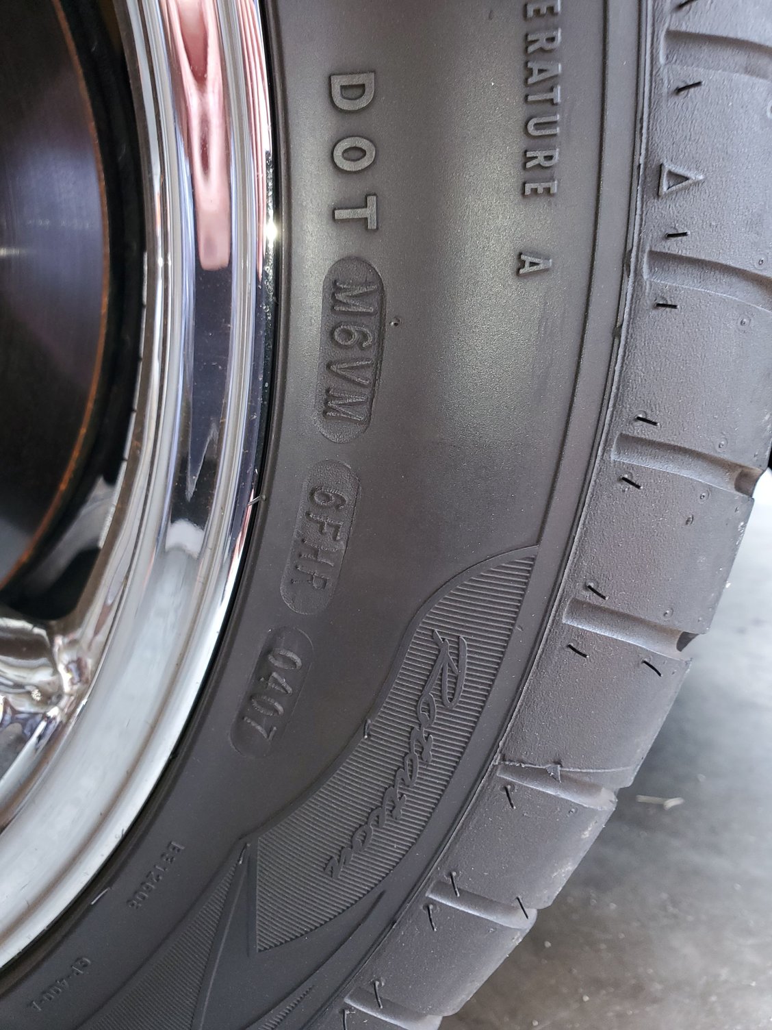

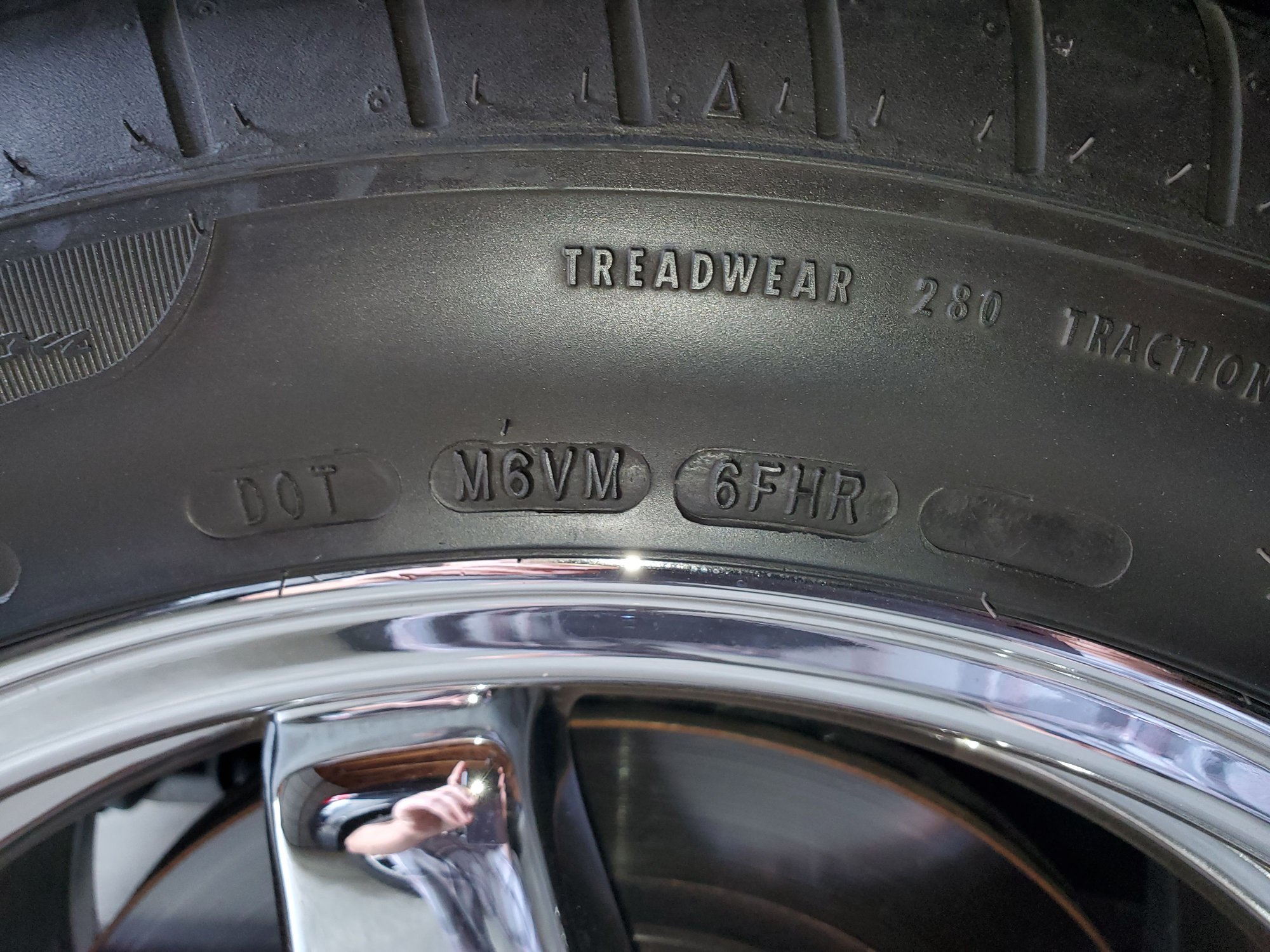

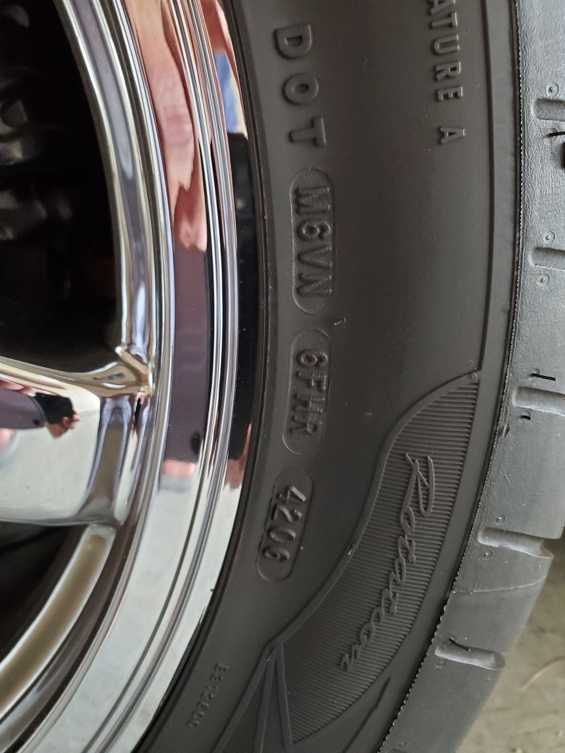

Thanks for bringing the tire age to my attention.
Are these tires really from 2006 and 2007?
I can't even get a date on two of them.

Bingo. Don't do *anything* else. Buy new tires and buy them now!
If you want an affordable alternative, Riken Raptors are inexpensive but are great! You can be all in/installed for ~$500 and they will be significantly better and safer than what you have. I have this setup on mine.
I went with 275/40R17 for my rears and 245/45R17 for the front... if you have an "all square" 9.5" rim setup, it would be the 275s all around.

Originally Posted by rremesal
Thanks a lot for the suggestions.
The current tires are Goodyear Eagle F1 and are practically new.... Wear wise.🙄
I guess new is relative.
Ric
No matter how high quality the tires were nor how many miles are on them, unfortunately they degrade over time and become "hard". This can also be a dangerous situation where it will break loose on you unexpectedly, or you can "blow" a tire. They also heat up more when they are like this. Part of the reputation of torquey rear wheel drive sports cars (Viper ::cough:: ) are due to driving on old rubber because there was "plenty of tread left" but they were > 10 years old.
Get some new rubber on there and I bet you will be pleasantly surprised by the change.
