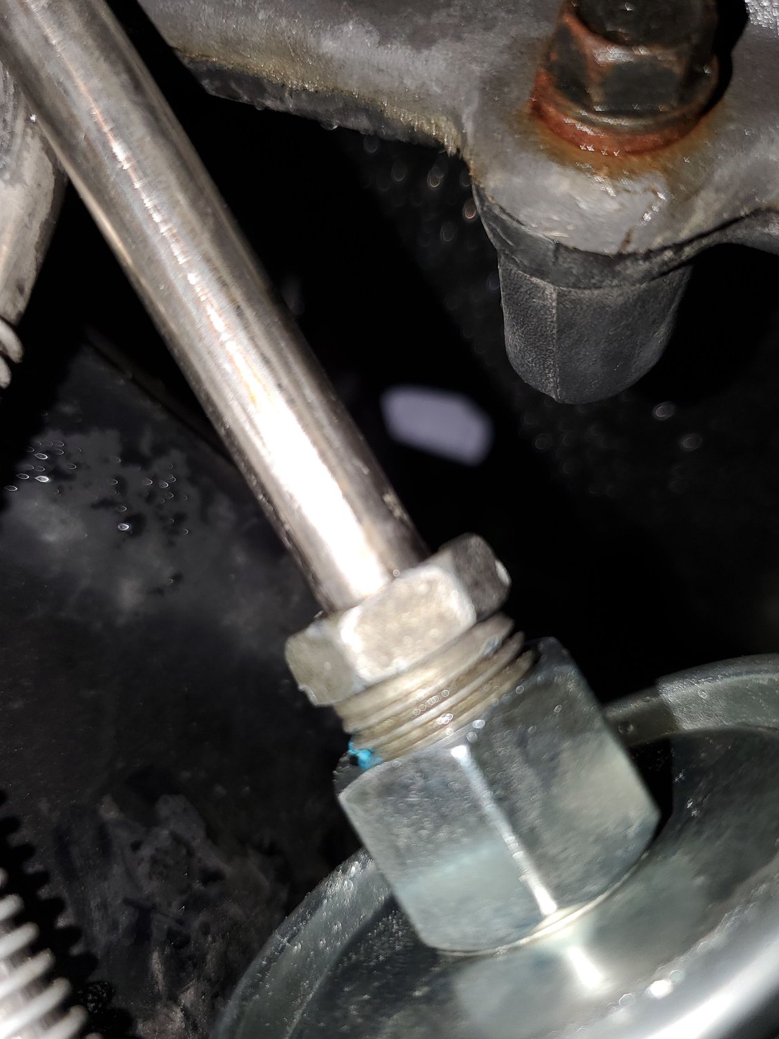

- I took a picture of the engine-side threads, and they look good and in place

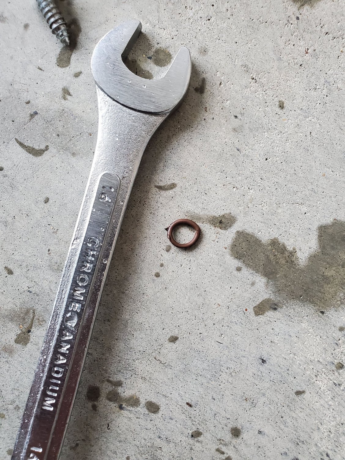

- However, I did find an o-ring on the floor. I assume it came from one the the lines?
Any ideas what I need to do here?

..... You need to put new O-rings on both ends of the filter pipes ... O-rings are not included with new fuel filters ... its best to use the brown ones as they are for fuel systems and are made of Viton rubber ... you can find them in assortment packs in the "Help" section of your local chain auto parts store ... they won't have a listing for fuel filter O-rings because the O-ring is part of the hard line assembly .....

As the others have said, new o-rings. It doesn’t matter how tight you make it it will leak, the o-rings are the sealer (it’s not a tapered/compression fitting seal). I forget what the fitting/seal name is but I’m sure someone here knows.

It's the o-ring. Same exact scenario happened to me. The o-ring flew off somehow. I put it back and that solved the leak.
