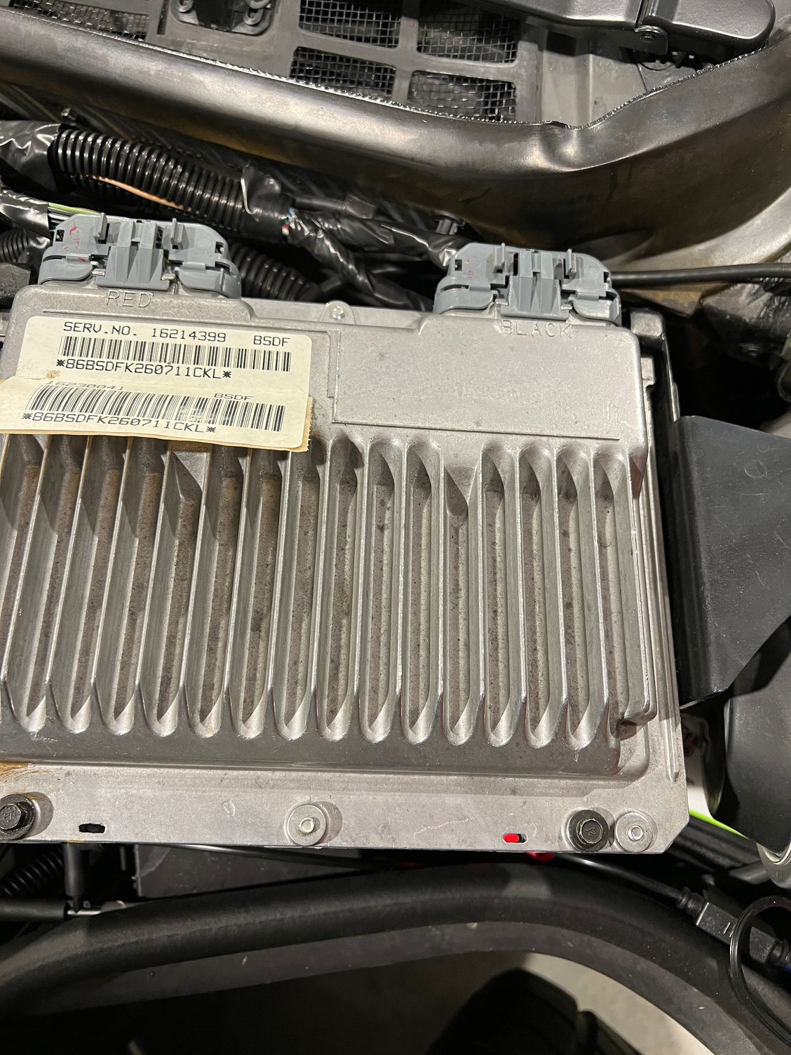

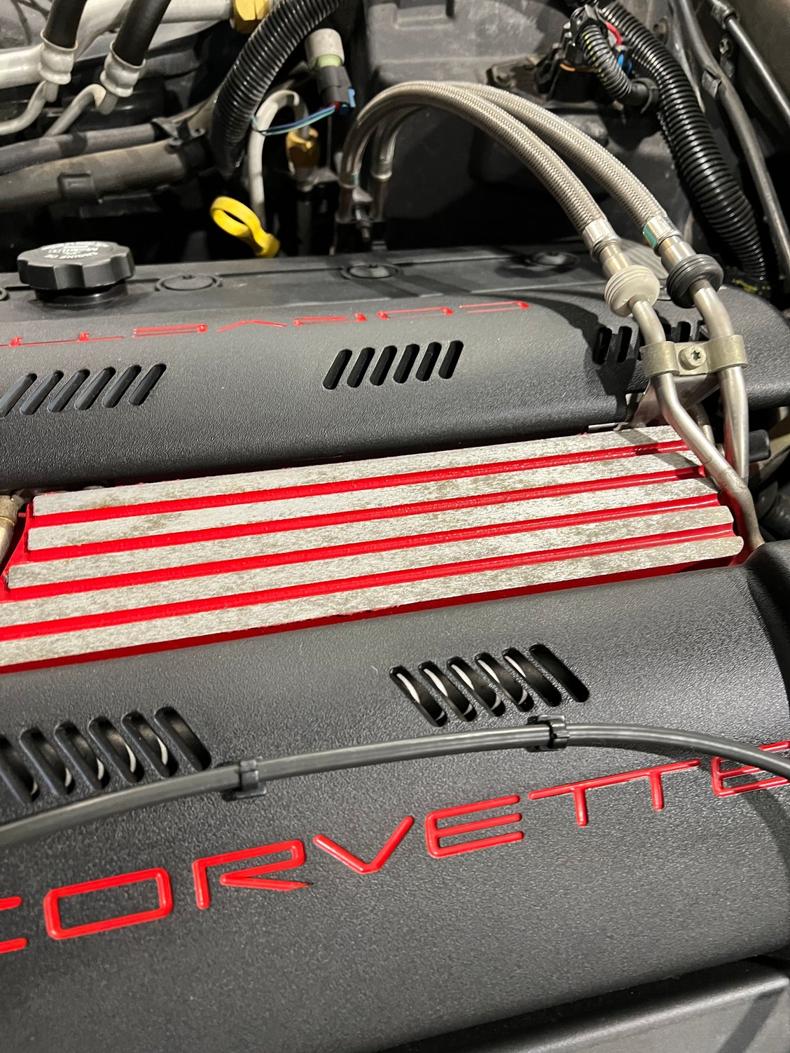

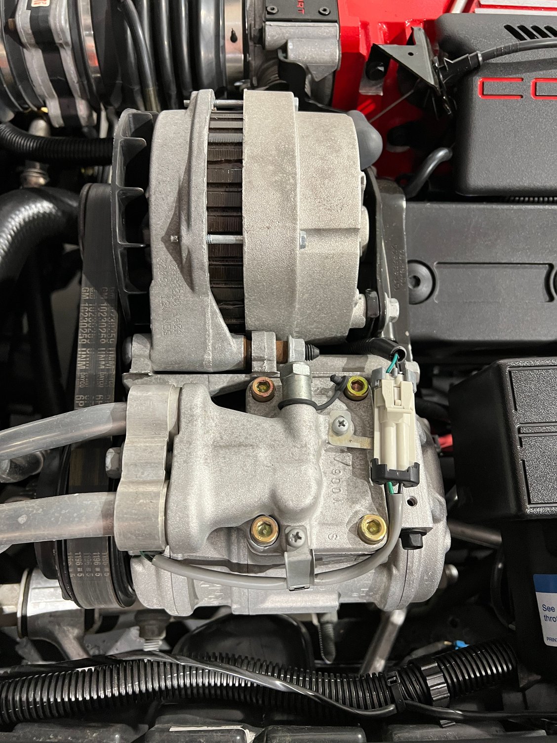

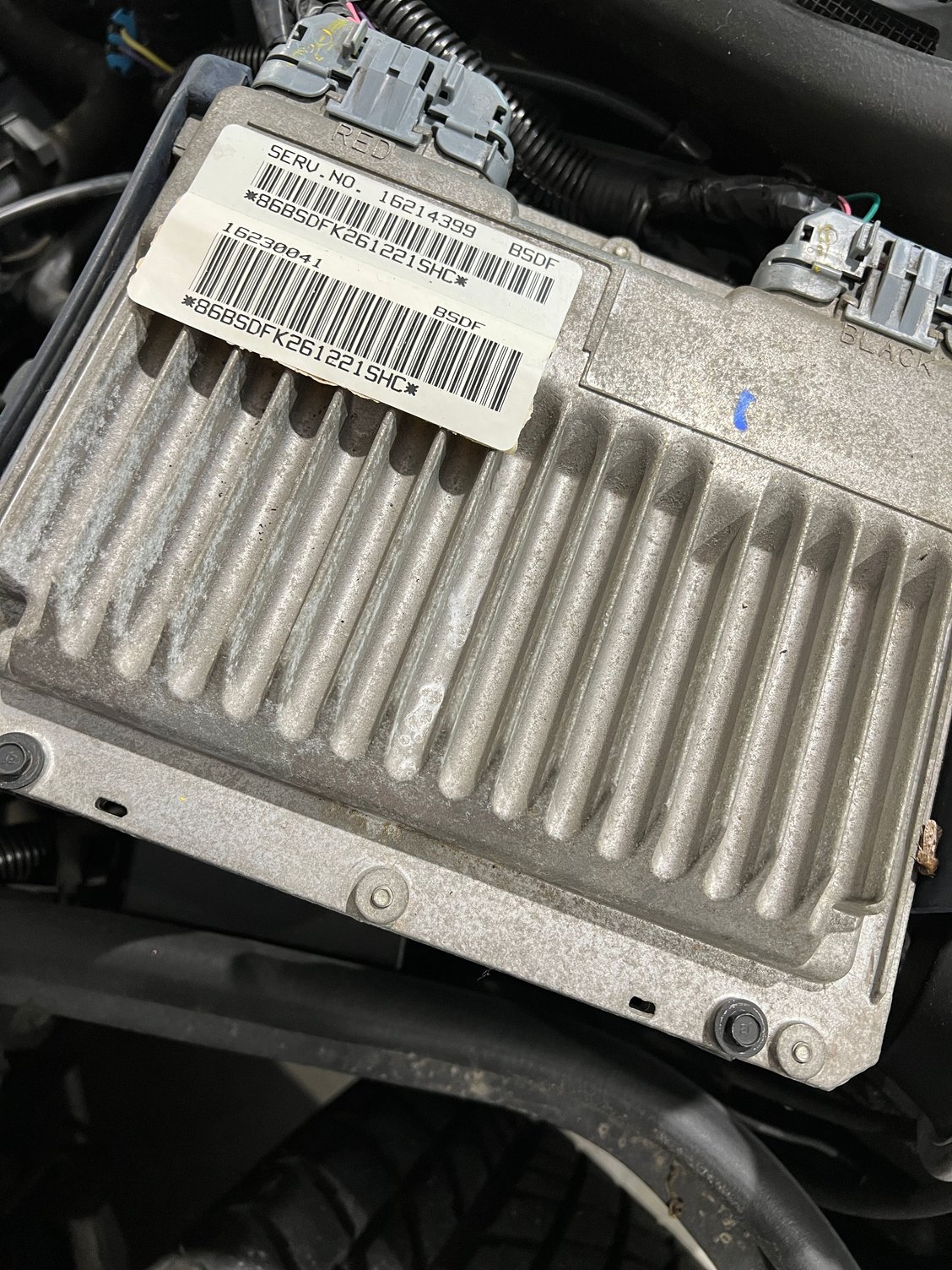

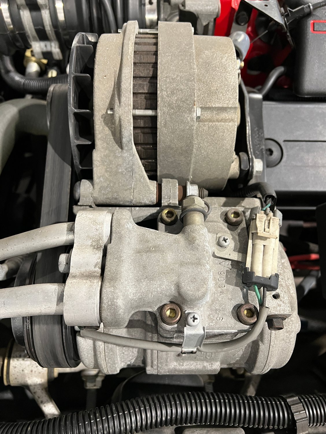

I just picked up a 96GS with 3300 miles. The alternator, AC compressor and ECM aluminum are showing some darkening and some oxide formation. I have another 96GS with 12,000 miles and the engine literally looks showroom new. I'll update this post later with some pictures. Looking for some tips and tricks to clean these items up. Trying to avoid removing the AC compressor to avoid re-charging.

The darkening and oxide formation are caused by exposure to the elements and are not indicative of any problems with the alternator, AC compressor or ECM. But need some pictures

3300 mile car

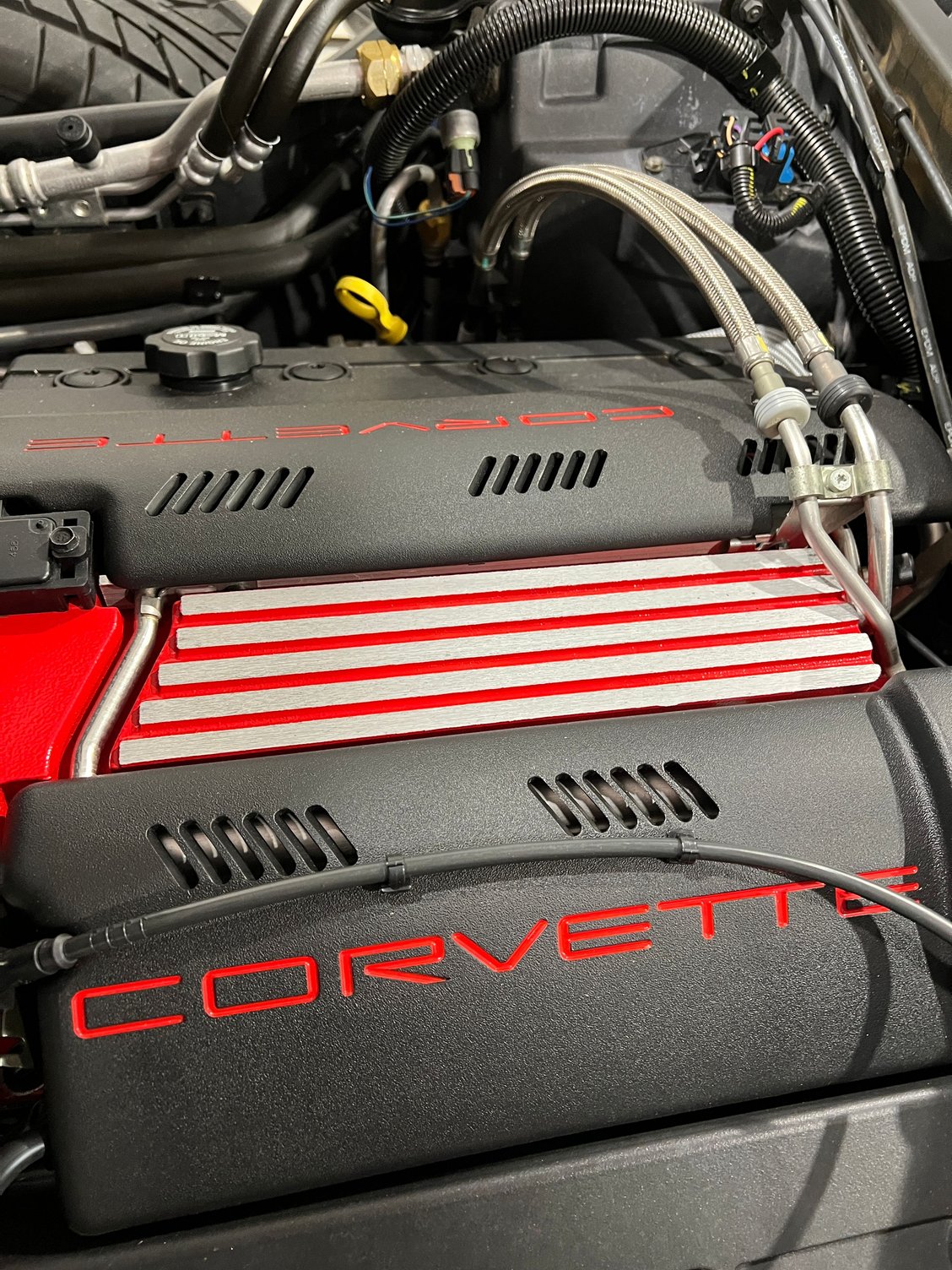

From: Murrysville PA
12000 mile car

I think that just rubbing the stuff with a rag, by hand would improve the surface dramatically. But if that isn't good enough, use an aluminum etching cleaner on it.

I got it pretty clean washing it with wheel cleaner then going over it with a scotch brite pad. The silver fins on the intake I sanded until bright again.
