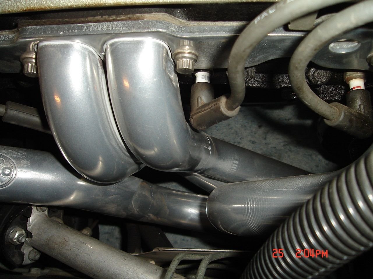

Correct,I have AFR angle plug with 2151's and they work perfect. Plenty of room everywhere.
Old Aug 20, 2022 | 12:49 AM
project C4's Avatar
project C4
Joined: Apr 2004
Posts: 621
Likes: 37
From: Texas
here is that same #6 with angle plug heads

So what makes this very confusing is that Hooker lists these as * NOT INTENDED FOR ANGLE PLUGS HEADS " But what they really mean is "not intended for factory angle plug heads " In other words the 113 D port factory Heads don't line up with the header flanges. Its the port shape thats the problem. It has nothing to do with the Spark Plugs them selves. I have straight Plug AFR 195s but I would much prefer angle plug 195s.
