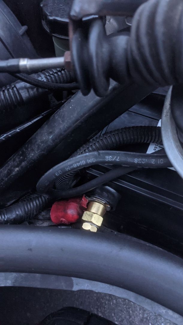

JUST realized as I was taking the battery out that the positive terminal looked funny and is an absolute battle to put on/take off. It was very​​​ corroded. I cleaned it and went to get another battery from Autozone using my Warranty.
When installing it I noticed the positive terminal seems to be rotated in such a way that it pulls away from the battery and when I try and tighten the terminal bolt it goes loose as if I stripped the hole in the battery. However when I move the terminal out of the way and just screw the bolt in it does just fine, snug and all. I can see clearly that the terminal is not making perfect contact with the battery.

Positive Terminal: https://drive.google.com/file/d/1k7L...ew?usp=sharing
Negative Terminal: https://drive.google.com/file/d/1k6c...ew?usp=sharing
Both Terminals: https://drive.google.com/file/d/1k03...ew?usp=sharing

You certainly have issues but a reasonable solution depends much on the quality/gauge of the positive cable and similar for the negative. Someone 'charged' you for that work? A reasonable approach would be a pair of new battery cables. I thought responses might improve if the actual snapshots were added to the thread. The negative cable looks to have the ring terminal & protector still intact and the smaller wire just an add. The positive cable looks to be what's left of a compromised ring terminal and protector. If the positive cable is long enough some might just add an S/T 'ring terminal' and protector.

An '85 could possibly have had 2 different positive cables depending on options. Do you know if your car has Heavy Duty Cooling which would have been an Auxiliary Fan in front of the A/C Condenser/Radiator module. General appearance of your positive cable at the battery indicates replacing the cable would be the suggested repair. I don't believe the larger diameter cable that goes directly to the starter has sufficient length to add ring terminal & protector. Battery cable replacements are pretty straight forward. The negative cable is generally much easier.
