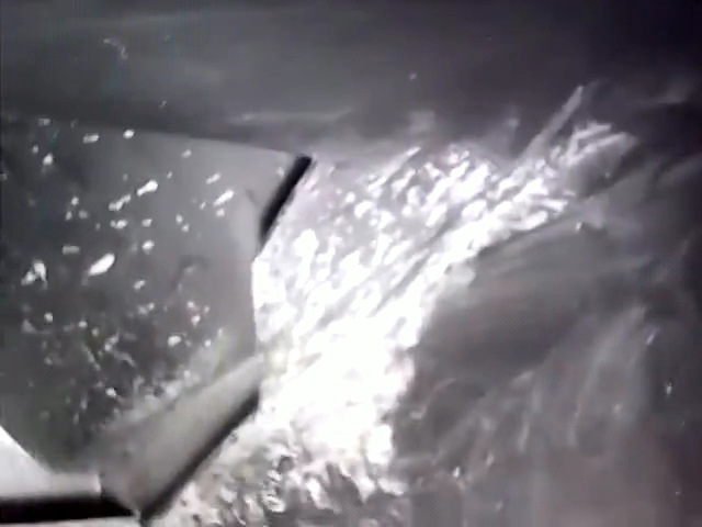

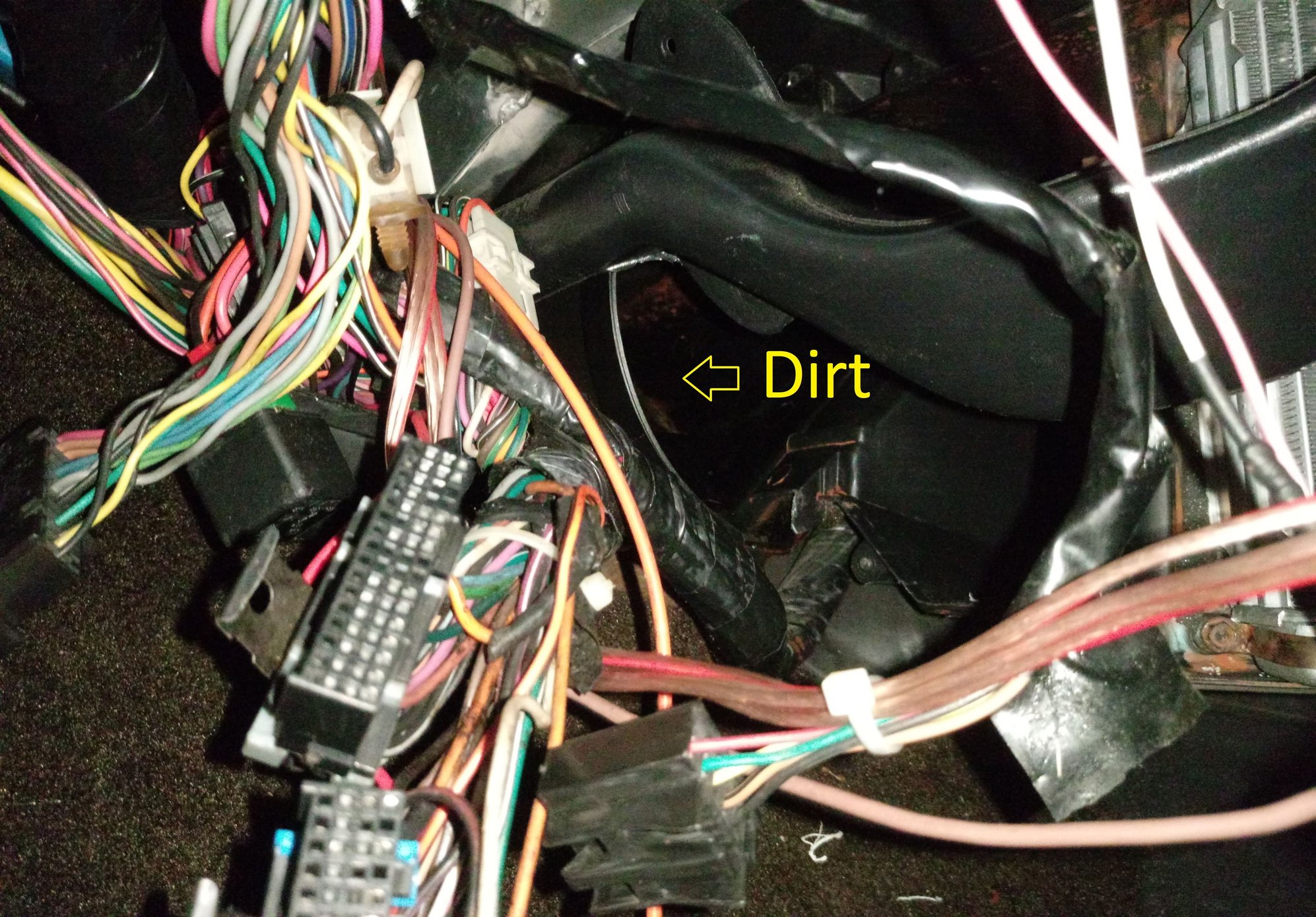

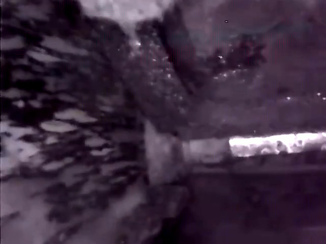

location of the following contamination pics
coolant contamination inside central air case 1
coolant contamination inside central air case 2
coolant contamination inside central air case 3

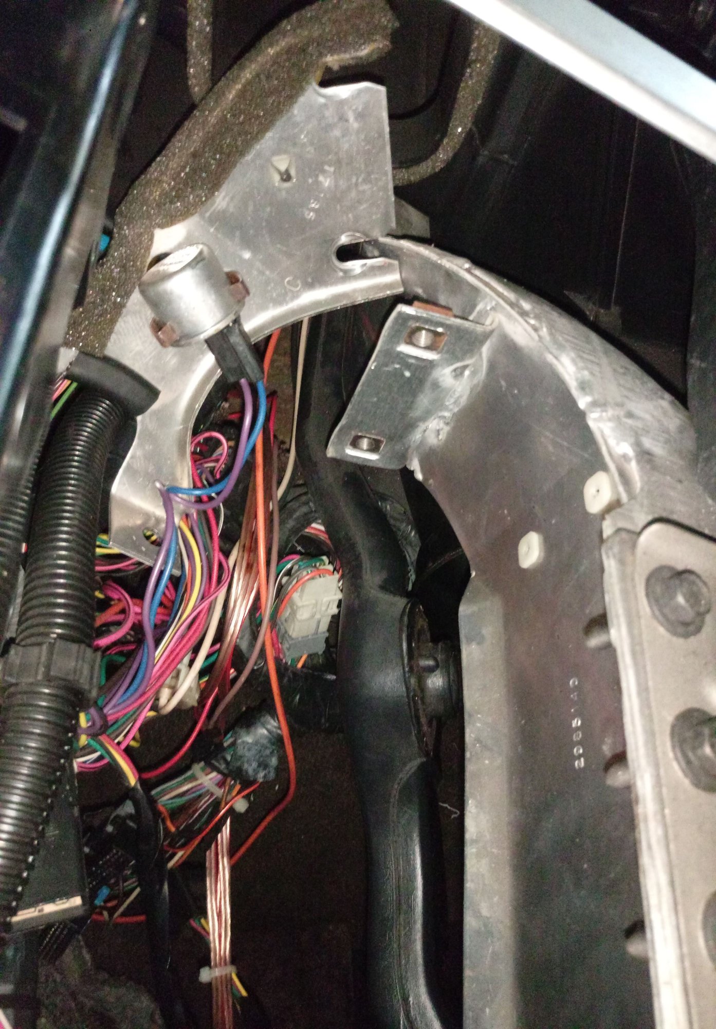

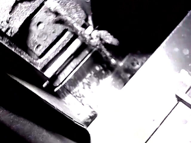

current dashboard status
current dashboard status (passenger side close up)
