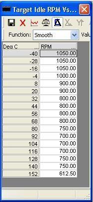

Random thoughts...550 rpm sounds a little low. Took a gander in TPRT 91AXCN 6 speed bin and the target rpm at 92*C is 700 rpm. No added rpm for a/c on. Make sure the minimum idle adjustment is done on a fully warmed engine. Agreed to check IAC but I would check IAC counts when it's idling at 550rpm. Just can't imagine that the IAC is pegged all the way that it can't hit target rpms unless the passages are completely clogged.
