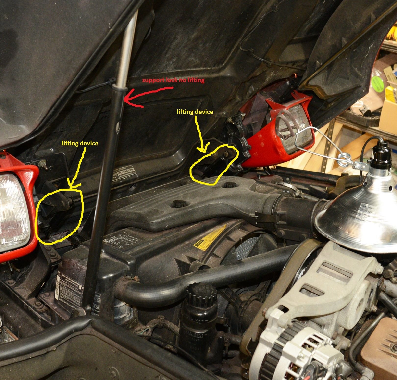

This is the single hood lifting (w/lock) strut. I am a large guy and can lift it without straining. It just seems like the strut is not providing any lift. I was not sure if it was going bad or if my older body just feels the weight more now. It has been > 30 years since I changed one and my younger self did not enjoy the task so the older me does not want to do it if not needed.

Above about a 2 foot lift, if that, the hood should almost fly out of your hands and full lift....the main strut takes 2 mins to change and does all the work. Couldn't believe when i changed the 3 struts on my 88. But jts the main one that does it all. I dealt with mine for 15 years before I finally changed it, and once I did I wondered why I dealt with the weak one for so long.

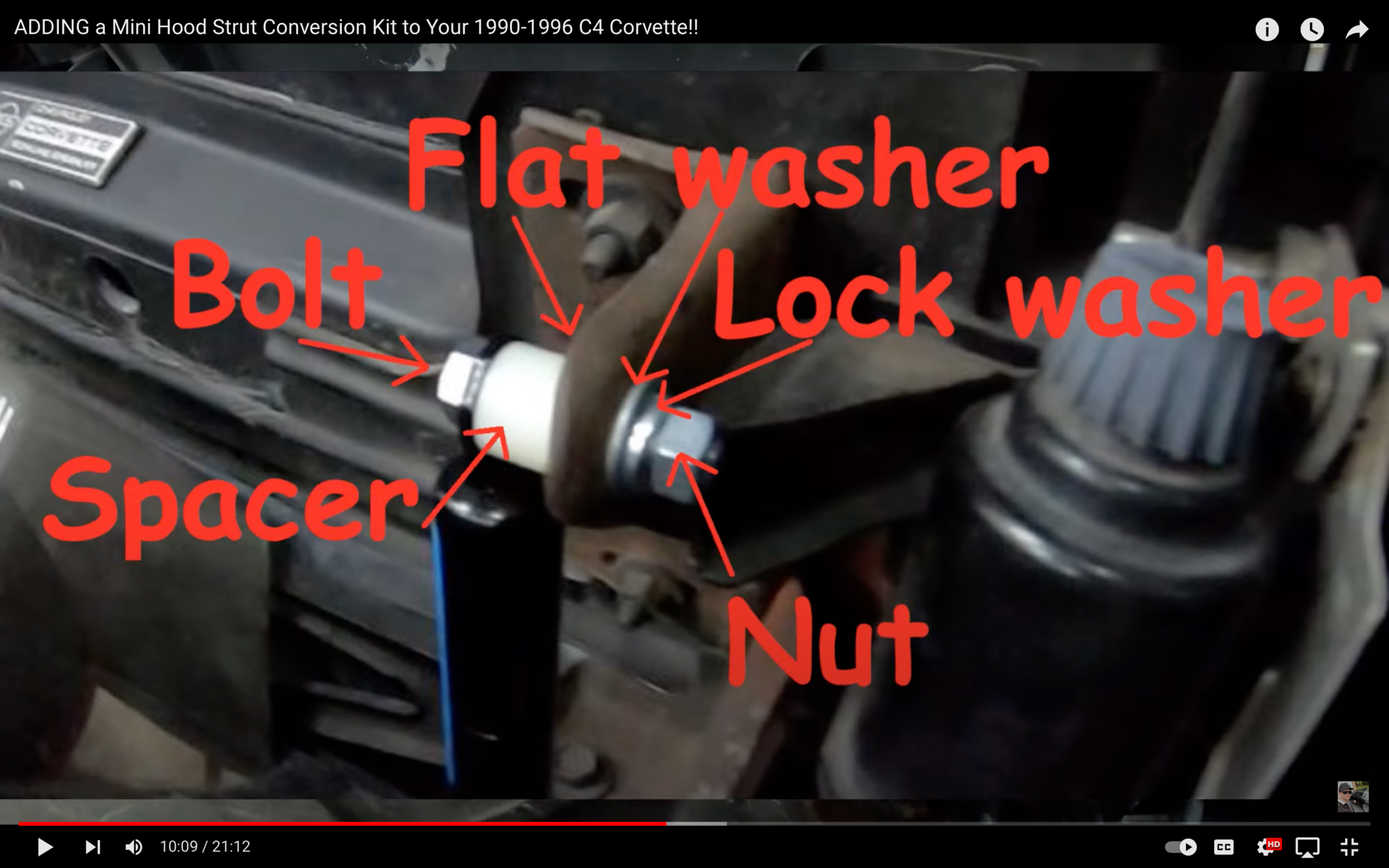

This one video has all the answers on youtube at
The C4 started out with two small lift assist cylinders and one locking latch. They then went to the two small and one strut / locking latch. Then in 1990 dropped the two small assist units in favor of just the one large strut/latch (my guess is cost cutting move). However you can buy/make a kit to mount the 2 smaller units to give your hood a boost up. More important to ensure it does not bust you in the head. I am going to do that.
Hood Struts with conversion (mounting) kit
Mounting kit if you already have struts

@Vets-Vet yes that's appropriate for your car but many with early cars add the later LH Support that also has a 'latching' option and it can even be enhanced by an after-market or self fabricated security provision.

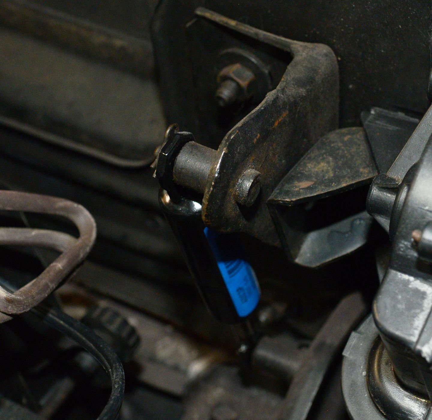

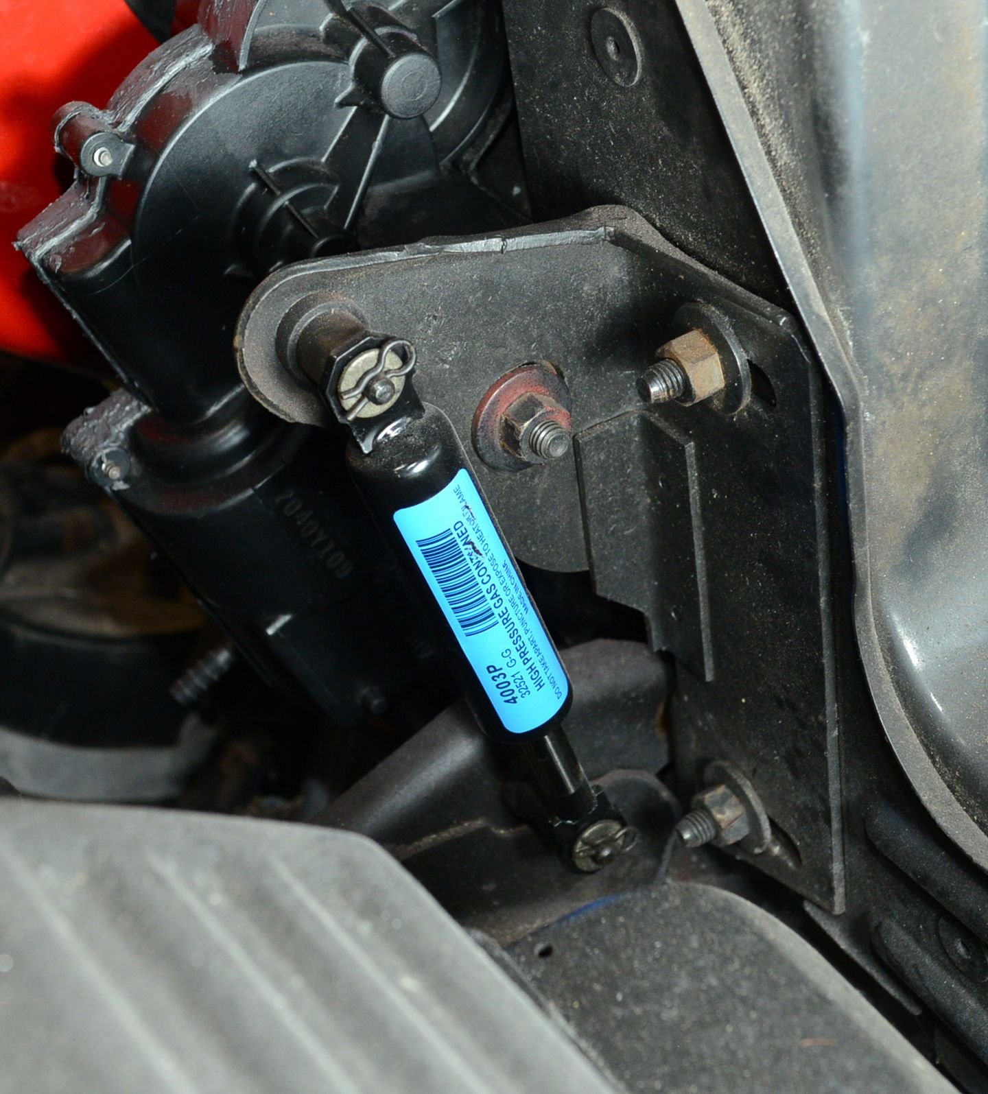

He wanted to see what my attaching hardware looked like. John I think the bolts look as strong as my fabricated pieces.

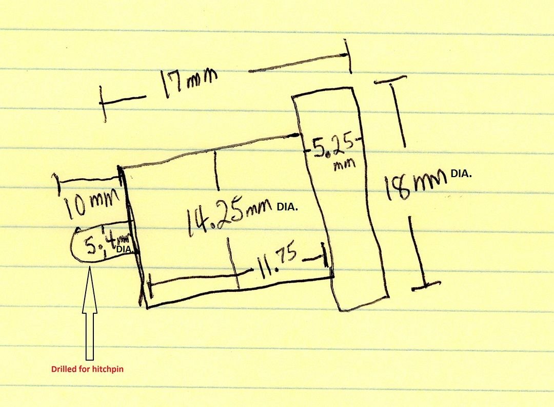

the kit to attach is just 4 bolts, 4 nuts, 4 spacers and 8 washers. With that setup you would not be able to tighten down the bolt because the strut has to turn as it moves. But if you can't tighten down the shaft (bolt) it turns on, it will flop adding stress. I am going to try and guess the size of the factory piece close enough to have one made. The OEM is riveted in so I will probably drill and tap that end for a bolt. It it works well it will be documented here. thanks again for everyone's input.

This does not include protrusion through hood bracket
