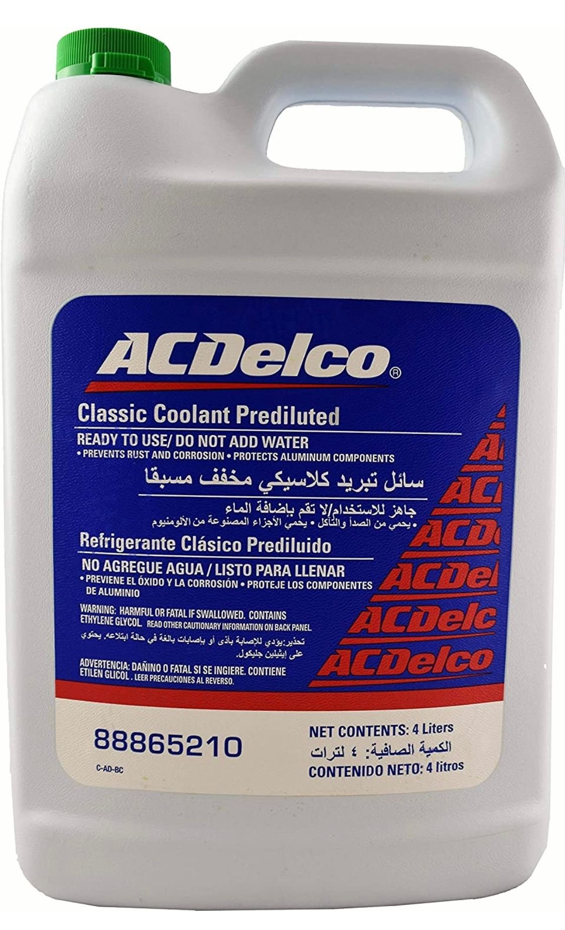

hi guys, is the below antifreeze good to use in my 1991 Auto (L98) after flushing the system?
are the anti-leak pallets any good?
TIA

Stick with green 50/50.
you can flush all you want but unless you drain the block you’re going to mix dex and 50/50.
no benefits with dex cool for your 91. Change it every 5 years and you’re good.

which is this one:

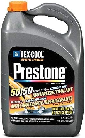

I use this

That is great coolant. It is however a bad choice for your year Corvette. Stay away from the Dex-Cool and the potential problems it could cause.

Yeah? Have a look at the pics in THIS THREAD/POST ...scroll down the the 4th and 4th picture. Then tell me what a "bad choice" Dexcool has been for that 23 year old radiator....
Originally Posted by Deepa
Stick with green 50/50. you can flush all you want but unless you drain the block you’re going to mix dex and 50/50.
True. Do we know he didn't pull the block drains?
Ah, non ELC coolant should be changed annually -which no one does and thus we see "my car is overheating" and "Heater core replacement" threads all the time, on here.
Dexcool (and most other ELC coolant) can go for 5 years....and there is the benefit of Dexcool in anyone's '91; less maintenance and/or better protection. Ford supposedly has a 20 year coolant out now. I'm keen.

Personally I'm a big proponent on using the orange Prestone DexCool. It can go longer between changes and has a better anticorrosive package. HOWEVER it is very very important that you completely flush you're cooling system if it is using anything other than DexCool. If you mix DexCool and regular antifreeze it's going to turn into brown sludge and clog yout radiator and cooling channels, so you have to get all​​​​​ of the old stuff out. That either means removing the knock sensors to get to the drain plugs and flushing with a garden hose or pulling the t-stat, putting the housing back on, hooking a shop-vac up to it and sticking a garden hose into the other end to pull all of the old coolant out.
As for leak-stop pellets, just don't. Fix whatever is leaking the right way instead of dumping metal and sludge into your cooling system.
