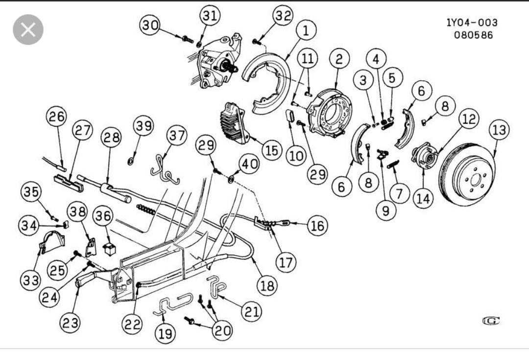

Sample of my 94 attached.
94 E-brake sample

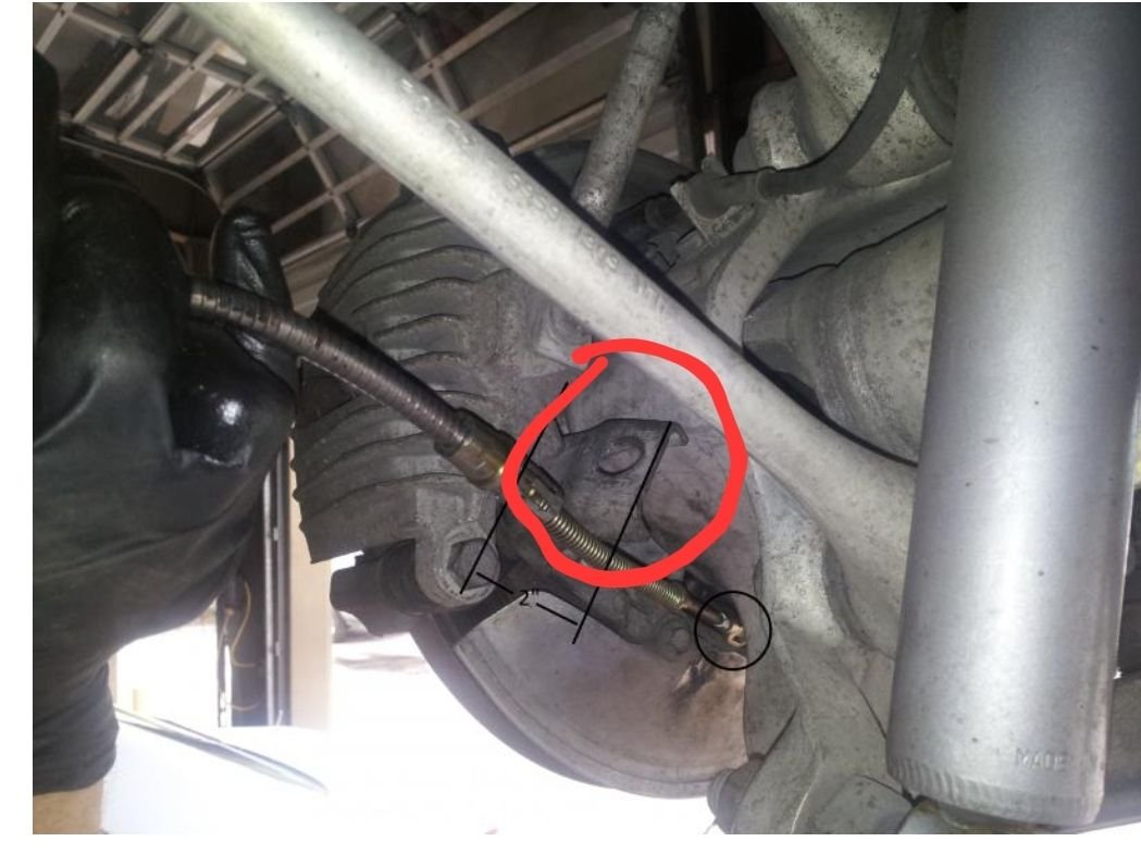

Here is a picture of the bracket that I'm talking about for clarification. Sorry for the confusion, I should have posted it earlier.

Like my 94 E- brake pic.
The 85 is similar.
From your pic you are missing the equalizer tube.? That provides the proper cable distance/ tension. Between the L& R e-brake.
Like my 94 the inner cable ends. Connect/ disconnect in the center. To aid droping the C- beam & drive shaft.
85 E-brake sample

You posted the pic of a bracket.
This bracket is missing from your vette due to previous owner correct.?
If this is true.
That bracket is mandatory to stop the brake housing and provide the inner cable specific distance.
End results pulling the lever. Pulls the front cable. E- brake locks the drum.
