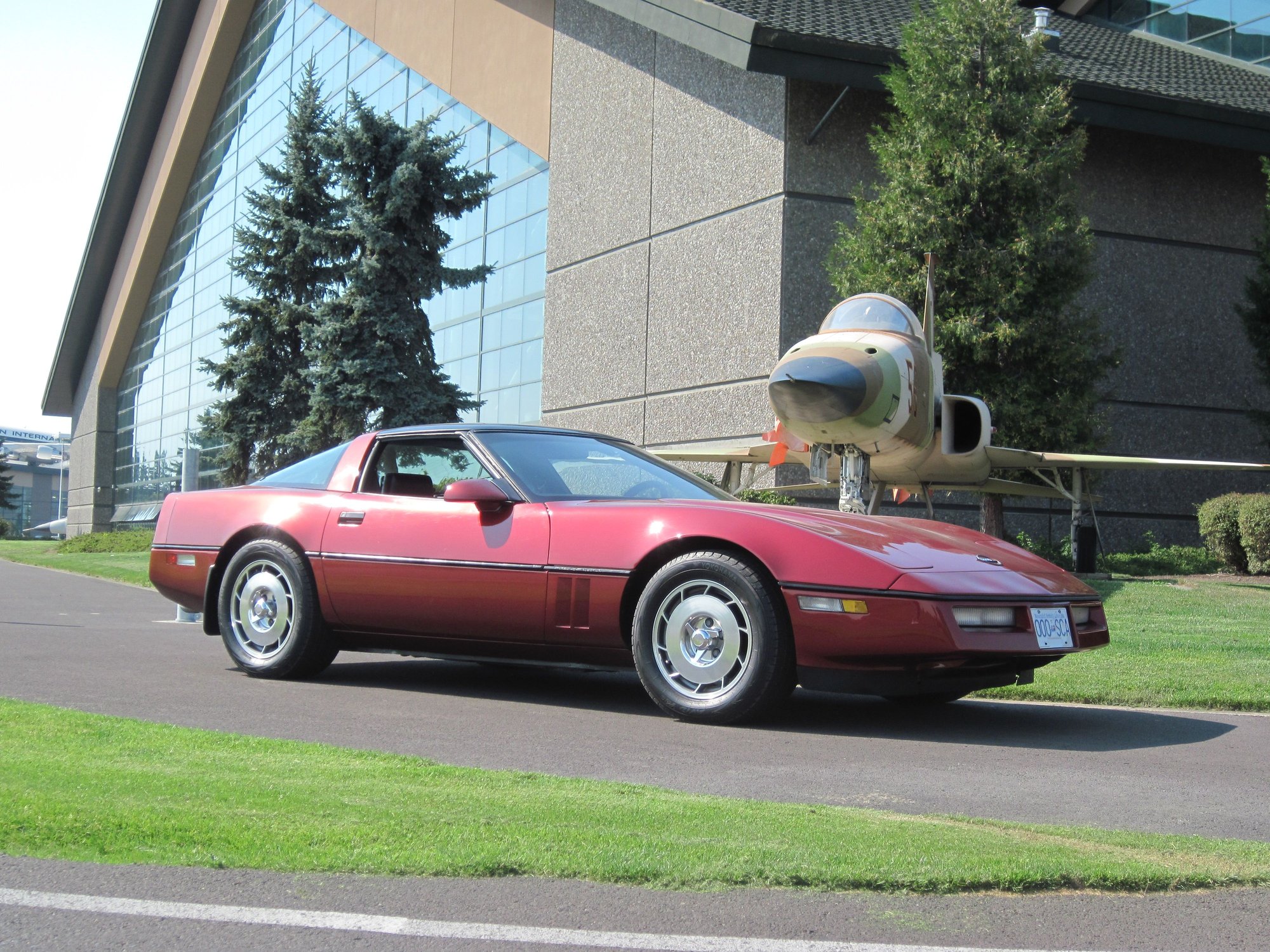

Looks like you have C3 hub "spinners". I bought some years ago thinking they were the correct size for the centerbore. Apparently, you proved it! Good job.
