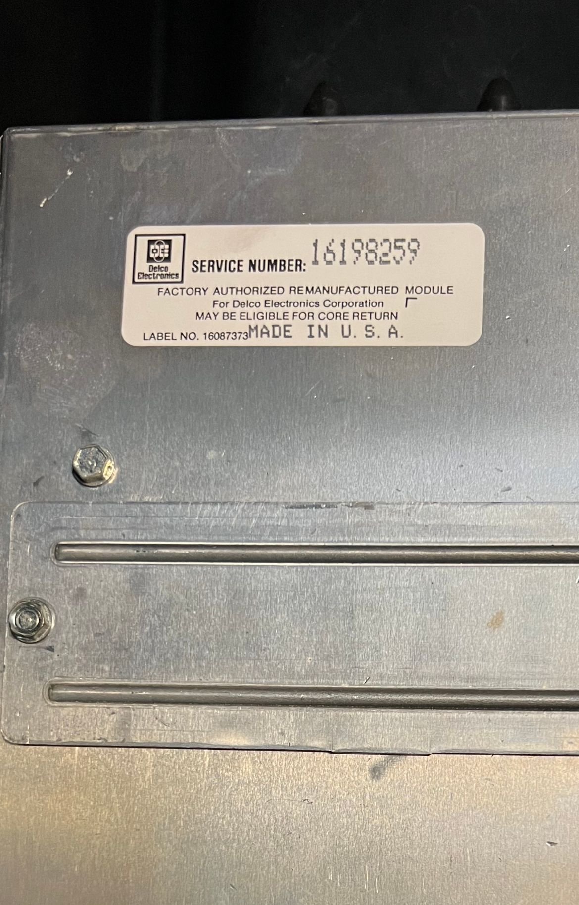

I got my 89 corvette back running around the 1st of July but have been plagued with drivability problems & lack of power issues. So could I really have a bad ECU? The current one in my corvette is already an AC Delco reman unit, so it wouldn’t surprise me if it failed again. Along these lines someone else said there is usually a cause so be sure to find it. Not sure what I’d be looking for on that one or how to diagnose a bad ecm?

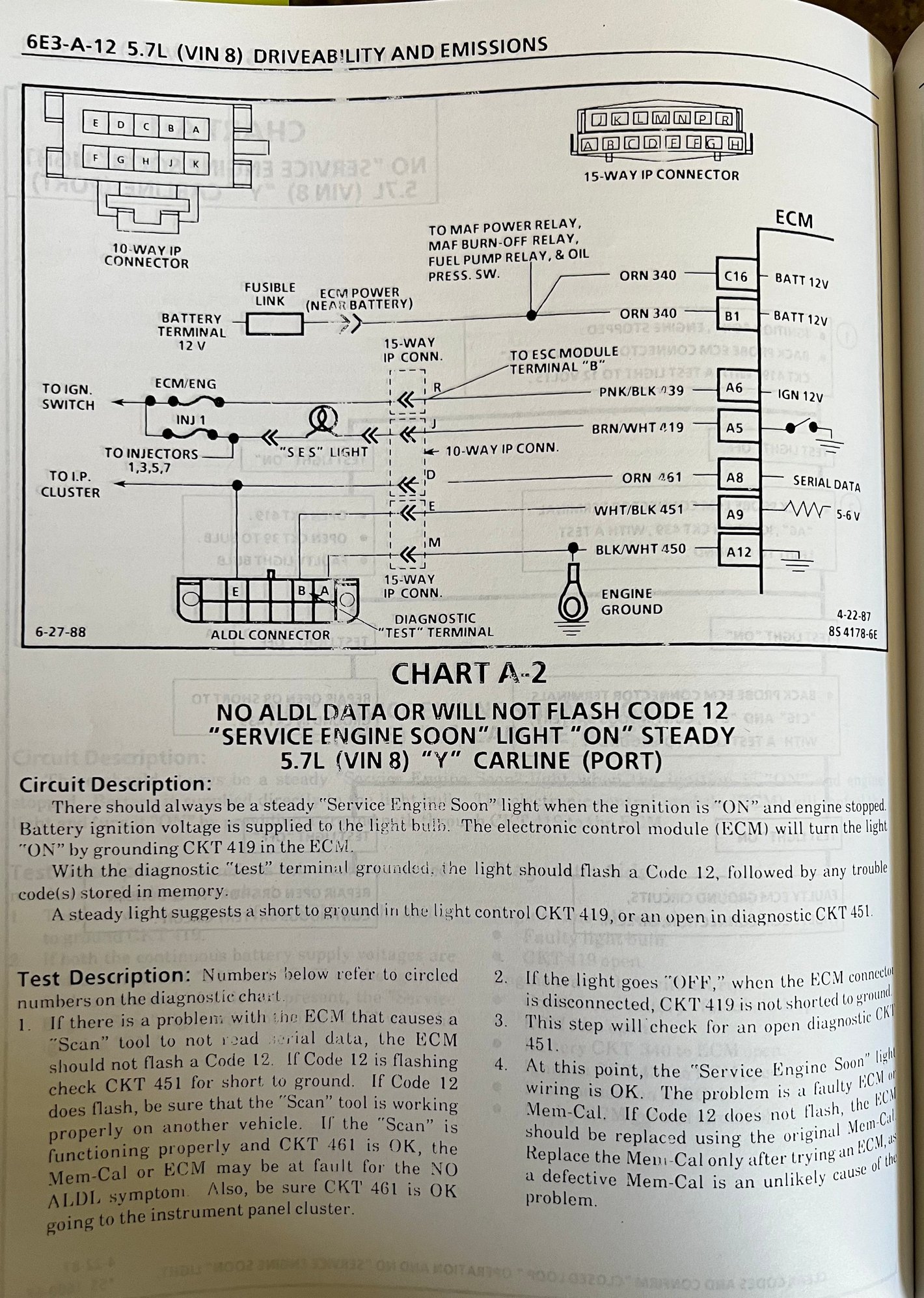

The first part of diagnosis is will it flash a 12. That would indicate ecm is ready. Checking power and grounds at the ecm. Beyond that you need to follow symptoms chart in the fsm. It's been a minute since I saw a monitor 2000. Does it still have parameters cards? During setup did it ask for body type after asking for engine code

The first part of diagnosis is will it flash flash a 12. That would indicate ecm is ready. Checking power and grounds at the ecm. Beyond that you need to follow symptomssv chart in the fsm. It's been a minute since I saw a monitor 2000. Does it still have parameters cards? During setup did it ask for body type after asking for engine code
Yeah I remember him using one of the numbers in the vin, along with year & make of the car. Could have been more he used as well. My friend is an ASE master mechanic & is still very very sharp but he’s also human which is why I wanted to see what others have experienced. I have a FSM & I’ll be honest, it’s a Royal PITA to find anything in it but I’ll fit it up shortly & see if I can find help in it. 🤞🏻

I was successful in finding where in the FSM they had “No ALDL Data”. Going through the FSM test procedure with my multi meter I have determined that the ECM or MemCal is bad. Per the FSM directions I’ve ordered a replacement ECM. Also spoke to Jim today & he said the effects of the prom install are immediate & one doesn’t need to drive it any distance or time to notice the changes, they are immediate.
