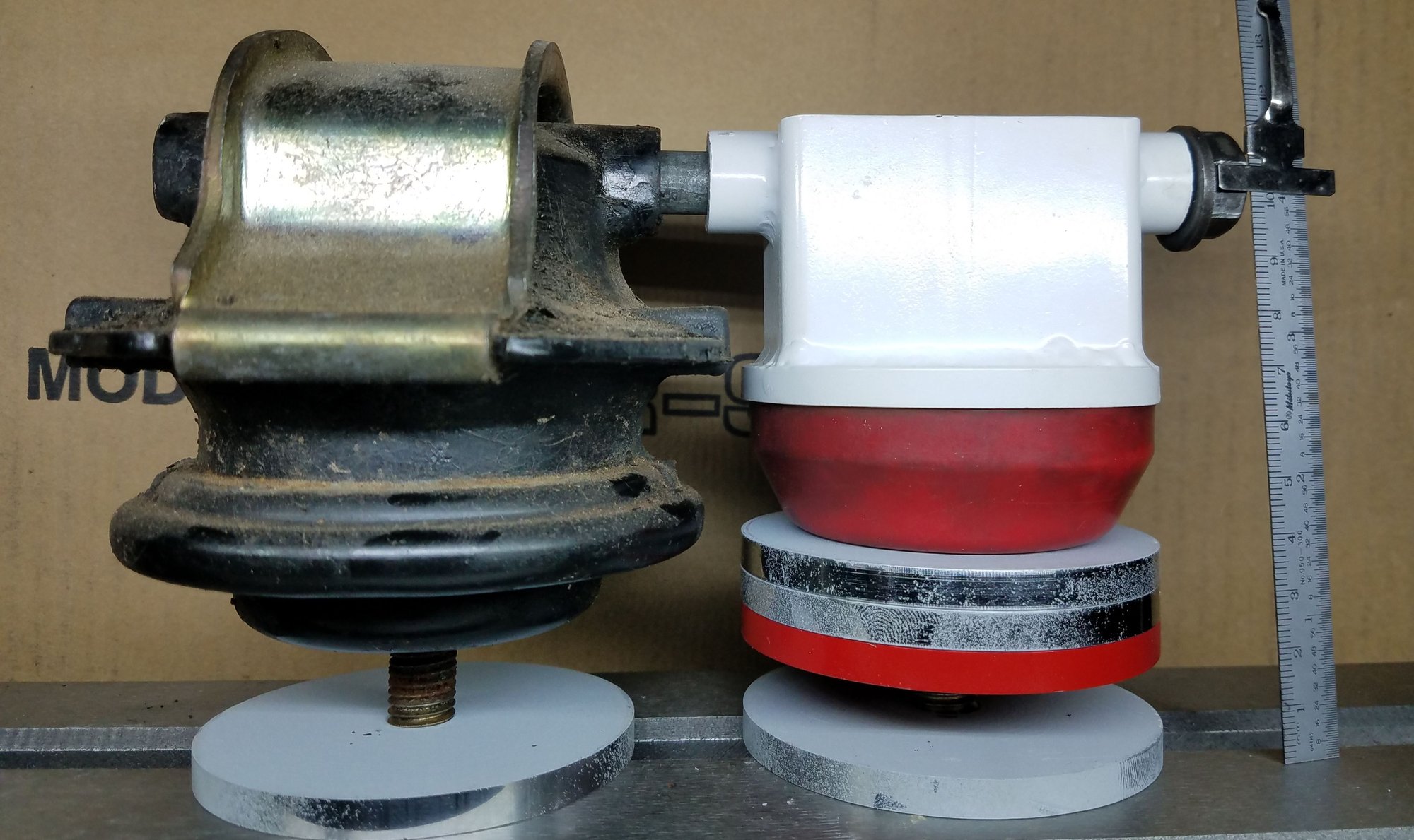

** topic shift.
LT1/4 specific custom MM.
Pre - paint

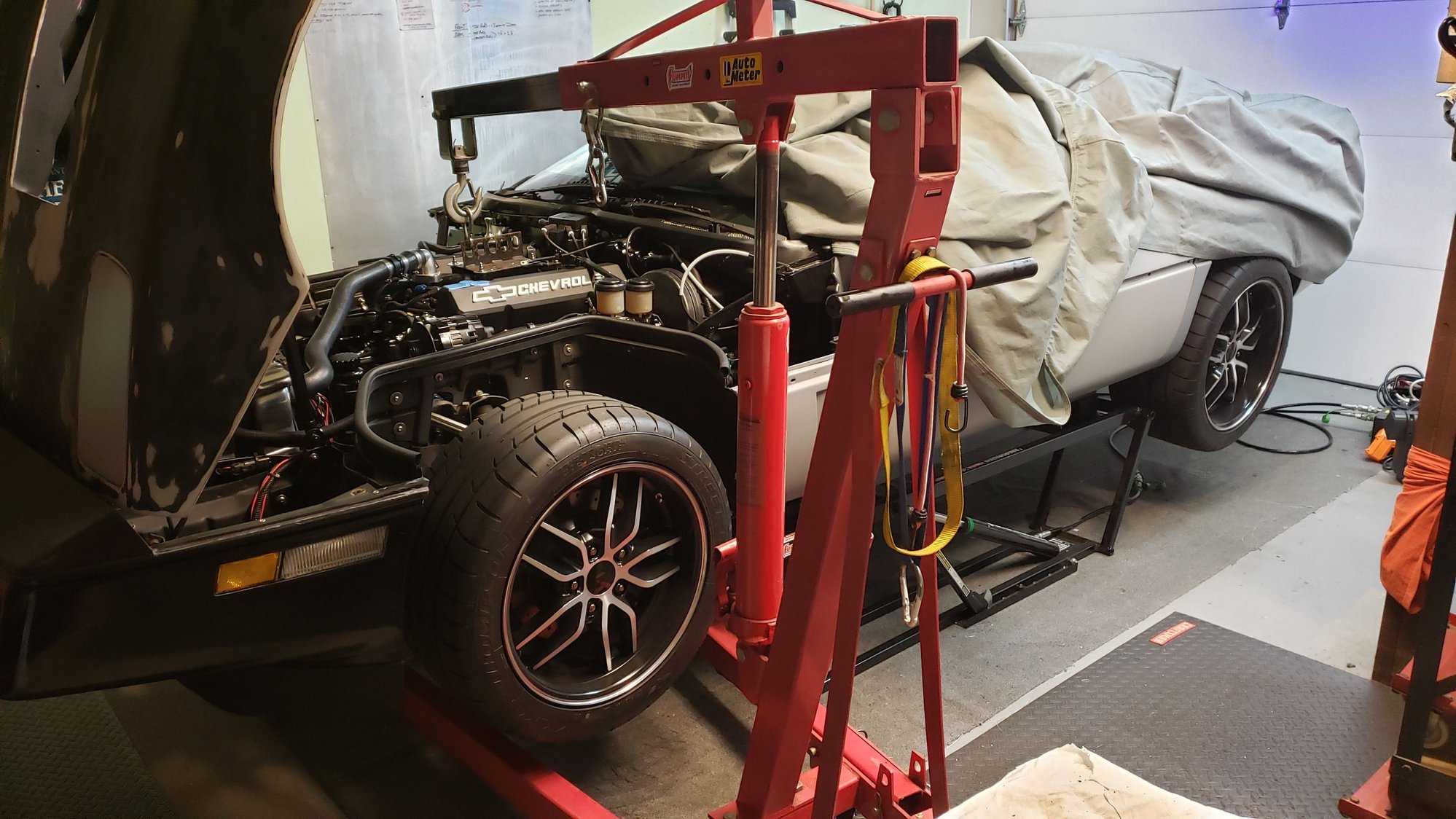

Getting ready to do the job...when I jacked hoist up just a little (until I felt a little pressure), I can now fit a business card between balancer and k member. So hopefully this does the trick.

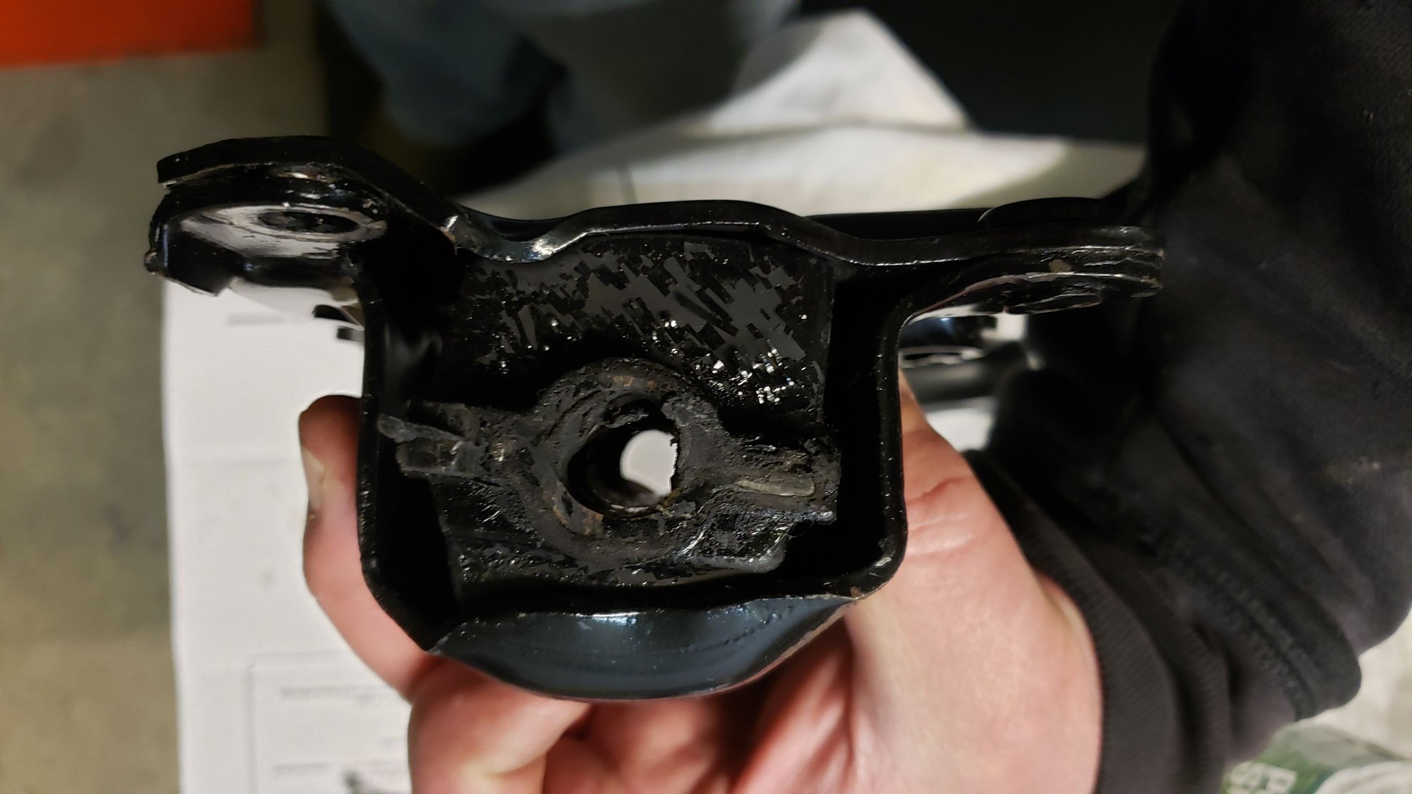

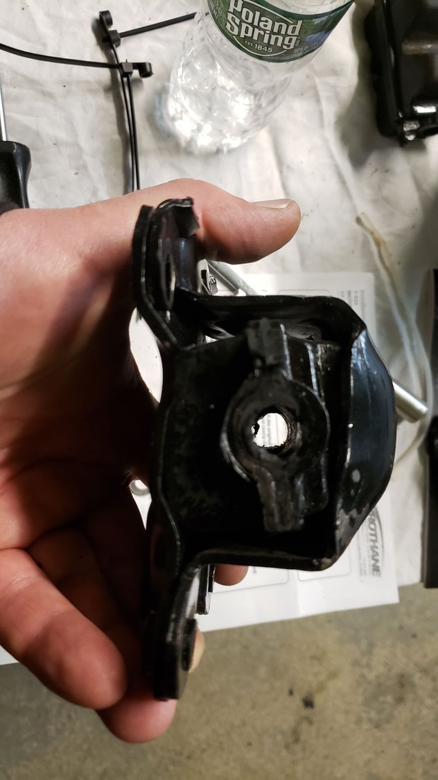

Passenger side looked ok, but rubber very flexible.

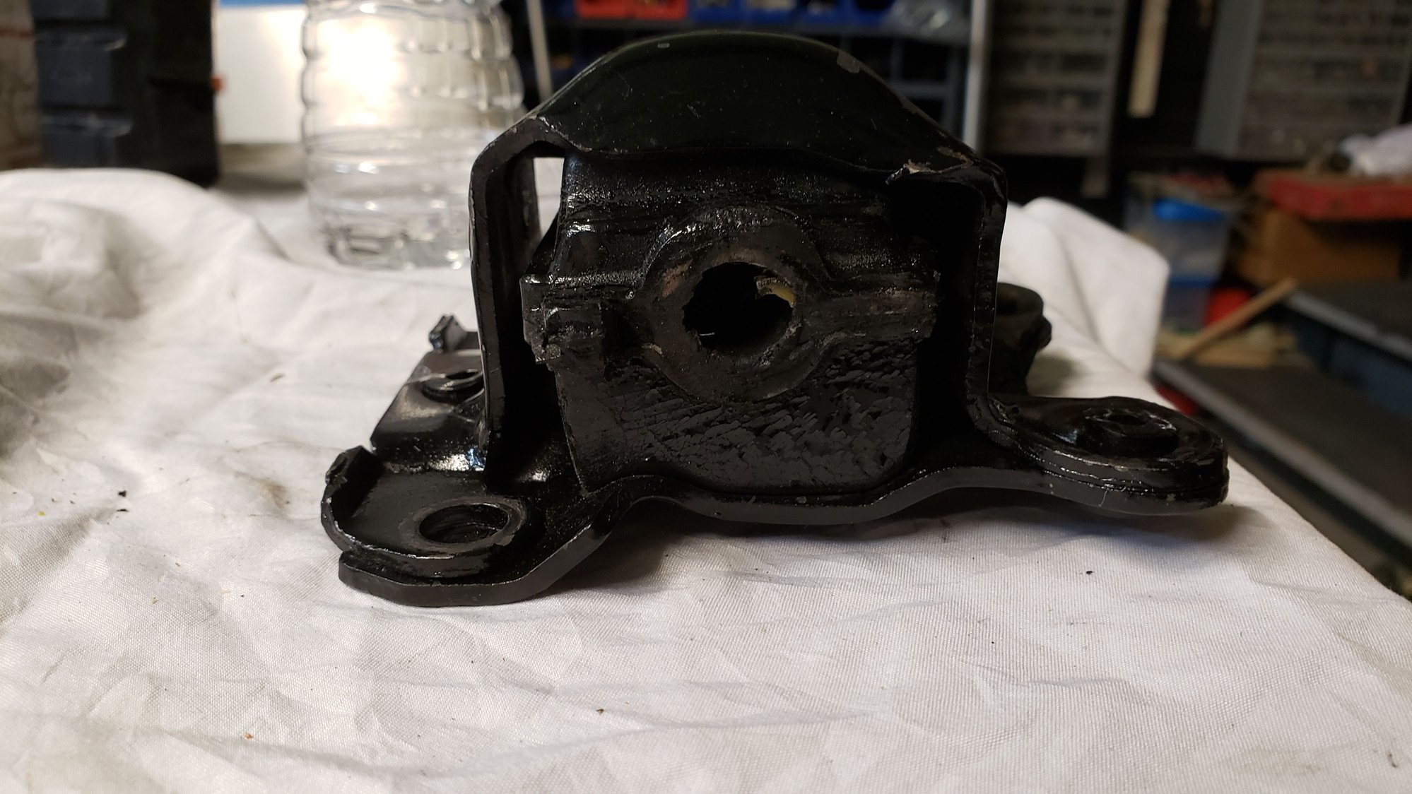

Drivers side. Looks twisted.....

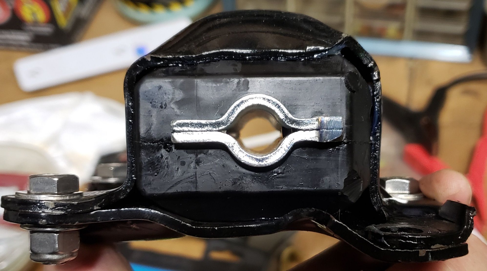

New Prothane inserts. Fit perfect. Happy with them and definitely recommend them....ill show more of the job soon for reference. Hope this fixes it, but definitely looking like this was the issue with the drivers side being this twisted.

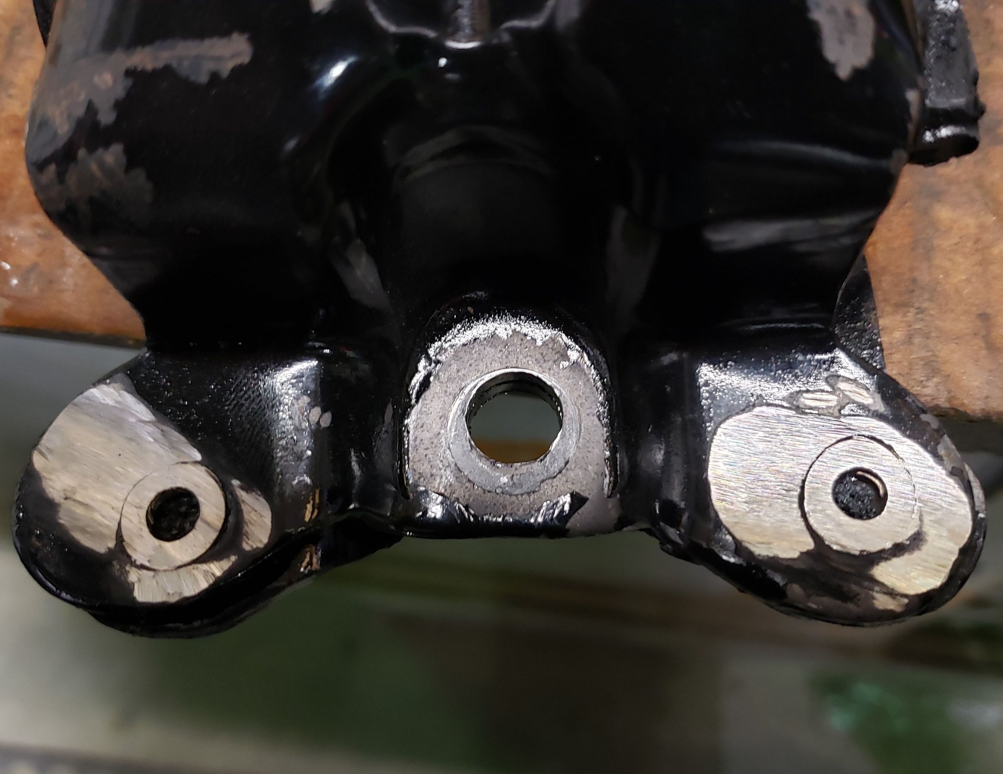

If anyone wants to know, these are from suspension.com...they are Prothane, was like 70 bucks shipped for the pair. But here is some advice....
Dont drill the rivets out. Its alot easier to grind the heads off from this side with an angle grinder...took 5 mins tops. Then just use a punch to push the rivet out...
I used stainless hardware but the bolts in the kit are plated so up to you...but anyways, lightly put a smear of grease in the metal shell, both sides..Then put 3 3/8 bolts in the mounting holes before you tighten the 3 5/16 bolts up. Tighten them up in a pattern until all are fully compressed. This keeps the 3 mounting holes straight and even.
Finished.
Old twisted one and new one. Also they install from the top down in the car in case you didnt know.
