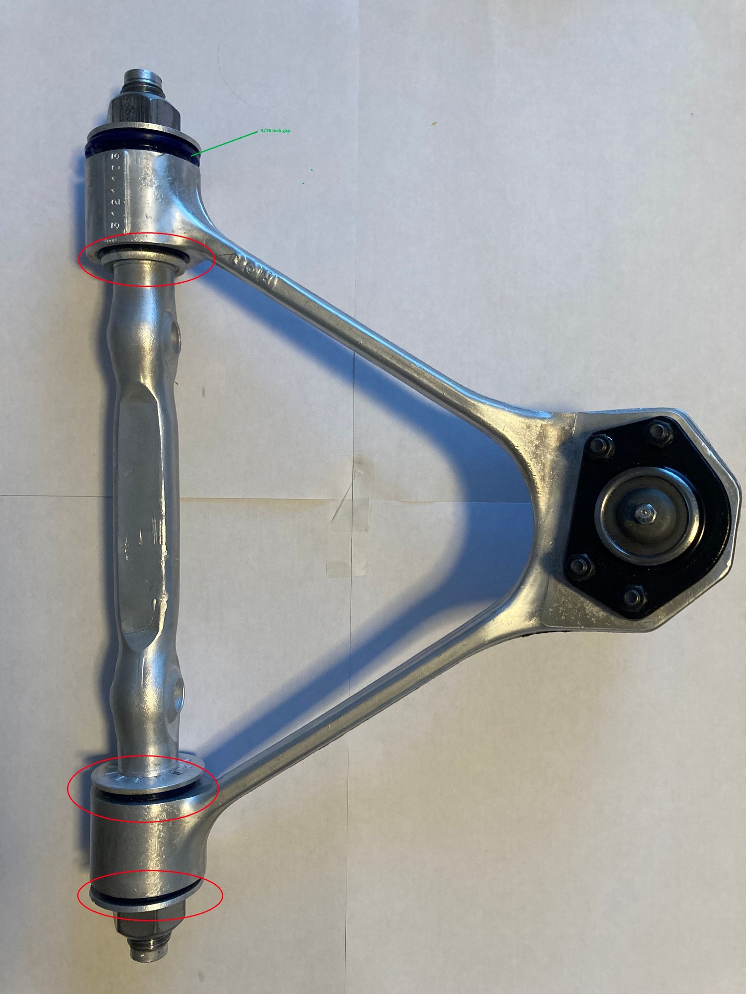

I am in the process of installing the front end of the superpro bushings kit I purchased this summer. And I gotta tell ya, my frustration level has just about peaked.
Everything circled in red looks normal to me, but the gap between the edge of the arm and the inside edge of the bushing is 3/16". I know this can not be correct. I have got it installed with the original washers as they were.

It sure doesn't look like they have been pushed all the way through. When you pushed them in, did you do it in such a way as to not spring the control arm ?
You can see in the video(s) that the bushing is pressed all the way through the bore. Yours do not look like it. (the videos mostly show rear suspension, but the installation is the same)

I had a steel rod placed between the front and rear arms to prevent any bending when I pressed them in. I checked the measurement with the one still on the car and the spacing between the two arms are right at 9.5 inches.
The front bushing and tube are both bottomed out against that smaller inner washer.

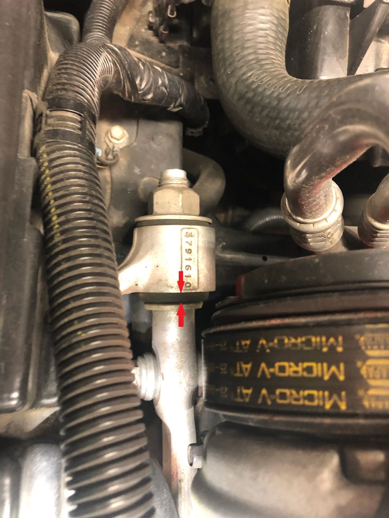

These pics should show you the gap spacing on mine. The pictures "look" like you might have squished the arms inwards a bit. Key word is look. Measuring will tell.

Are the internal sleeves not causing the washers/nuts to bottom out before they start compressing the arms ?

In the first post, those nuts are tight and there is that 3/16 inch gap. The inner sleeve and the bushing itself are tight between those two washers preventing any compression. If I did bend the thing, is it possible to spread it out or am I SOL?

Do you have someone close to you that you could compare with ?
Any other forum members here close to Washington, Illinois that could help out here for comparing against ?
I have a 1/4" gap at the arrows on both sides of the car.
