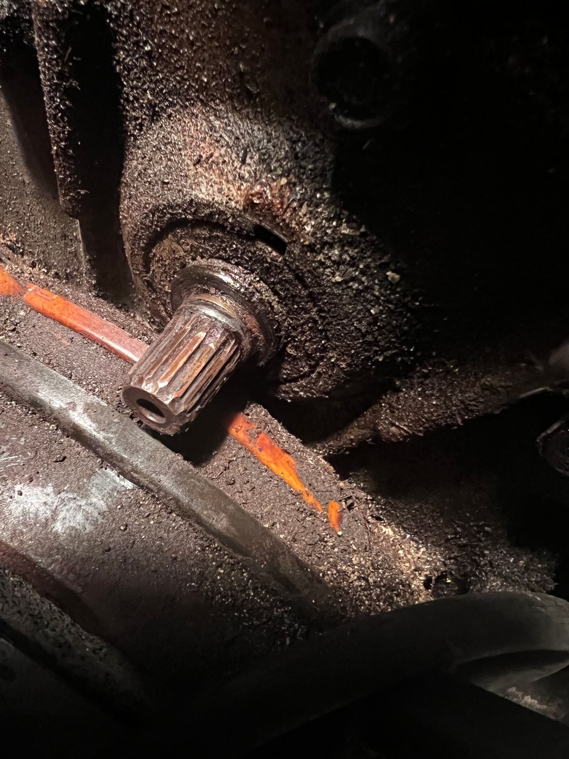

Decided it was time to change my water pump today and I come and see this wonderful surprise... (See photo).
The teeth on the water pump drive (cam side) are stripped pretty badly. It still grabs on to the coupler fine, but there's the amount of play in it is concerning.
I'm at a 3-way street now:
1, do the right thing and remove the Optispark, timing cover, and replace.
2, don't worry about that and install an electric water pump
3, redneck it, get a new coupler, and JB Weld the s*** out of it.
Any advice is well appreciated to help steer me in the right direction.
Thanks! - Taylor

I'd say, if you have the skills and tools, then do the right thing and fix it correctly.
Having said that, as you remove the Opti and everything else to get to the drive, you will likely run into other "surprises".

JB weld FTW! Who needs to ever take the water pump off again !?
The electric pumps I’ve heard can introduce other problems, so unless you have some other reason…
You know the right answer!

Always do the right thing. You don’t want some half assed repair failing when driving it, do you?

I would also replace the coupler. Must have been some alignment problem to allow the coupler to vibrate bad enough to strip these splines. Maybe the water pump bearing was going out. Dan
