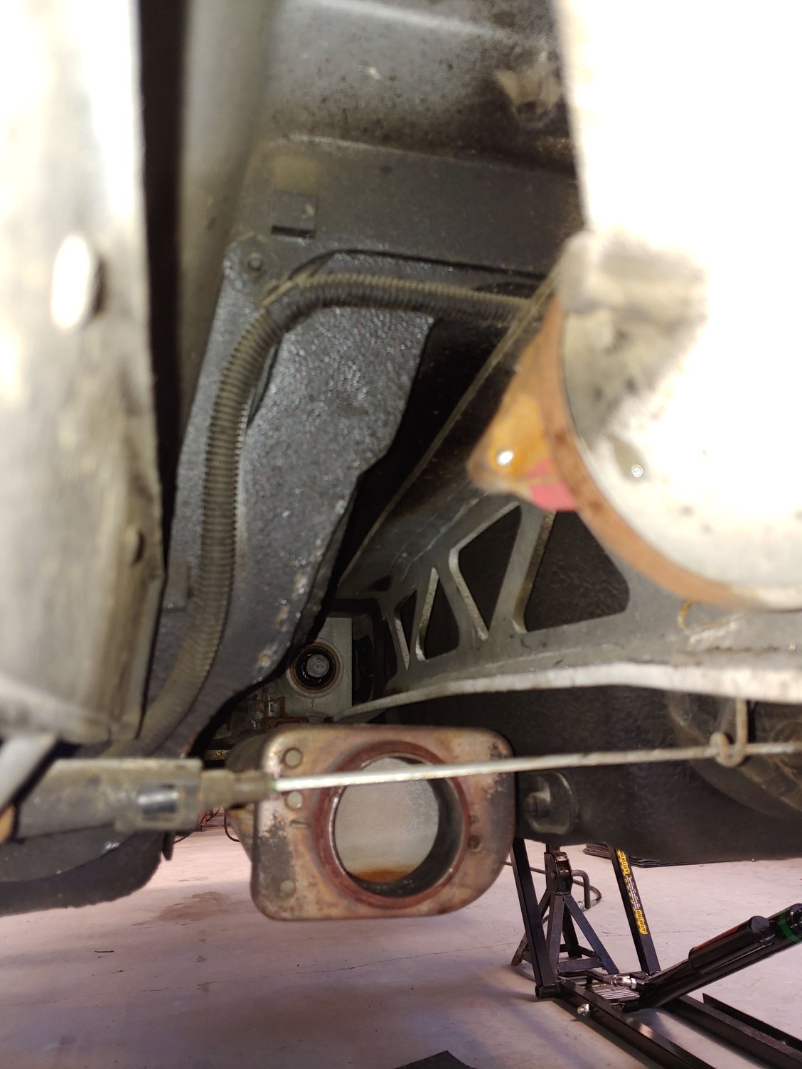

I'm not sure if this is well known or how it will be received in here. I don't consider this hacked, but it saves a tremendous amount of time and effort, and makes every subsequent driveshaft removal easier.
There is a seam in the transmission tunnel that is spot welded and has a fairly large amount of unnecessary material left after the spot welds. Trimming this extra material makes the clearance to remove the driveshaft. Do not trim into the spot welds. When finished, I coated the area with undercoat.
The factory manual for '88 recommends removing the entire exhaust and C beam. I only removed the cat-back.

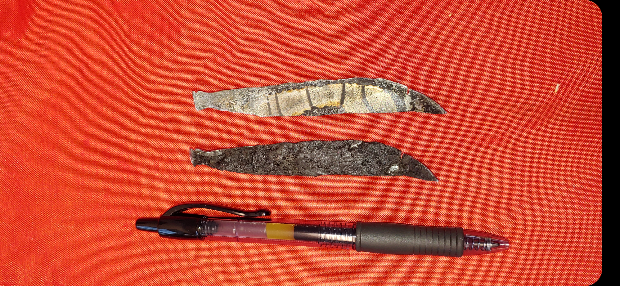

This is the amount of material I removed from the seam.
This is the seam after trimming.

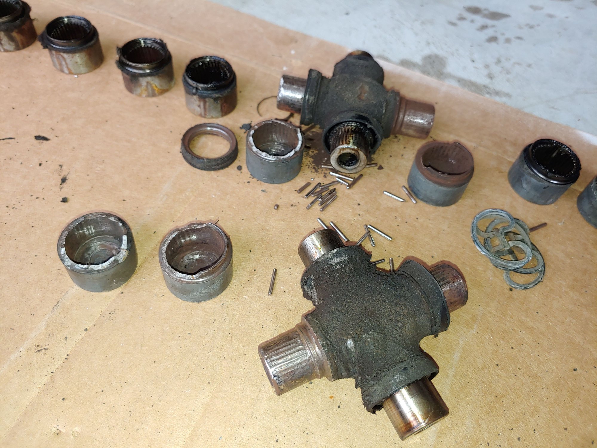

New driveshaft and half shaft u joints.
Part numbers.

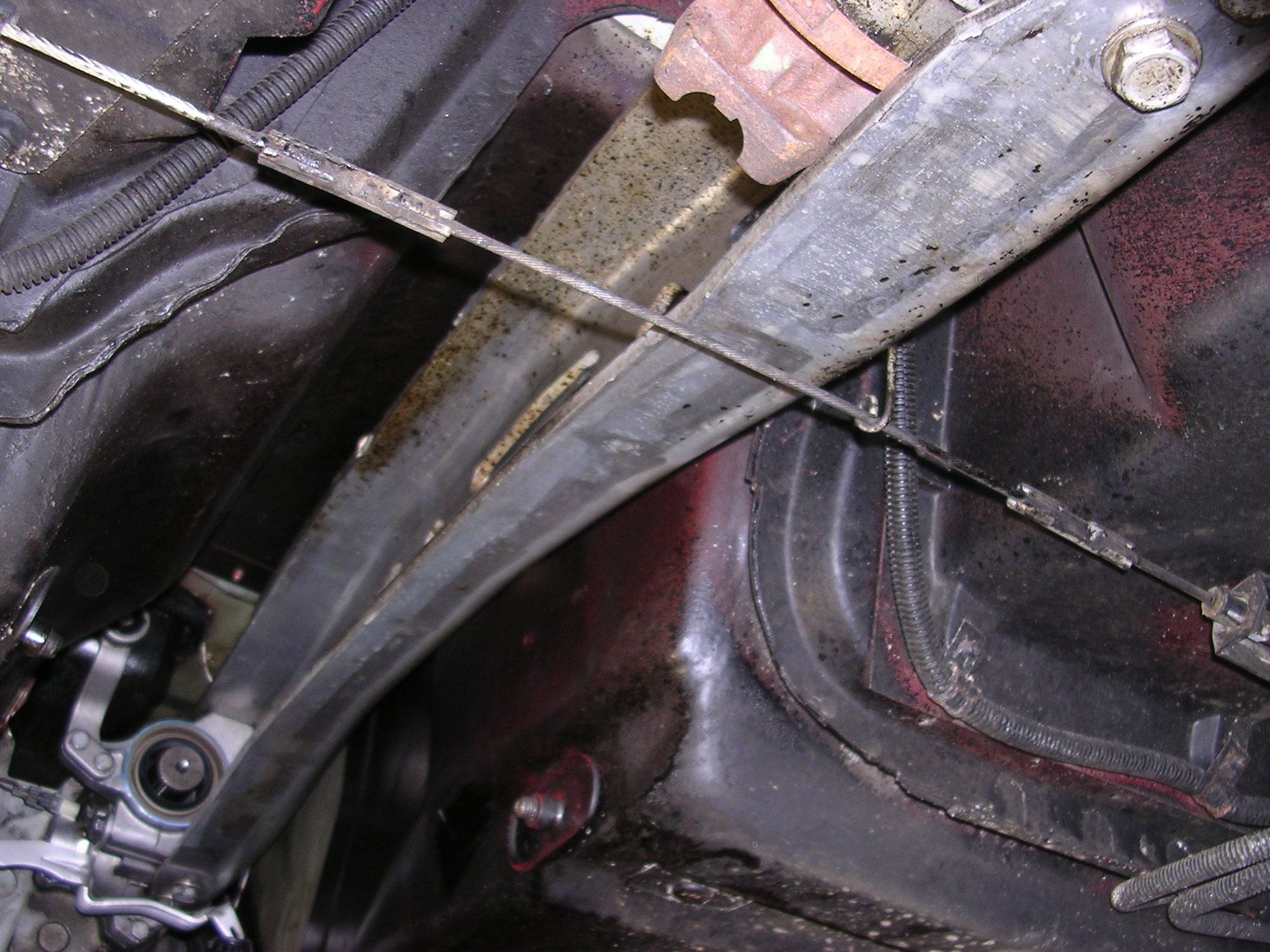

That area was bent out of the way on mine prior to my ownership. I can confirm from personal experience that it makes it very easy to slip the driveshaft out of the car without disturbing the C-beam. I'd have bent it out of the way myself if somebody hadn't already done so. Seems like a no-brainer to me.
Shaft out, C-beam undisturbed:

I see the quickjack in the background of you photo. I just purchased mine and really like it. I have only used it the one time so far to install an air to oil cooler to get rid of the coolant to oil cooler that came with the car. A previous owner had cut the metal tube that goes under the oil pan and replaced it with hose and four clamps. It never leaked but I always worried it would blow off on me and leave me stranded on the road. I also see you back up the quickjack with floor jacks. Big thumbs up on that.
