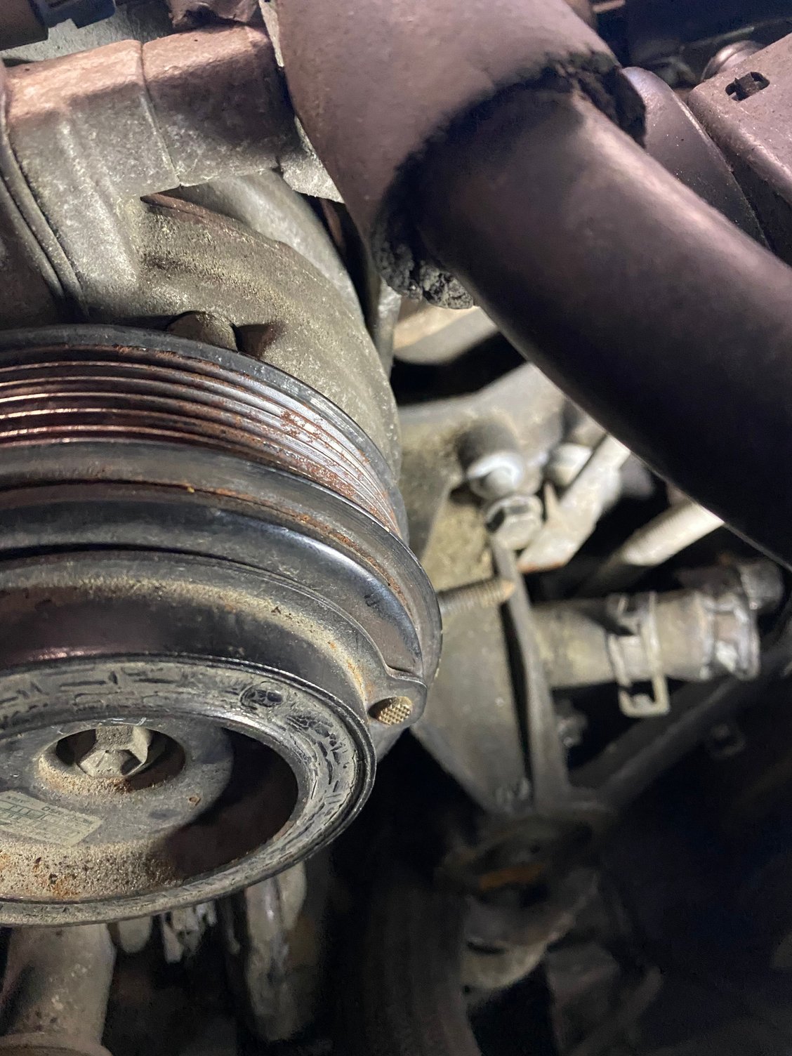

I am trying to change my water pump. I need to remove the air conditioner bracket and can’t figure out what I am missing. I have two bolts out but I think there is still one more. Can anyone help?

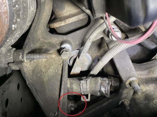

I'm guessing the OP figured it out. Just thought I would add to this if anyone searches for the same issue.
The brace at the bottom, circled in red, has to come off as well.
