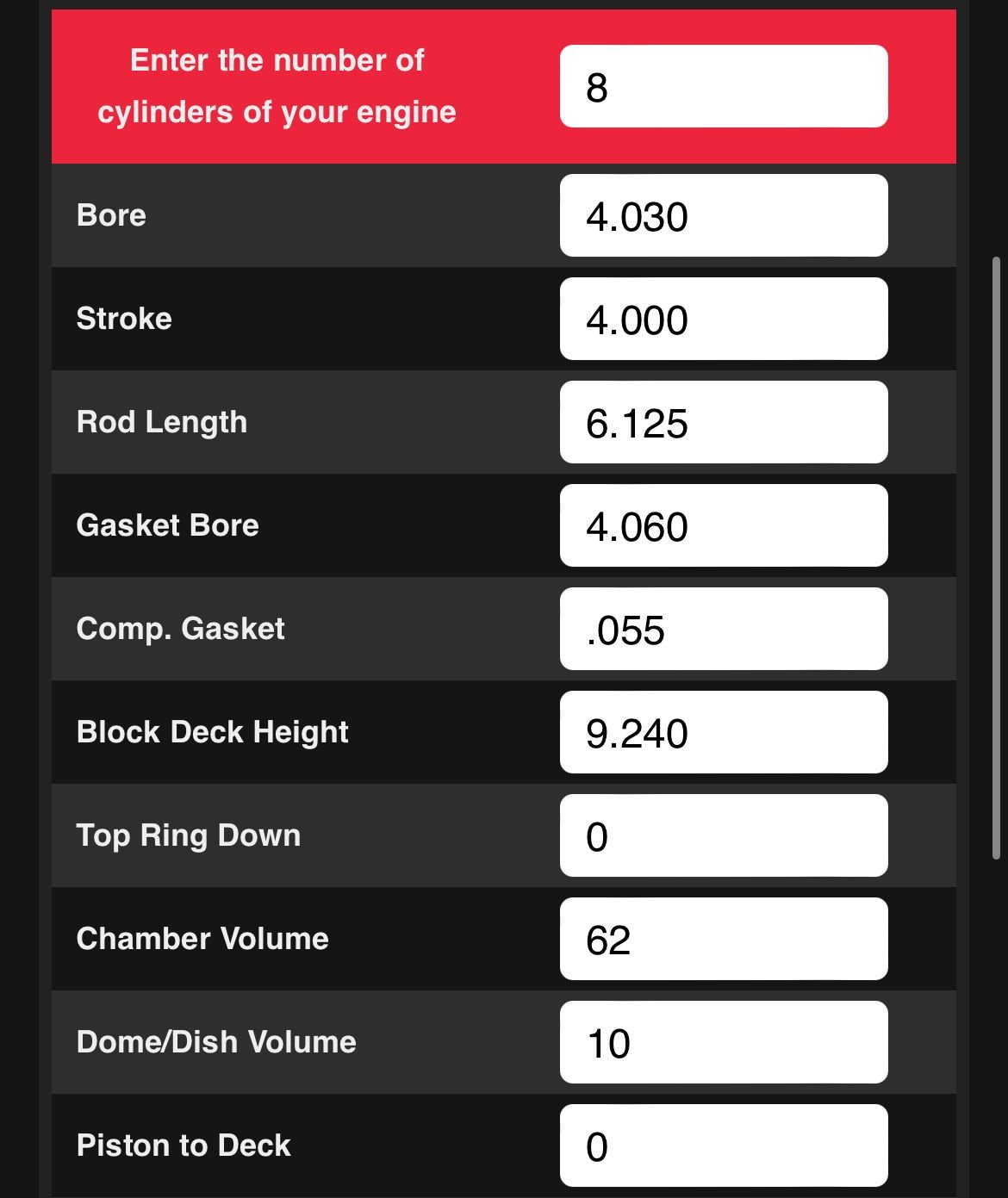

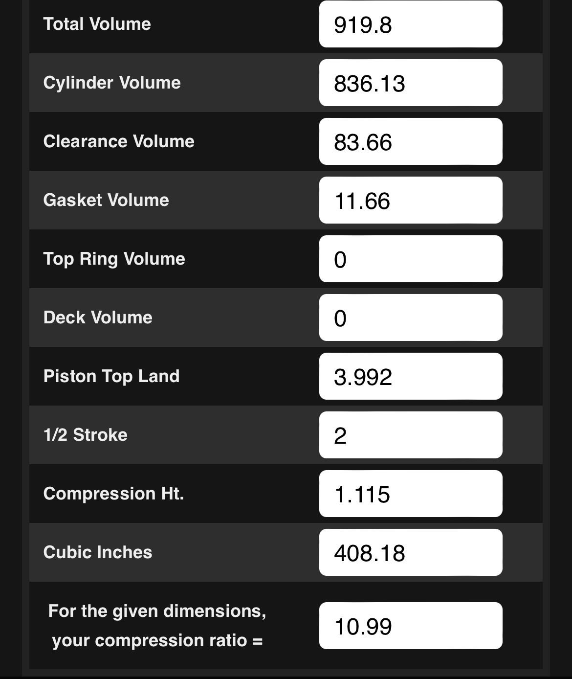

After doing some research I found they make -10cc flat top pistons. And with an LS9 gasket at .055” compressed thickness with 4.060 gasket bore. I’m seeing about 10.99:1 with the 62cc chambers. Is that about optimal? Since this is a road cruiser I plan to keep for a while and even have some track use, I wouldn’t be one of those guys with a 8,000+ rpm redline. 7,000-7,200 max for me. I still think with the setup above 520whp isn’t too bad. I just wasn’t sure if the 247cc head and a custom grind cam would make it to the 550whp. 1 7/8 headers and 3” duals.
You have helped me quite a bit! Thank you!

Thank you for correcting me on that, by using what you told me I managed to find a way to use the 62cc heads with a different set of pistons for a 10.99:1 compression ratio. If you have a suggestion for a different compression ratio on 93 octane pump gas, I’d love to know. I don’t want to lose power from not taking full use of the compression for the octane we have over here! (Unfortunately E85 isn’t very common)
Edit: I found a post by HCI2000SS, he has a 6.0 with a 615 lift, 236/242 duration, 112 LSA cam, very similar to mine, and he runs 11.5:1 with no issues on 93 octane. So I think I can up my compression to 11.5:1 and I’ll be ok. (Milling the heads to a 58cc chamber will get exactly 11.5:1 according to the Diamond Pistons Compression Ratio Calculator)

Have you bought any of these parts yet, or is this just the plan? 11.5:1 should be fine on 93, but I wouldn't go shaving new heads. That extra 0.5 point of compression should only be worth about 1% increase in hp (here's a quick calculator you can play with to get approx. hp changes with compression: Compression Ratio HP Determination Program (bgsoflex.com)) I'd rather leave it at 11:1 or grab a different piston to get the compression you want. Diamond is excellent, but there are TONS of great pistons available for LS strokers. My personal fav shelf piston right now is Mahle Powerpak pistons in a 2618, they have a -5.8cc flattop that might put you where you want for compression.
ls-6-0-flat-top-webpage.pdf (mahle.com)
You can also gain some compression by going to a standard LS2/LQ4 head gasket. No need for a LS9 if you're not going boosted. LS2 will have thinner compressed thickness and smaller bore.
