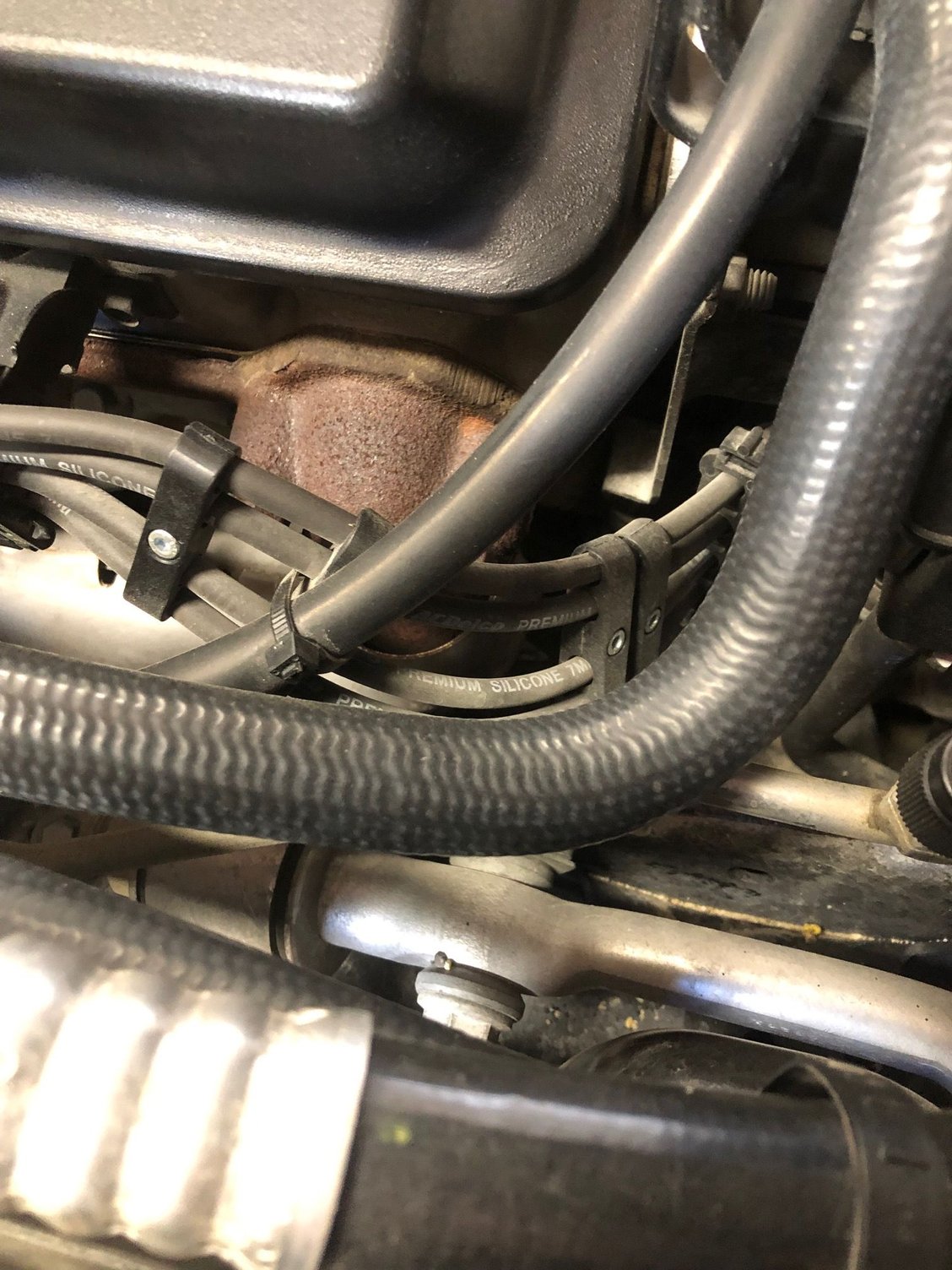

Not real easy to get good pictures as you know it is tight quarters. I use the connectors whenever I can. Dan EDIT: I really did not plan to have two four wire connectors right next to each other in the first picture. They are for 7 and 8mm wires. They can move over time on 7mm wires. They started out a couple inches apart.

Whaleman,
Thanks for the pics. That factory holder for #6 & 8 is where some of the arching is happening. Again though, it's hard to see even if the garage is pitch black.
