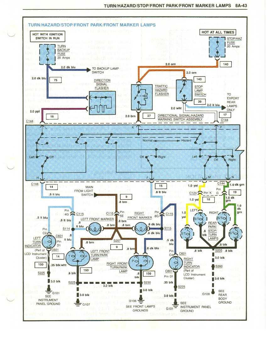

I was able to sort out everything!
When i put in the LED Electronic flasher, my side blinkers were alternating from the fronts like normal, i just didnt know if they were supposed too or not. Now for the indicator lights on the cluster for the blinkers being on with the headlights. I ended up putting in resistors on both sides of my blinkers. The LEDs don't pull enough power and so the car thinks the lights are out.
I just tied in the resistors into the blue wires for the blinker and grounded it. I can disconnect everything and make it go back to stock if I wanted to put the incandescent lights back in.

This is for the 1984 but from what you are saying it is probably very similar on the 1990.
With "MAIN LIGHT SWITCH" off ( Brown wire ) the "LEFT TURN INDACATOR", "LEFT FRONT MARKER" and "LEFT TURN LAMP" will flash in sync ( blue wire from relay ).
The "LEFT FRONT MARKER" will ground thru all lamps in the parking light group, including rear lights. On this picture you have the "LEFT FRONT PARK LAMP" as example on the brown wire.
With parking light on you have 12V on the brown wire and now "LEFT FRONT MARKER" seek ground on the blue wire thru "LEFT FRONT TURN LAMP" and "LEFT TURN INDICATOR" in the dash.
Whith turn signal on the "LEFT FRONT MARKER" will get 12V on both sides and this is the reson it is alternating with the front turning light.
By replacing the front "LEFT FRONT TURN LAMP" with LED a lot more current will go thru the dash indicator. A resistor to ground on the blue wire will fix this as you described.
You might also need a resistor on the brown wire to ground if the side indicators does not flash with parking lights off.
When the desigher of the electical system use other more powerful lamps as ground path in some functions you will get strange effects when converting to LED.
