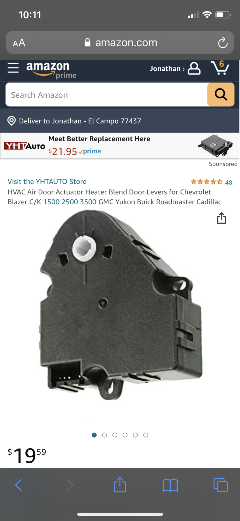

this thing is what your talkin about?

I recently saw that post and I’m really thinking this is the problem. I only get cold air even wit he it all the way 90 degrees. This blender door motor wears out they say so maybe the door from cold to hot is suck.. what do u think?
