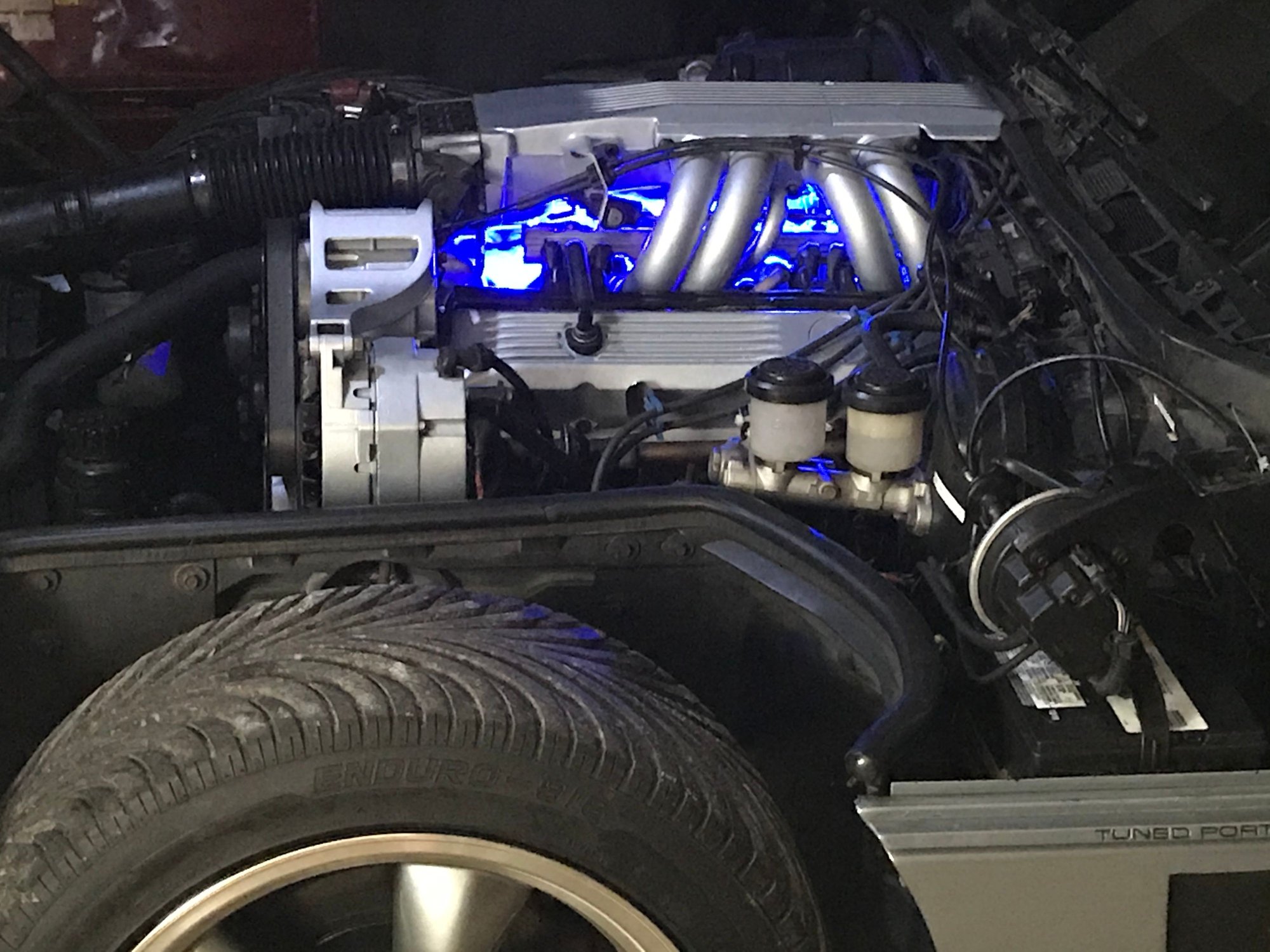

Two years ago, I painted the valve covers, entire intake, alternator and brackets all with Acrylic Enamel, the same color as the exterior of the car. Of course, everything got a good coat of primer/sealer and it shines nicely. In two summers of use, I have not had a single problem with the paint. It was an easy job that I did over a long weekend. The blue is a small strip of blue LED's that I put under the plenum. No other car I've seen has that, and it gets plenty of good comments at the shows!
I remember when u came on and showed that off. Personally i like it. Not sure the led strip would hold up on a weekend track car (melt?). I think its cool. Personally i think the TPI is the coolest looking intake manifold of all time. Im also partial to the LT5! But i think a CLEAN BRIGHT ALUMINUM TPI is an awesome intake.
