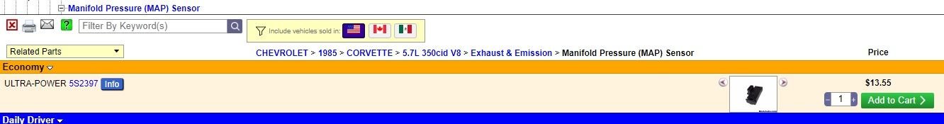

Does this car have one and where is it located? The FSM page 6E3-9 calls out a "Manifold air Temperature" sensor not a pressure sensor.

I dont think there is a MAP on an 85 but rockauto is calling out one for the car.

No MAP on an 85. Just a MAF or mass air flow. It's the part between the air filter and the intake. To change to a MAP you have to replace the ECM I believe but I'm not 100% certain.

I didnt think so but Rockauto wants me to have one I guess.
