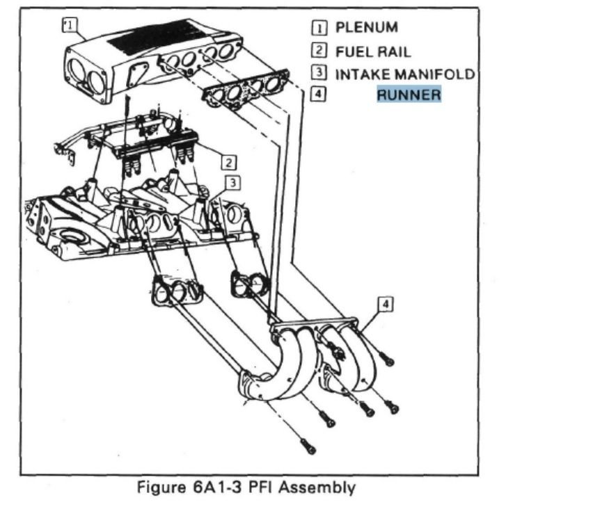

I am still looking for you, I have been all over the 86 FSM and see many images but they have yet to give torque / tightening sequence. still looking for runner to intake torque.
I found this image which should be the one to give torque / sequence but they failed to do so on it and the pages prior to and after it.

Come to think of it everything I have seen and read has the runners pre mounted before intsalling plenum. The removal process was always plenum off first so I would think plenum on last after tightening the runners.
