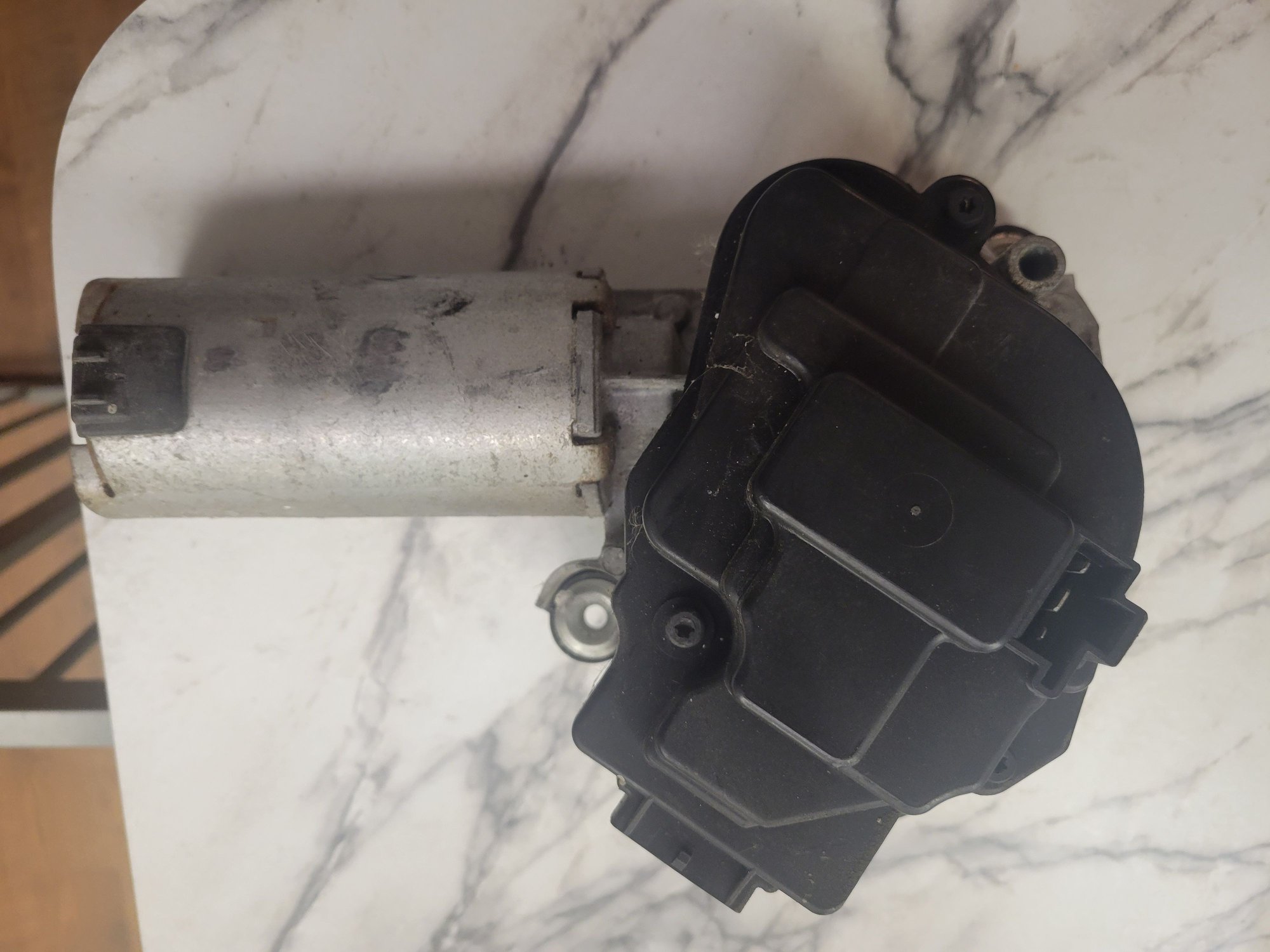

Is there a way i can bench test the wiper motor and are the covers available for sale?
Old Dec 22, 2022 | 06:51 PM
THE 383 admiral's Avatar
THE 383 admiral
Joined: Sep 2010
Posts: 2,422
Likes: 202

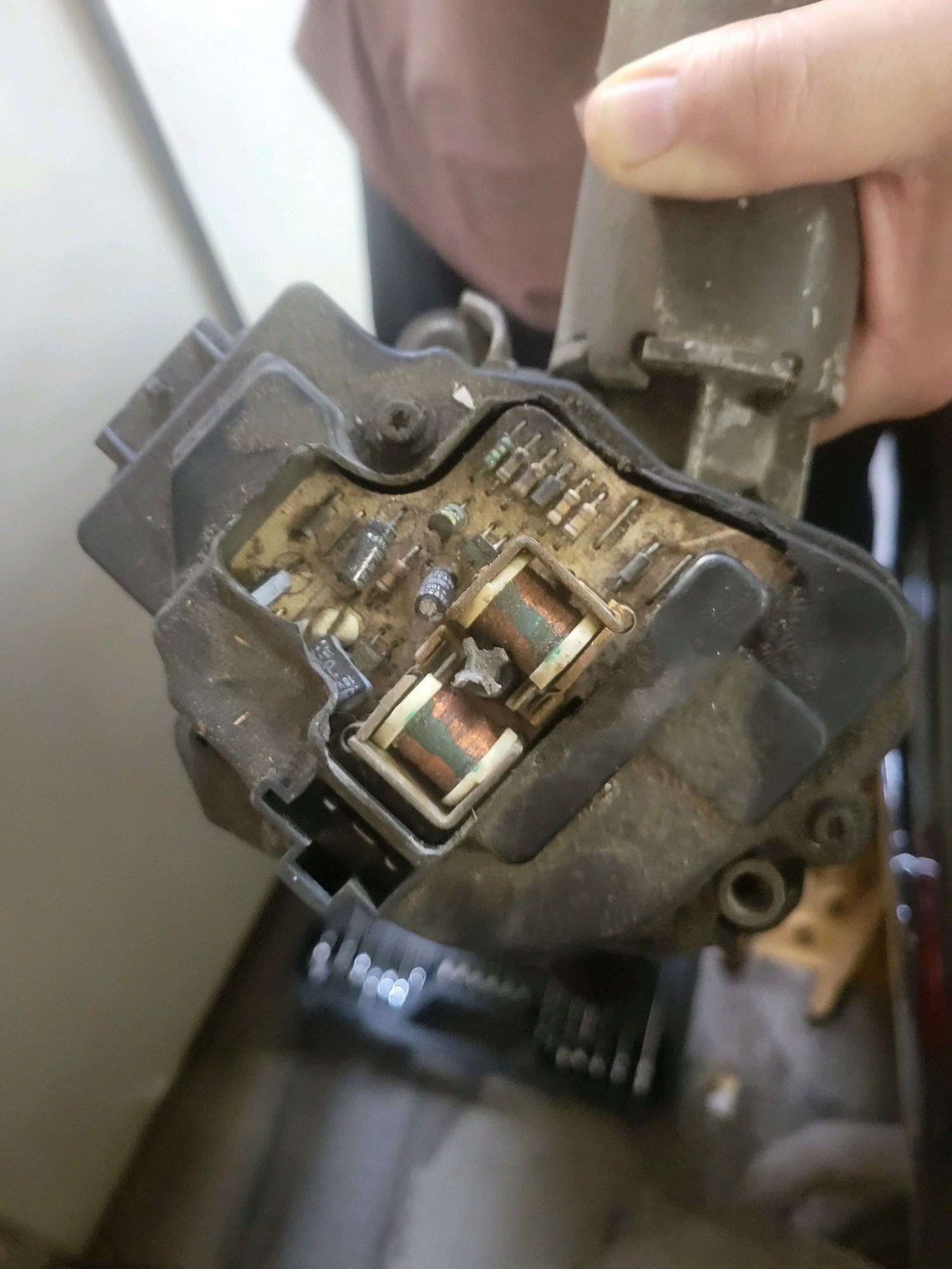

Face- value. Looks toasty, fried.
Simply put 12v on ground & positive 1 terminal low speed.
2nd high speed.
** A new cover/ module replacement.
Maybe, challenging.

The wiper motor is grounded by a wire to the conector on the cover. If you run a ground wire to the wiper motor, high and low will run without the cover.

I repaired the broken cover on mine with fiberglass. It worked well and it's still holding up. Mine looked a lot like yours.

I haven't been able to find a new replacement cover and module. I'm hoping someone starts making new ones soon.

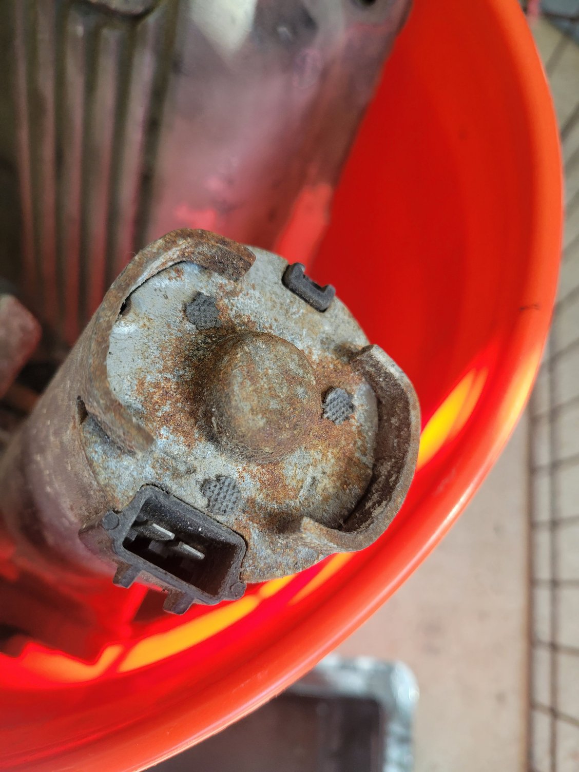

Does your old and this 'newer' one have matching # of terminal on the end frame? Early have 2 terminal and later have 3 terminals.
Old Dec 23, 2022 | 07:24 PM
johnfin's Avatar
johnfin
Joined: Jun 2012
Posts: 1,391
Likes: 73
Which set of connectors, there are 3 sets. Top of the cover plate, edge of unit and end of motor.
Old Dec 23, 2022 | 07:30 PM
WVZR-1's Avatar
WVZR-1
Joined: Sep 2003
Posts: 25,394
Likes: 2,741
The end frame 'cap' for the armature.
Old Dec 24, 2022 | 02:55 PM
johnfin's Avatar
johnfin
Joined: Jun 2012
Posts: 1,391
Likes: 73
Default part
I am in fat city, both have the 2 pin connector. I got my part off an 84', plentiful. Wish there were more 85's, only came across one so far, some 86's and 90s'.

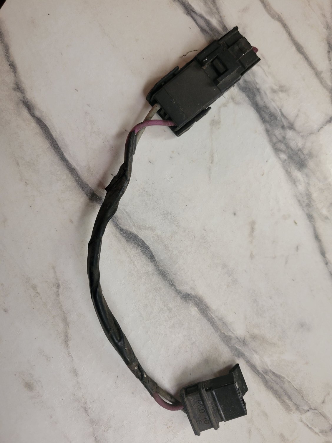

There's a very short harness/wire connected to that end of the motor. On your next trip you might want to snag it.
Old Dec 24, 2022 | 03:44 PM
johnfin's Avatar
johnfin
Joined: Jun 2012
Posts: 1,391
Likes: 73
You mean this one. LOL not my first rodeo. The real bummer was someone broke off one of the motor bolts on my car. I managed to use a mirco torch with visegrip and get it out.
As far as CAD, I know it well and was thinking about making those covers too but you really need to have a 3d scanner to get it right. I dont want to just draw a part, it needs to be exact.
I cant believe dormans does not make one, must be vette specific.
Old Dec 26, 2022 | 04:56 PM
Vets-Vet's Avatar
Vets-Vet
Joined: Jul 2022
Posts: 1,805
Likes: 365
From: Central Florida
The biggest problem are the transistor numbers. They are GM numbers stamped on motorola parts and there are no cross references for them. One of the Corvette parts dealers occaisionally orders a batch so someone knows the numbers, It's that I / we don't.
