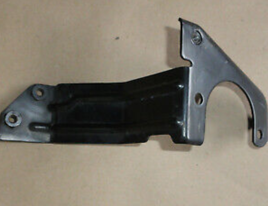

I assumed you were talking about this bracket maybe:
Typical ASR Bracketry:

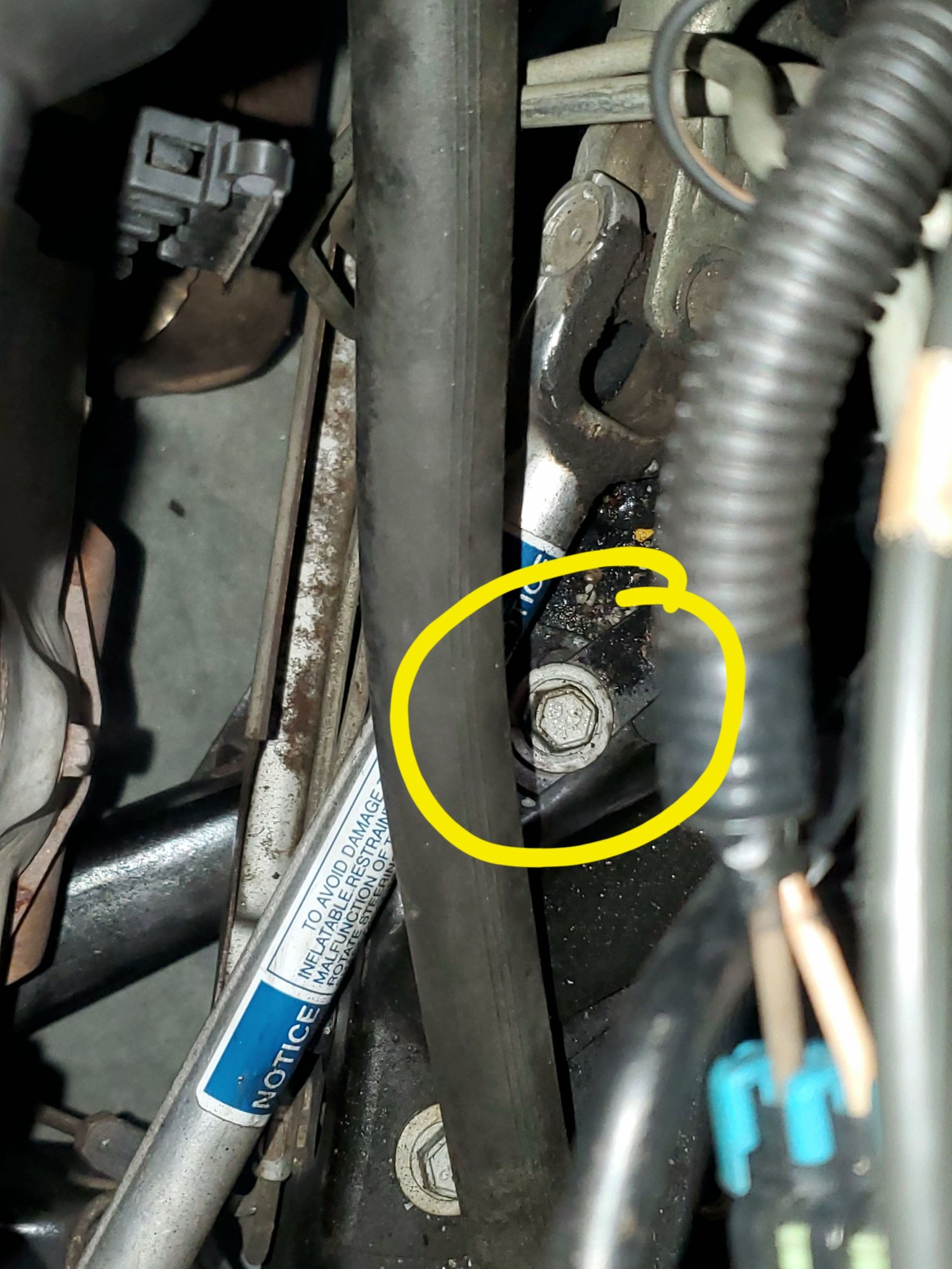

My issue is with the bolt #13. It's loose and can get it to tighten up or loosen up
That is I'm quite sure an M8 - 1.25 thread bolt. I'd look closely for maybe a J-nut of sorts or maybe it is a 'nut-sert'. To remove it I'd think you could insert something between the bracket and rail to maintain tension while loosening. Replace with something that suits you after removal. With tension applied it's very possible it might 'catch' and loosen/remove easily.

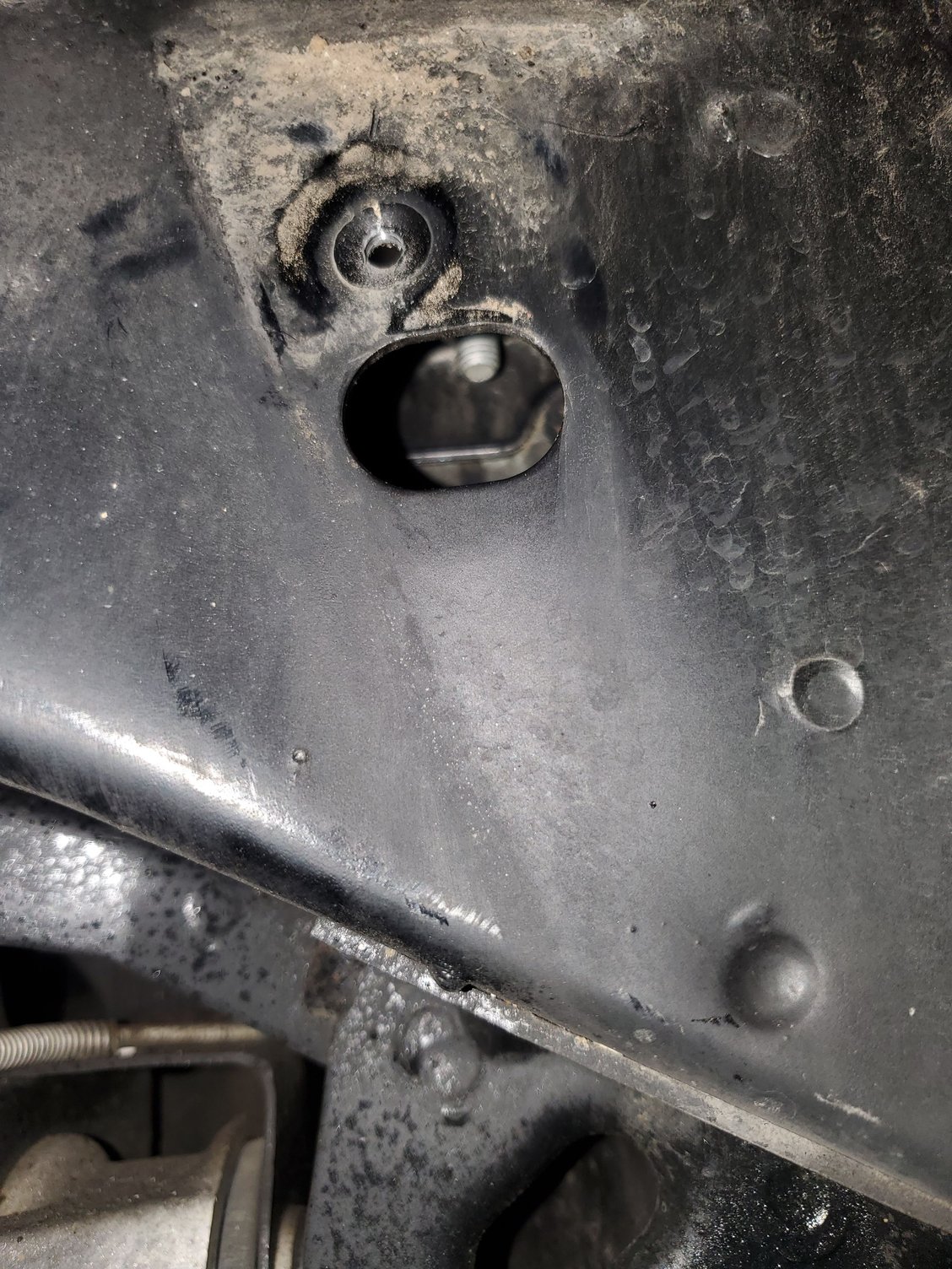

Team,
No dice. I removed the inner fender. No access to the nut or clip nut. There is no access from the bottom, or either side.
There is an access hole by the other bolt, but couldn't get a good picture of what's in there.
