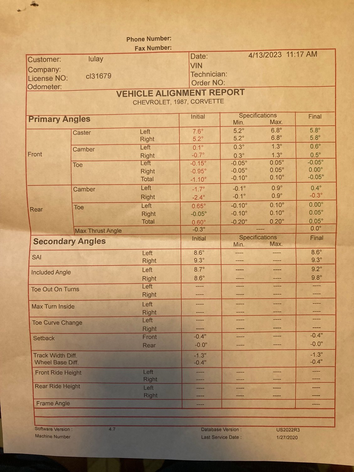

I finally got around to getting a 4 wheel alignment and wheels balanced. $280.00 does this look about right?

Looks like they adjusted everything. RR camber is not perfect though. Any time you see red in the final readings means it is out, but they did adjust it toward spec.
They had mentioned something about RR cam being wallered out too much to get closer. I need to replace that to get it to spec.

All looks good, given the constraints on that RR camber eccentric. I hate those things: stupid way to adjust alignment settings on a car, and GM is still doing it to this day (at least on the Alpha platform). Otherwise, they got it all within factory specs. My preference is to go for -.05 to -1.0 degree of camber both front and rear, even for a street alignment. It simply provides more grip that way. I would also max out the front caster available at whatever camber setting you choose (you usually have less caster available as you stray from 0.0 camber), again to improve grip with steering angle. A teeny amount of toe in, like you got, is ideal for most uses. That said, for a car that's going to be a street driver only (never exploring any limits), the factory alignment specs are just fine...nothing to be stressed about.

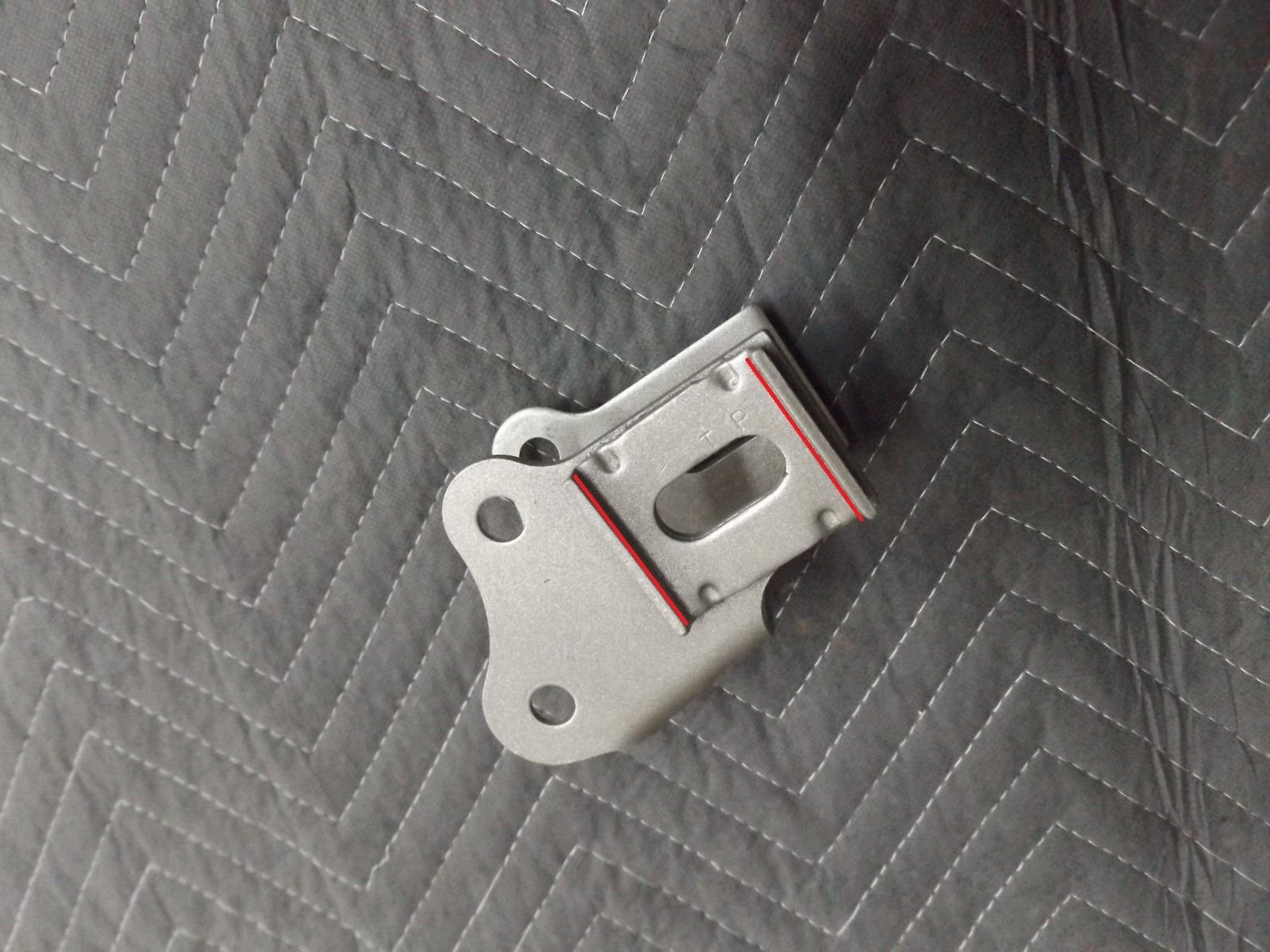

So, I got my four wheel alignment and was told that the RR cam was ‘wallered’ out too much to get closer than -0.3. All other specs look good. Post #14
Since then I have gone from OE 16” wheels and tires up to 17” and have also lowered the rear. I am going to get another alignment but before I do, I have several questions:
  1. What could my alignment guy have been referring to when he said ‘wallered’ out? The only parts used for adjusting rear camber is the spindle rod bracket, part # 14060165 and the rear strut rod camber bolt kit, and of course the wheel spindle rods themselves. Am I missing something here?
  2. The spindle rod bracket, part # 14060165, is the same for the right and left?
  3. Looking around, I have noticed that the rear strut rod camber bolt kit that everyone is selling comes with a spring lock washer. If I were to replace one of these, would I use that lock washer? The FSM or the GM parts book does not show a lock washer.
I had the whole rear-end out of this car replacing bushings and so forth earlier this year and I did not notice any wear on any of the parts I re-installed. I got the alignment and wheel balance immediately after I put the car back togeather.

And this bracket is the same for left and right, correct?

The vertical ridges that the eccentric pivots in.
Take him this image from an eBay offering and ask he show you?
https://www.ebay.com/itm/25419362067...Bk9SR9SLruuvYg
*** Is there an M14 Camber Bolt Set that might improve the fit.? There very well could be.
​​​​​​​So you are saying that the inside edges of these could have wear on them?
