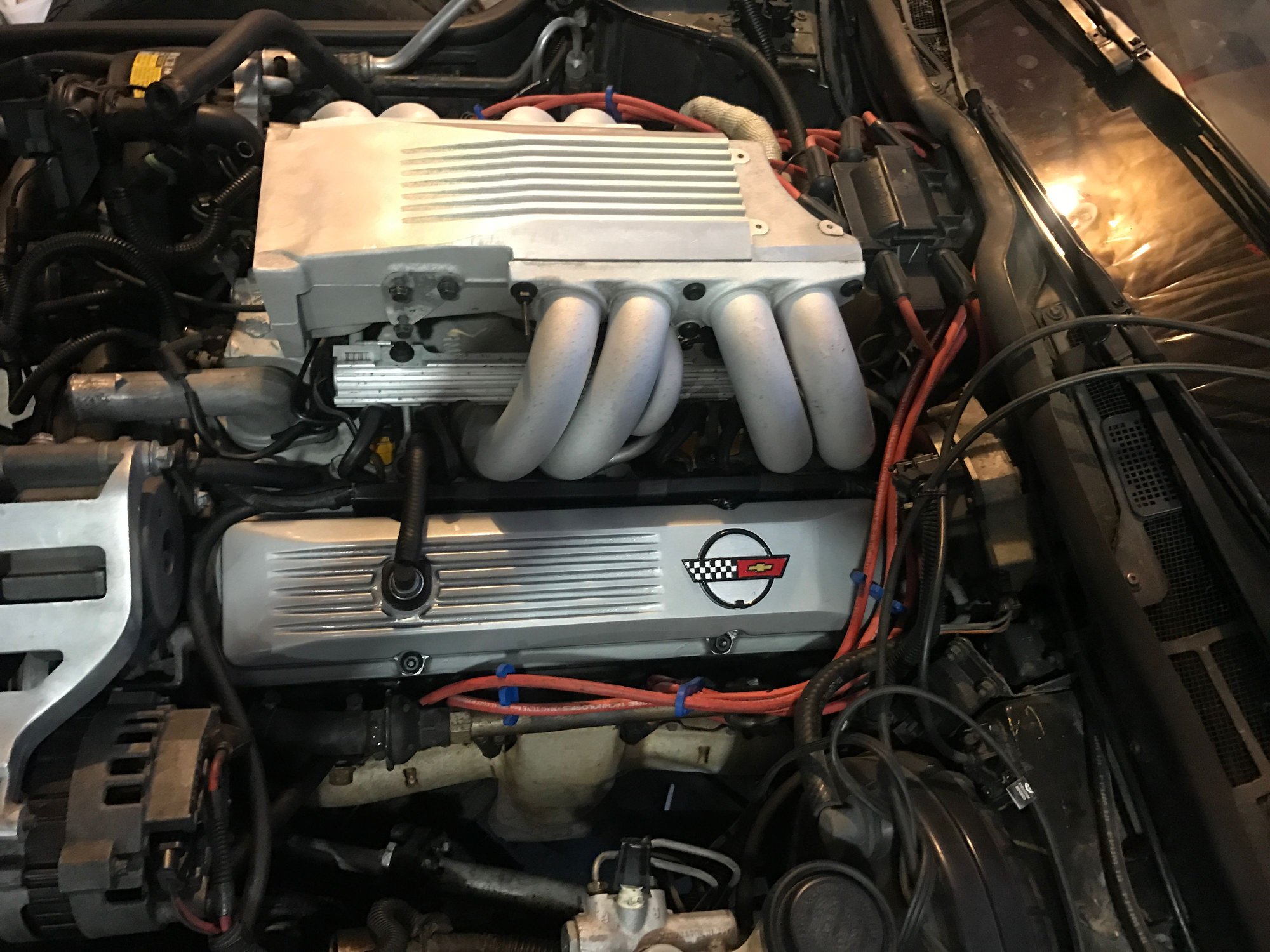

this was my 85 beside my 87. 85 had been cleaned. when i sold this car…..the guy opened the hood and he almost gasped. the thing is that its not painted. its factory. and as you know, most tpis today look like absolute *****. so when he opened the hood, he bought it. the restored valve covers help too.
i think this was my 86 partially through reassembly after getting its cleaning. enjoy the process.
