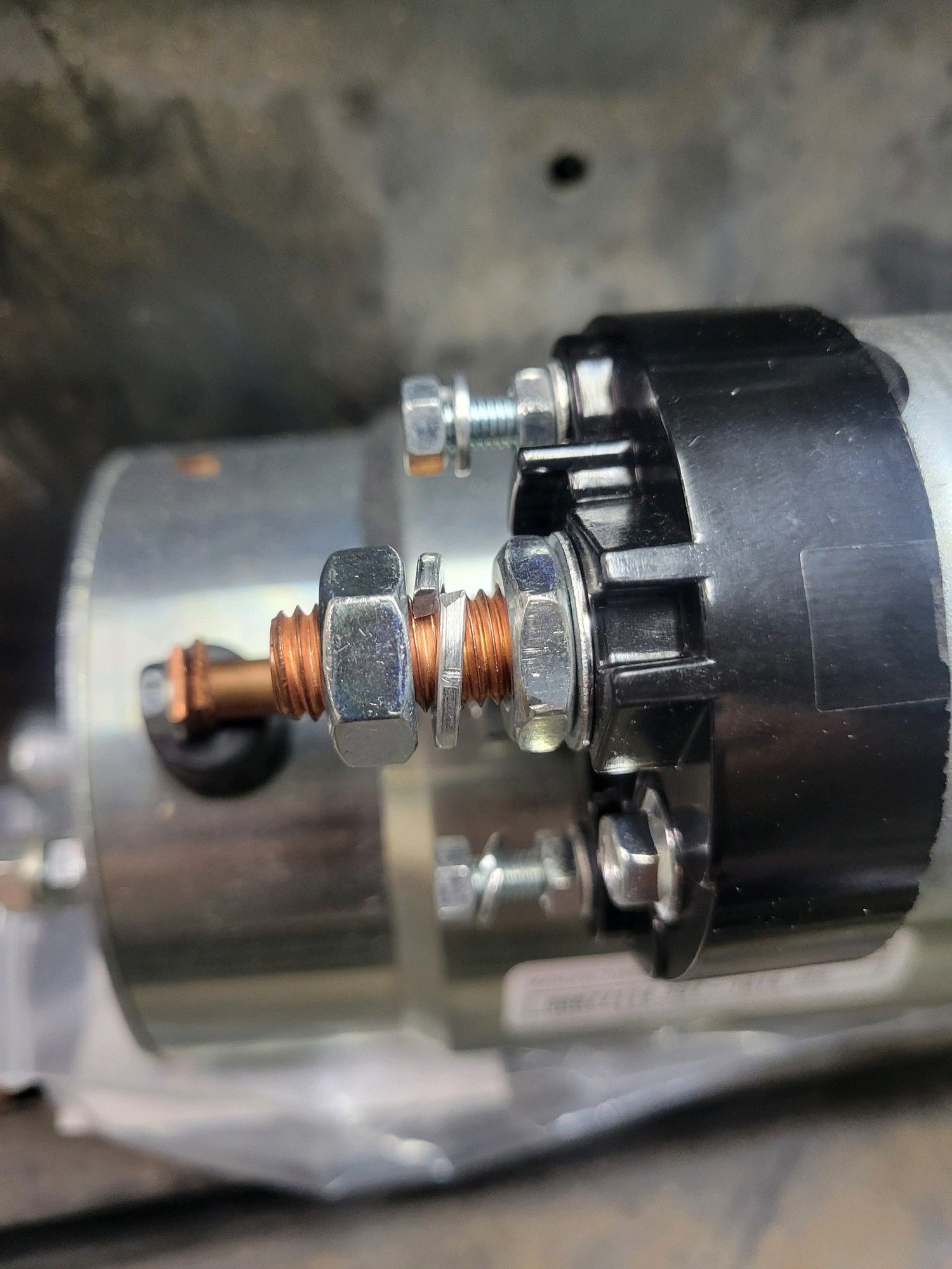

Why are there 2 small studs on the solenoid. When I jump start one I just put positive to the small one close to the engine in addition to the large + and -

One energizes the solenoid, the other is unused. It goes back to when cars had points and ballast resistors, and would send 12v to the points for easier cold starts.
