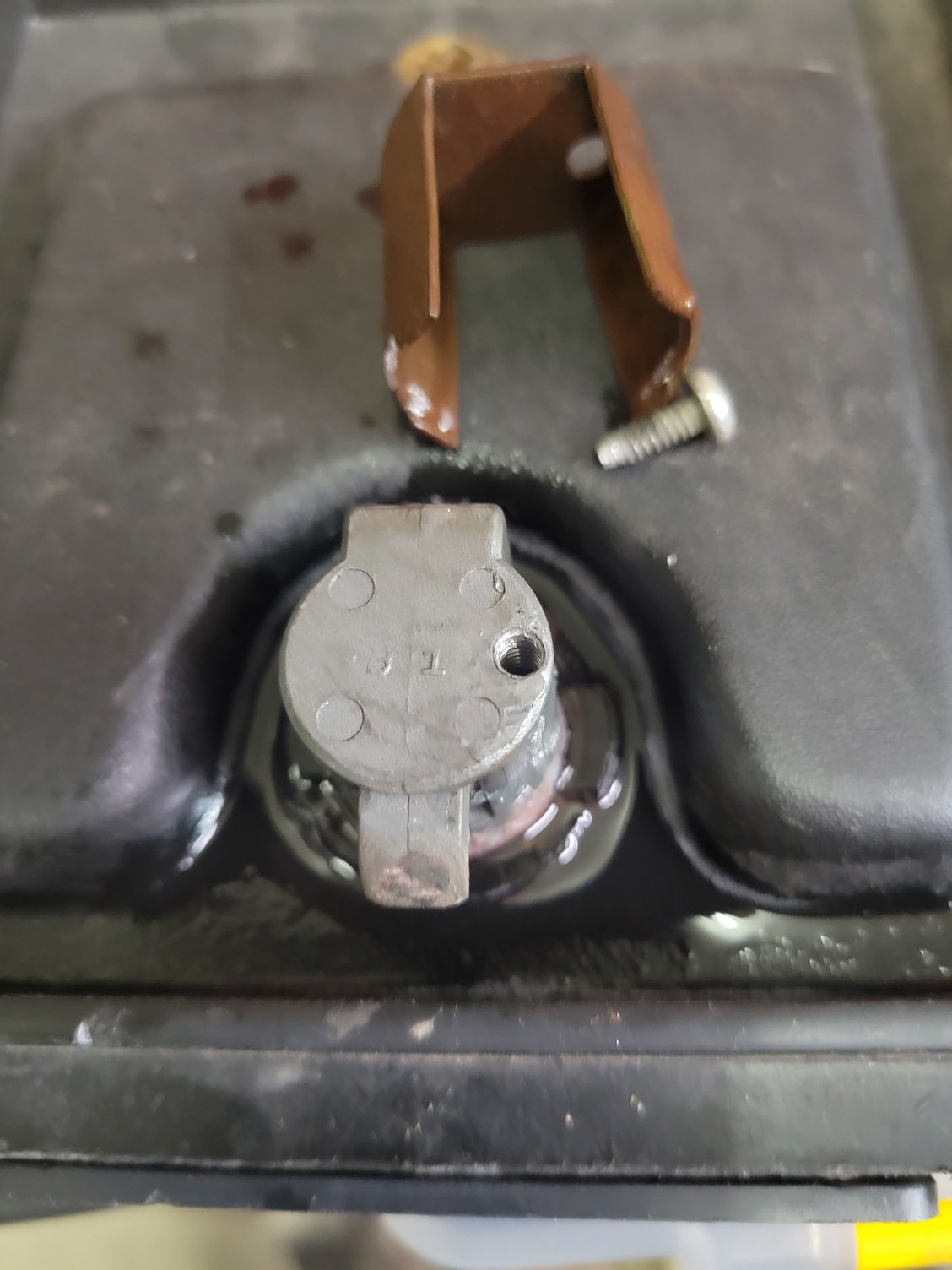

Anyone know how to remove the lock from the cubby door?

Once you have the clamp removed which is done in picture, getting the lock to unstick from years who knows what. It can be tricky to get it out of opening, but all you need to do is push the striker in and some times pushing the button at same time. Yours looks like it's been crazy glued in
