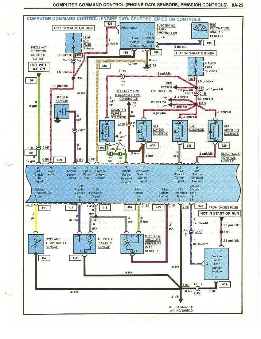

No it doesn't work that way, the ecm sends 5v to the sensor and reads what comes back. It can't do that with a one wire sensor. Here's a picture of an 82, same as my early 84.

I stand corrected. I found my old sensor.
The ECM does however measure resistance to signal ground. ( common ground for a few sensors.)

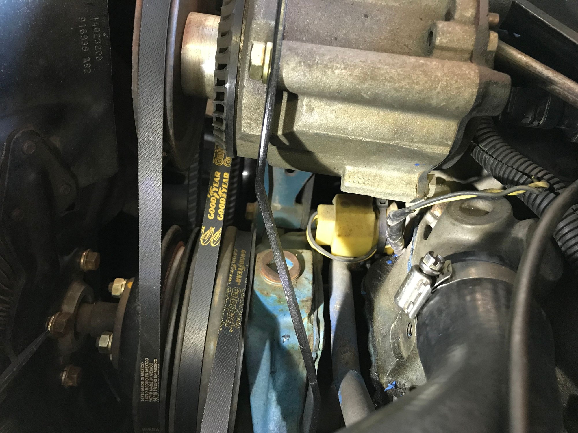

Thanks guys, this is helping me a lot. I located the temperature sensor which has a white plastic retainer of some sort and two wires, one black and one yellow. Looks like a bear to get to. How much fluid am I going to lose when I remove it? Also, what sensor should I replace it with? You mentioned replacing it with the upgraded sensor and connector. Do you have a brand for me?

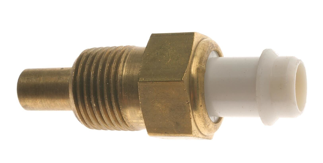

Standard Motor Products TX4 is sensor and connecter.

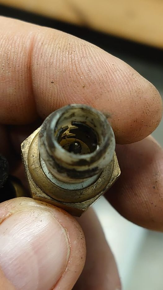

my sensor was corroded, cleaned up was all it needed on mine
