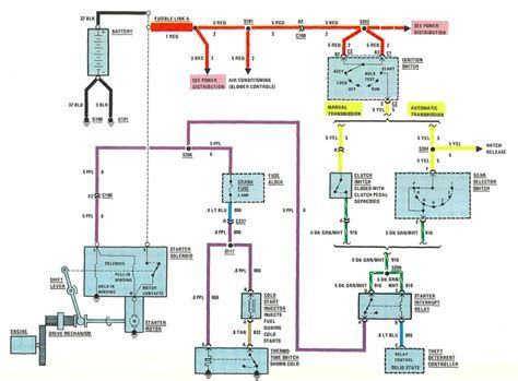

Old Jan 17, 2023 | 09:05 PM
s carter's Avatar
s carter
Joined: May 2014
Posts: 2,895
Likes: 592
From: New Port Richey FL
Give a look I think I found basic on previous post
Old Jan 17, 2023 | 09:09 PM
winnie9200's Avatar
winnie9200
Joined: Dec 2022
Posts: 19
Do you know if there is a higher resolution image? It's very difficult to read the text in that.
Old Jan 17, 2023 | 09:12 PM
s carter's Avatar
s carter
Joined: May 2014
Posts: 2,895
Likes: 592
Sorry it is I pulled from the web even went back to source and it was the best one others were cell phone photos of book
Old Jan 17, 2023 | 09:14 PM
winnie9200's Avatar
winnie9200
Joined: Dec 2022
Posts: 19
I see, thanks for the help, I'll go see if I can do some digging online or wait for someone else to maybe post a photo from the manual or something. Thanks again!
