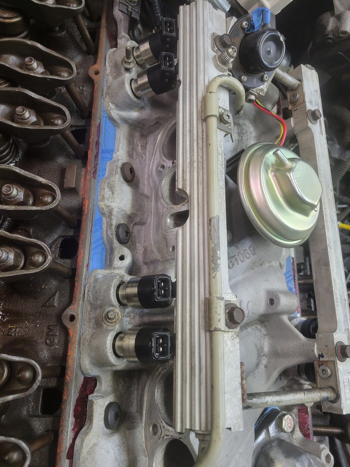

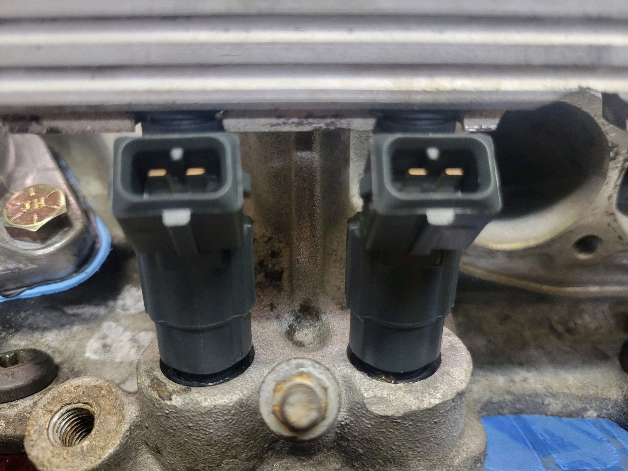

Whats the deal with the bosh 3 injectors not fitting. The instructions said they put a spacer in for the height difference but they are still loose on my 86. I can move them up and down 1/8". They are just too short.

I bought Bosch III's from FIC and installed them in my 86 last November. Mine sit pretty much the same as yours. Once I tightened down both fuel rails they didn't really move. My car runs great with no fuel leaks.

Put the clips in... also I may place a spare o-ring into each intake injector hole (reduces noise also)... a little bit of play is fine.

I did tighten the rail down. Did not come with clips, said that was for bosch 2. There is just too much play and its a fire hazzard. If i pull up on them, they snap into fuel rail but leaves the top oring in the manifold chamfer loose. Clips might keep them down but they wont snap into the rail then.

If the hat sits on the injector tip it wont work. One of the orings on the tip just sits in the chamfer in the intake manifold. Any height to that would push the injector out. The clips may hold them down but iam not sure of the sealing quality in the rail. An 1/8" is alot of travel.

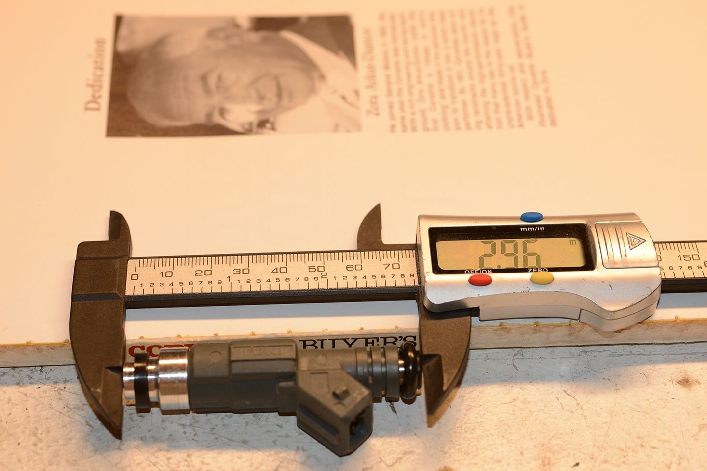

Can you compare the height of the Bosch III's with your old ones ??
The Corvette specific Bosch III pintle cap extensions for my 87 should be the one below AS FAR AS I KNOW, I am not a FI guru by any means.

Dont have Old ones, building the car from scratch. I have seen some originals in the junk yards and know they are much fatter.

Just went through this back in November with my 89, broke my *** all day replacing everything from fuel pump forward. ​​​​When I got to the install of the bosch III's, they were flopping in the rails loosely, so I quickly got on the horn with FIC before they closed to talk with their mechanical dept. They told me to double up on the O-rings, intake side, (using the old ones which I was leary with doing but they were in great shape) and to bolt down the rails and test for leaks before assembling the plenum and tubes. Nothing leaked to my surprise, assembled everything else and she fired up beautifully and has been running great since.

Lot's of ways to deal with the situation, as you don't seem to like most of the solutions offered, there's another way. Mill off about 0.060 from the injector stands.
The clips are easy to find though, I thought about NOT using them in the past but I didn't like the play either, and I recommend you use them, there's a groove in the injector housing for them and they do position the injector properly. Don't be so stubborn
