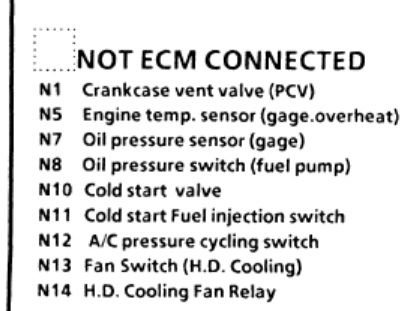

87 cold start valve is on drivers side between intake manifold runners for cyl's 3 & 5 on drivers side and the switch I believe is in front near coolant temp sensor. Have you checked fuel pressure ?
Any codes? How does is run once it is started? Do you have 2 seconds of fuel pump when key is turned to first position (Run) ?
