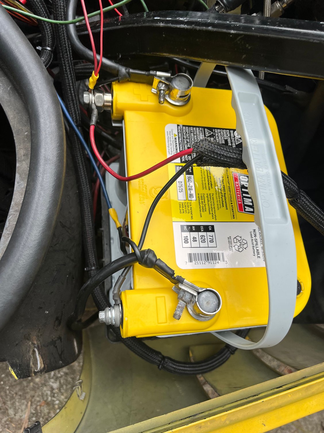

Old Feb 5, 2023 | 04:06 AM
Armybyrd21's Avatar
Armybyrd21
Joined: Oct 2021
Posts: 201
Likes: 31
Old Feb 5, 2023 | 08:55 AM
billschroeder5842's Avatar
billschroeder5842
Zen Vet Master Level VII
Posts: 5,218
Likes: 1,174
From: Southlake, TX
Thanks Army Byrd, I like the optima solution and you did a great job of modifications. However, I'm not nearly as creative as you and would need a more simple solution.
Anything approaching "plug and play" side a side, cable option?

Armybyrd21's Avatar
Armybyrd21
Joined: Oct 2021
Posts: 201
Likes: 31
It is plug and play-even used the factory battery hold down.
Old Feb 7, 2023 | 08:03 PM
Hawkeye56's Avatar
Hawkeye56
Joined: Mar 2019
Posts: 843
Likes: 149
From: Iowa
Originally Posted by Armybyrd21
May I ask what mods you did to get this battery to fit. I tried getting a Optima yellow top battery to fit my 95 but no luck.
Thanks
Hawkeye56
Old Feb 8, 2023 | 12:59 AM
Gale Banks 80''s Avatar
Gale Banks 80'
Joined: Nov 2008
Posts: 3,716
Likes: 551
From: Seattle Washington
The later C4s can not take a top Post Battery only a side Posts. Not sure what year my 90 can and my 96 can not. The Optima can be had in many configurations as can many other Batteries. They have our C4s well covered for plug and play.
