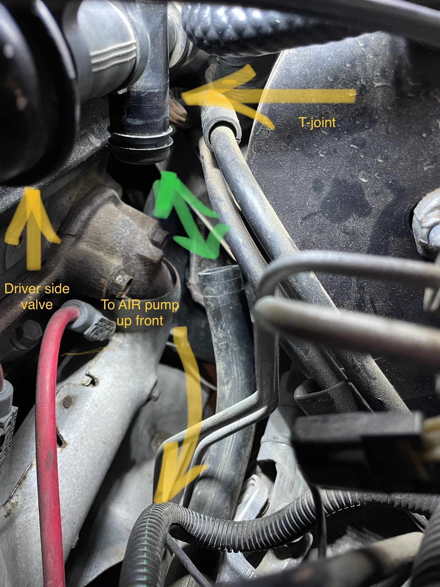

I’ve replaced the entire AIR injection system on my ‘96 LT1. After the PO ripped it out. Although, now I’ve come to a hurdle. There seems to be a hose that comes from the AIR pump up front. After that, I’m not sure if it’s connected to the T-joint, or something else. If anyone can share a photo of how their air injection hoses are set up, or guide me in the right direction, I would really appreciate it. I’ve looked at the SM, but it’s pretty vague. Thanks

Turned out that the "T" had an oversized nipple on it. Making it seem as if it didn't belong. A buddy checked out his '96, for conformation. So after replacing the T, the car runs so much smoother having the AIR injection back in.
