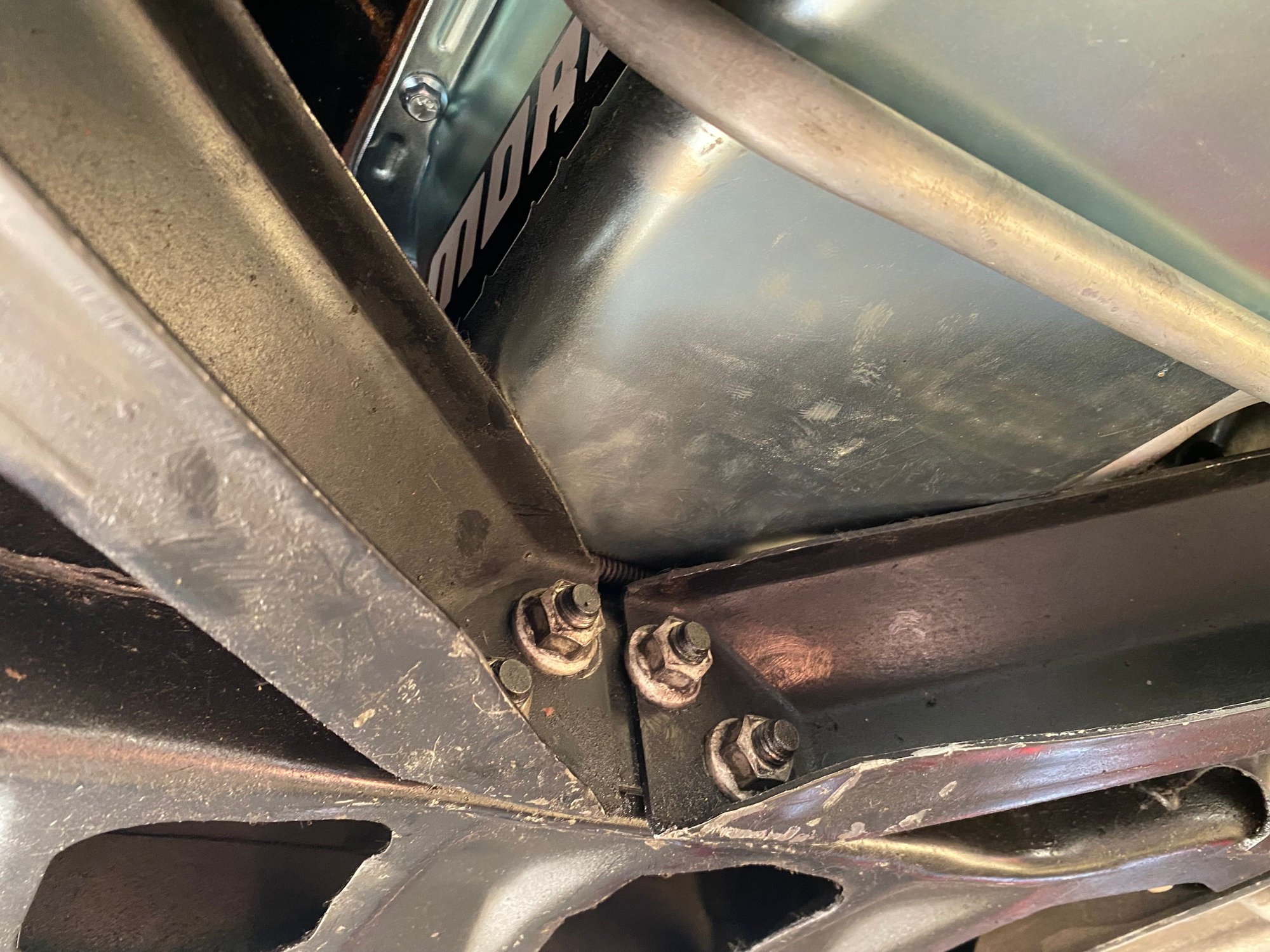

I have recently managed to install the new engine but the Morosso pan has a clearance issure with the frame. It sits right on top of the two frame braces bolted to the frame that are mounted at about 45 degrees and they are virtually flush with the oil pan. This is probably caused by the fact the new oil pan is taller. I also have new engine mounts, I don't know, maybe they have something to do with it.
Did anyone go through this problem?
