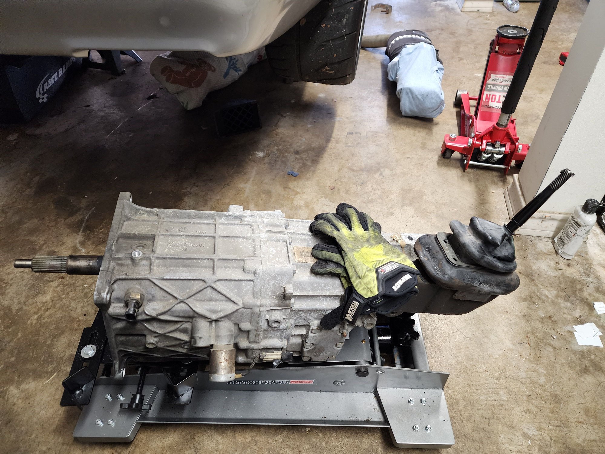

My dad and I got the trans out.

Sending it to Bill B. After driving my friends very low mile zr-1 and 96 lt4 cars(yes, he has a few) I know see how a properly zf6 should feel. And yes, my hydraulics were fine and bled.
