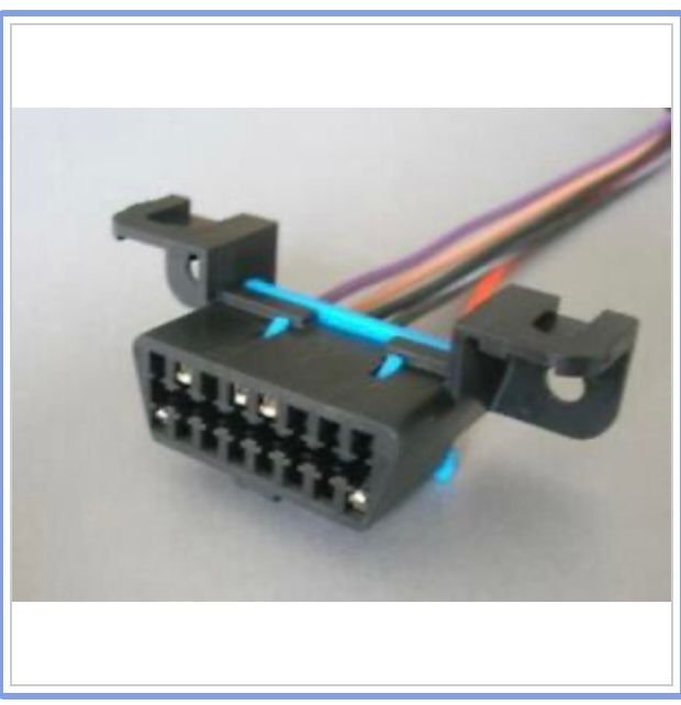

It’s the access point for reading the “codes” stored in the cars computer, it’s located in the drivers side footwell just above the brake pedal. It’ll be attached to the carpet ABOVE your feet unless it’s been pulled loose previously. Go to YouTube and look for “ 90-95 C4 Corvette paper clip code reading” …or you can go to just about any of the major parts houses ( Auto Zone, O’Reillys ) and they’ll use a scan tool and you can see the codes.
the plug in or access point will look similar to this
later, Tiny
