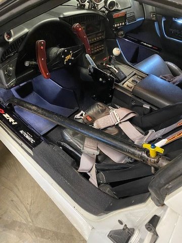

Default Roll Bar
This kit is from Auto Power, the main hoop fits pretty good, but it is very close to the halo trim. It is not finished yet, I was unable to work on it for a couple years, hopefully it will be in this summer.
One thing that has not been mentioned is how the a Roll Bar gets right in the way of your vision through the rear view Mirror. I'm assuming in the picture nothing has been welded yet I would think that flipping the Hoop the other way would be less intrusive. I like to check to see who is sitting on the on ramps when driving the freeways of Washington State. I got to know some of our States finest Highway Patrol in my youth.
He does have it “mocked” up incorrectly. The purpose of the diagonal bar is to keep it from collapsing in a rollover. So currently he is protecting the passenger instead of the driver. Hopefully he hasn’t started welding. Based on how small the cuts are in the fiberglass it doesn’t look like he was seriously involved.
But I will say all diagonal bars are going to obscure visibility.
