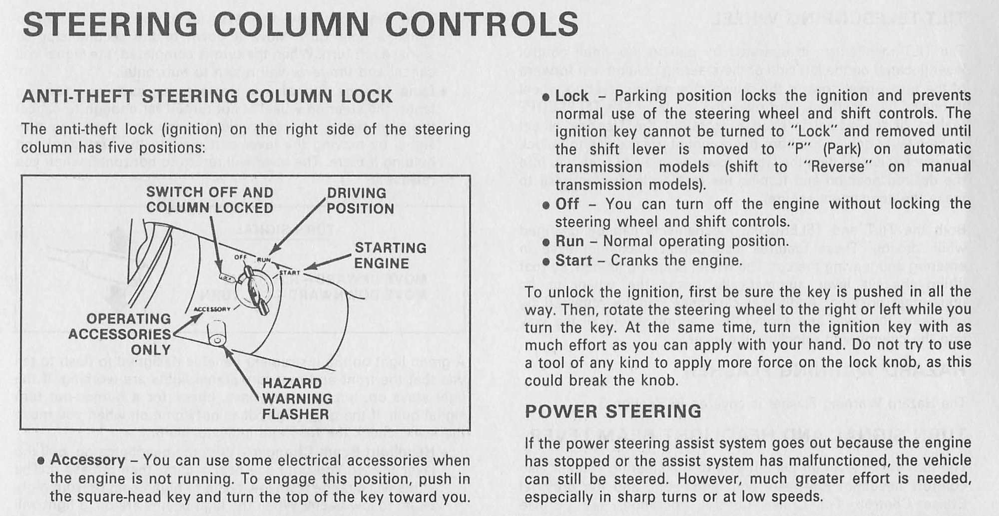

Hello everyone. First: is there an accessory position in the ignition switch?

Question 1 Yes instead of rotating clockwise from incert key position rotate counter clockwise, it sometimes takes a bit of jiggling.

I seem to recall depressing slightly mentioned for typical GM

As far as the accessory side is concerned, I have tried this. I did not want to force thinking it just didn't have it! BUT now that I know it does, I will try again.

Push the lock cylinder in to go to accessory.
