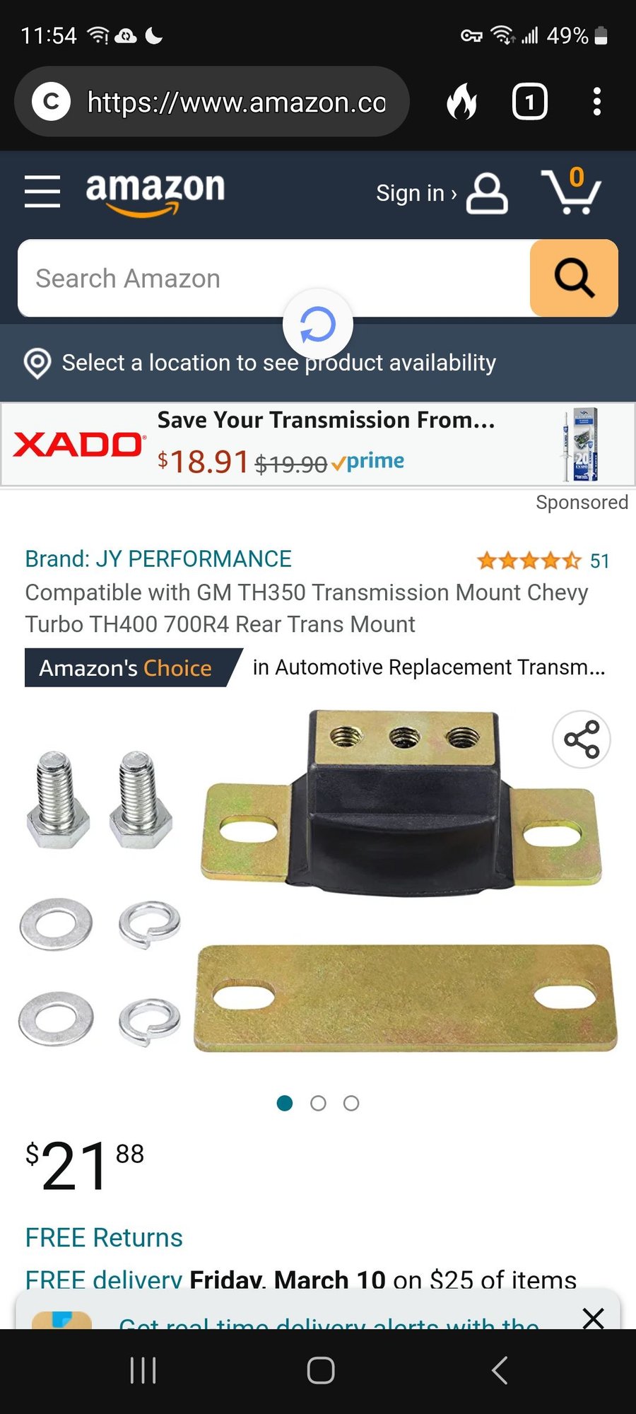

Old Mar 5, 2023 | 12:58 AM
MarkB85vette's Avatar
MarkB85vette
Joined: Dec 2019
Posts: 167
Likes: 10
From: Corpus Christi Texas
I have attached a photo of what fits the 700R4 transmission. Maybe I have the wrong name for the transmission,
This is what I have
To New motor mounts

Originally Posted by 383vett
You do have a C4 right?
It’s like you’re reading my mind!
Old Mar 5, 2023 | 07:59 AM
Ray Quayle's Avatar
Ray Quayle
- 1986 Original Owner -
Joined: Apr 1999
Posts: 3,193
Likes: 139
From: North Yorkshire, England
Cruise-In I Veteran
Cruise-In II Veteran
Cruise-In III Veteran
Cruise-In IV Veteran
Cruise-In VII Veteran
This is what I have
It would be far more useful to see a picture of the trans in the car. There is a bushing in the exhaust hanger that is bolted to the trans?
Old Mar 5, 2023 | 08:45 AM
MarkB85vette
Joined: Dec 2019
Posts: 167
Likes: 10
correct, that is what I am discussing here. I may have time soon to dig into this later today. But based on what I see on the car and where I want to go, this item is an upgrade to urethane. When I do, I will photo what I see and the condition of the motor mounts as well. Uploading them
here for analysis. More to follow. Thanks for the support
